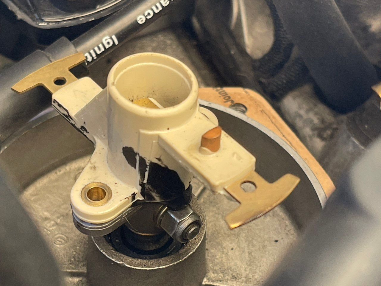

Anyway, while im waiting new amplifier, i want to check all ignition components
cap is new
Rotor looks good, but have black silicon at base.
Does it look like a modification explained in the book that was done by someone prior to me?

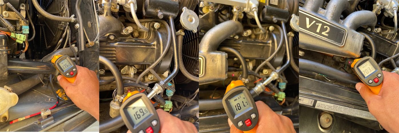

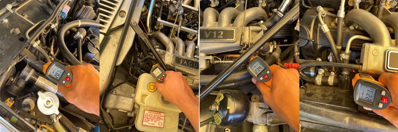

Okey, so replaced the broken coil, new fuel filter, new CTS, tried to add coolant as much as i can with left corner raised. for now no acceleration problem!!
So, test drive - 20 mins, small village drive, no traffic, no high speed, a lot of turns. first 15 mins all good, temp gauge goes a bit to right part of N letter and then back to middle N. Like that back and forth, then after 15 mins, it started to slowly slowly goes higher and higher, accelerations didnt really do much to it, while i get back to the garage it was like that and it stayed there for another 10 mins of idling and only then started to go a hair down, but still was above N when i switched off the car.
Please see reading at this temp
B bank
A Bank
Please note my e-fan connected to rear A bank housing (in the place of hot air vacuum switch??)
Bot efans jumps in right in the high point of N and while driving they never went off.

That is good; a small difference at idle is of no consequence. As long as it behaved above idle, your catalyst system is probably ok.
I wonder if your gauge sender location (I think you said you relocated it to the rear of the rail?) may be influencing the readings. You could try wiring your main e-fan to be on with ignition and put the gauge sender back to the OE location and see what happens.
My ‘88 V12 with 110K, original radiator, mechanical fan (black fan and new clutch) never fluctuates much, always on the bottom of “N”, unless prolonged idle in high ambient temperatures, where it might get to the upper “N”. Maybe the back of the water rail fluctuates more….
