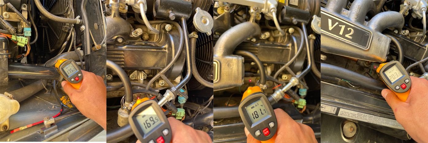

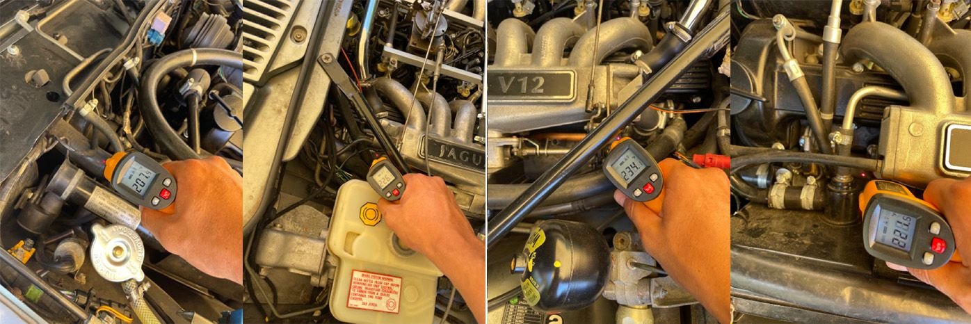

chasing overheating for 1 year, car looses power
That is good; a small difference at idle is of no consequence. As long as it behaved above idle, your catalyst system is probably ok.
I wonder if your gauge sender location (I think you said you relocated it to the rear of the rail?) may be influencing the readings. You could try wiring your main e-fan to be on with ignition and put the gauge sender back to the OE location and see what happens.
My ‘88 V12 with 110K, original radiator, mechanical fan (black fan and new clutch) never fluctuates much, always on the bottom of “N”, unless prolonged idle in high ambient temperatures, where it might get to the upper “N”. Maybe the back of the water rail fluctuates more….
no no, i did put efan thermoswitch at the back of the a bank rail, not gauge sender.
But now main question - are my temp readings that i posted above correspond to gauge value? in other words, is it overheating or not? mb its gauge sender or gauge itself is faulty and temps are actually ok?

Got it, but are thise k thermocouple probes with threads to screw in? i never seen such, usually they are just probs.
im really tired of dealing with this, where i cant even be sure if its overheating or not.
my infra thermo gun getting higher than 220 only behind thermostats and at the rear housings, not sure if thats normal or not
here, even if my infra red thermometer is off by 10 degrees, its still not that hot.
Also when you do infra red from the back of water rail, i have to keep thermo gun higher and probably its outside of its working range and its getting exhaust manifold temp as well.

Looking at your top rad hose reading I see 175 and 207, I don't like that imbalance. When I have measured mine they were within a few degrees. To me that says thermostats or radiator.
