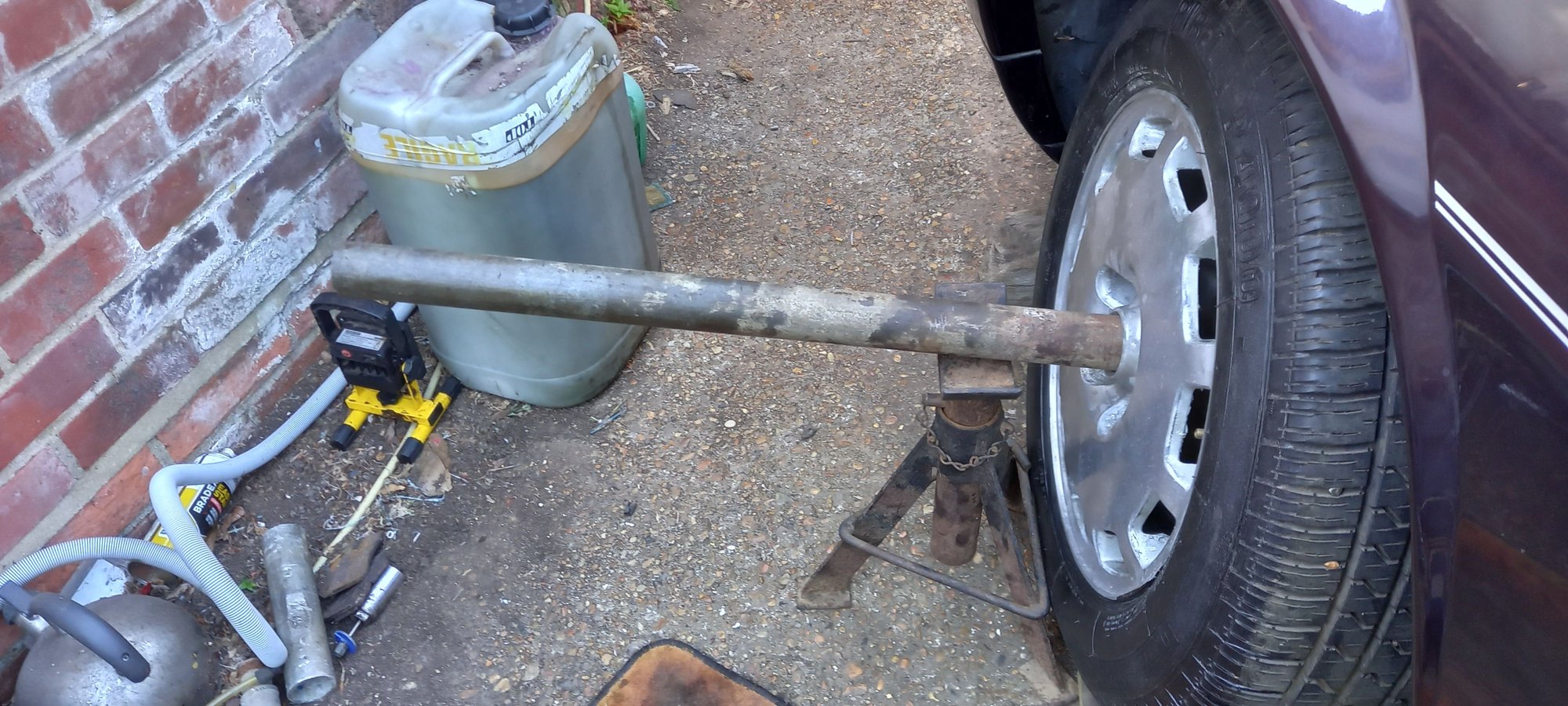

The Rear Brakes seemed to be binding, where the Tyres were starting to cut grooves in the Lawn at 'Orange Blossom Towers' that could have been caused by Stuck Calipers, Stuck Brake Pads, or even Sticking Handbrake Shoes, that are inside the Rotors, that some people seem to be unaware of
And so there was only one thing to do and that was to take the Rear Wheels off and then refurbish the lot, where while taking off those rear Wheels was dead easy, they were so heavy for me to lift up the once I had completed this Job and renewed all the Components
Putting those Wheels back on the Car was a Nightmare, not only because they were Heavy but also because you had to get them lined up with the Studs to get them back on but as I'm not built like 'Arnie' I thought that I would try and make some sort of a Gadget to assist me
Where although the first one seemed to work, it also seemed to be too complicated and so with so many things to go wrong, I thought that I would try and Simplify it by eliminating everything that wasn't really needed
And this was so Successful, that all I ended up with was a Two Foot Piece of Pipe! aka a Two Foot length of 50mm Standard Scaffolding Pole,that you can also find in Aluminum to save weight in the Boot/Trunk if you want to keep it with you, in case you need to change a Wheel by the Side of the Road
'Drum Roll' All I needed was a Two Foot Length of Standard 50mm Scaffolding Pole and an Axle Stand and that was that!
Where at this point even I was feeling disappointed, as this took 'KISS' (keep it simple stupid) to a whole new different sort of level
Where to make matters worse if they could get worse, if you haven't got an Axle Stand, then you could always use some Blocks of Wood!
The only good news being that the results were so Spectacular that I started to wonder why I had never though of this before, as it doesn't just work on an XJS but also on lots of other Cars, that include my Merc where lining up the holes for the Studs on that can drive you Crazy!
So before you Watch the Video, I spun the Wheel Round on the Pole so you could see I wasn't Cheating by having the Holes lined up!
Once the Wheel was back on the Car, then it was time to put the Wheel Nuts back on, and already had one Started by Hand to Stop the Wheel falling off!

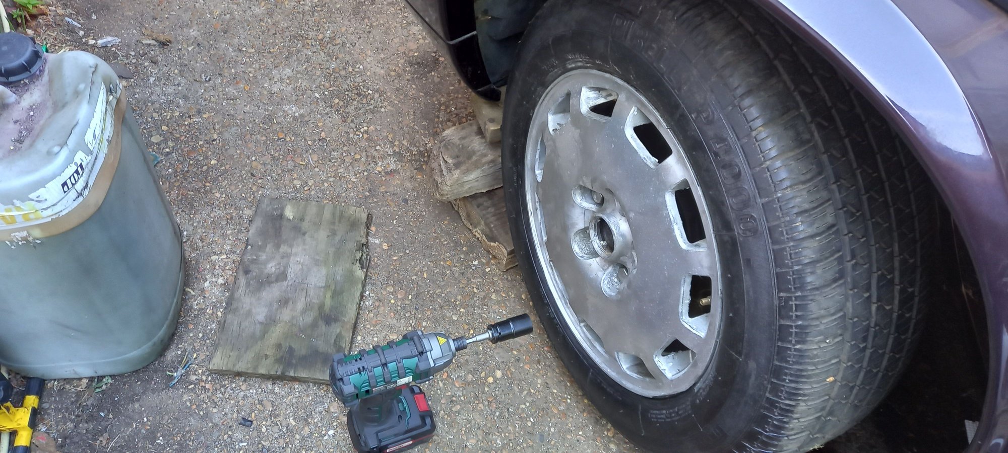

At first I was very convinced the back end was the problem! as I was thinking Stuck Calipers as well as Handbrake Shoes, though as it turned out, it was none of those things, as everything on the back end was working as it should and was ok
Although my OCDness didn't manage to stop me pulling it all to pieces to make sure
And so how come was my Car making all those gouge marks on the Lawn? or do I mean 'Swathe'?
As when I went to Frinton 'Swathe' is the term that many people use, as its very, very, kinda nice down there! in fact so nice that when there was talk of someone opening up a 'Fish and Chip Shop' People were getting the Vapors and it made Front Page News in all the Papers (Absolutely True!)
But 'Orange Blossom Towers' has got a 'Lawn'
Not just a 'Lawn' but a 'Lawn' with Skid Marks over it!
So it didn't appear that this was caused by the 'Back End' after all and so those Heavy Rear Wheels had to go back on! except they were so heavy that I couldn't pick them up, as confirmed by those 'Match Stick' Arms that you see in that Video

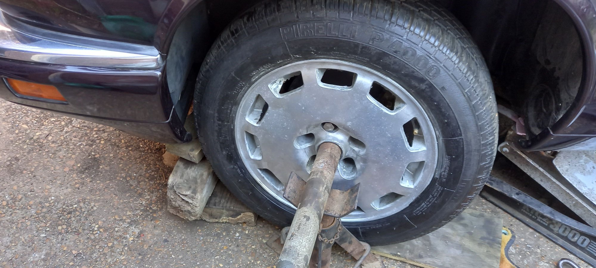

Where unable to leave the Car like that, I came up with Lifting Device Mk1V which was a Two Foot Length of Scaffolding Pole and just in case you're wondering what happened to the MK111 and even if you're not!
The MK111 was made from a Two Foot Length of very rusty looking Pipe that I found down the Garden, in amongst all that Junk, that would have looked so out of place on this 'Swankmobile' that being Superstitious, I thought bad things might happen, if I brought it anywhere near!
Where as you can see the MK1V worked like a 'Charm' and so the only thing left now, was to do the Front End, as if you've been paying attention (Lol) then that was the Start of the 'Nightmare' that I was referring to and was either going to be Stuck Calipers, or Stuck Brake Pads or maybe even Both!
So Starting really early before it got too hot to Work, I started pulling everything apart and freeing things off
Including of course those very Heavy Front Wheels! or should I say Wheel, as I've still got the other side to do
Except before I do that, I've got to put that Heavy Wheel back on, as my other Trolley Jack, is being used to Prop Up my other XJS I'm Working on!
Never a dull moment down at 'Orange Blossom Towers!' although at least it keeps my Neighbors entertained!
Where they keep mistaking Lightning in the Middle of the Night, with me in my Garage with my Welding Set

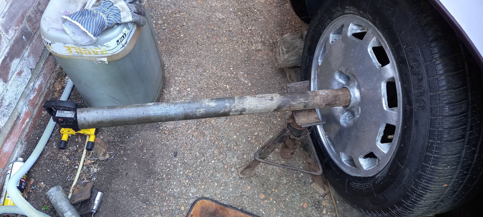

And so I hear you asking! how do I put those Heavy Front Wheels On?
'Oh Ye Of Little Faith!'
This is going to require some imagineering on your part, although the Photos should help to explain it, in the kind of way I never could
(1) Turn the Hub till one of the Studs is at 12o/c
(2) Line the wheel up (while still on the ground) so that one of the Holes in that Wheel is also at 12o/c
I really hope you are following this! as I could be asking questions later!
(3) This time move the Axle Stand (or else block of wood) as close to the Wheel as you can
(4) Put the Pole in the Hole as before although not so far in this time
(5) Then using the Axle Stand as some kind of a 'Make Shift' Fulcrum (or whatever it's called) use the Pole as a Lever this time to lift the Wheel up, while at the same time keeping the Pole as Close to the Grease Cap on the Front Hub as you can
(6) Then when you can see the Grease Cap through the Center of the Wheel, using your knee at the base of the Tyre, with your other hand up at the Top
you then push the Wheel straight on to the Hub where if you get lucky and you've lined it up right, it will go straight on to the Stud the very first time
Though if you are a little bit out, with about an inch of the Hub poking into the Wheel (as the Studs may prevent it being pushed on further) a little revolve of the Wheel to the Left or else to the Right, should be enough to see the Wheel pushed home
Which you can then loosely secure with a Wheel Nut by hand, to hold it in place while you then put the other nuts on, to do up with your Impact Driver and then once having done so Torque them down
Except I didn't do that, as I wanted a little Test Drive over the Lawn first, just to make sure that my Car was not leaving any Gouge Marks as it had done before, then in the event that all is ok, then I'll tighten them up and Torque them down
Even at that Crazy Angle, I easily got a Wheel Nut on just enough to hold it in position, until I got them all on finger tight
This time using my Lower Powered Impact Driver (Yes I've got Two!) If you've got it flaunt it!
I just nipped them up enough for a Test Drive over the Lawn, just in case I haven't solved the problem and they have to come off again!

- Turn the wheel around on the tube to line up all the other studs to the holes. This is the only time where you need any physical effort, but not much, as you're just pivoting the weight of the wheel on the tube
- Slide it the few inches onto the studs
- Loosely fit the 4 exposed wheel nuts
- Remove the tube and loosely fit the 5th wheelnut
- Gently tighten the wheelnuts, doing every 2nd one (the correct way to tighten a 5-stud wheel)
- Lower car to ground
- Torque nuts doing every 2nd one.
