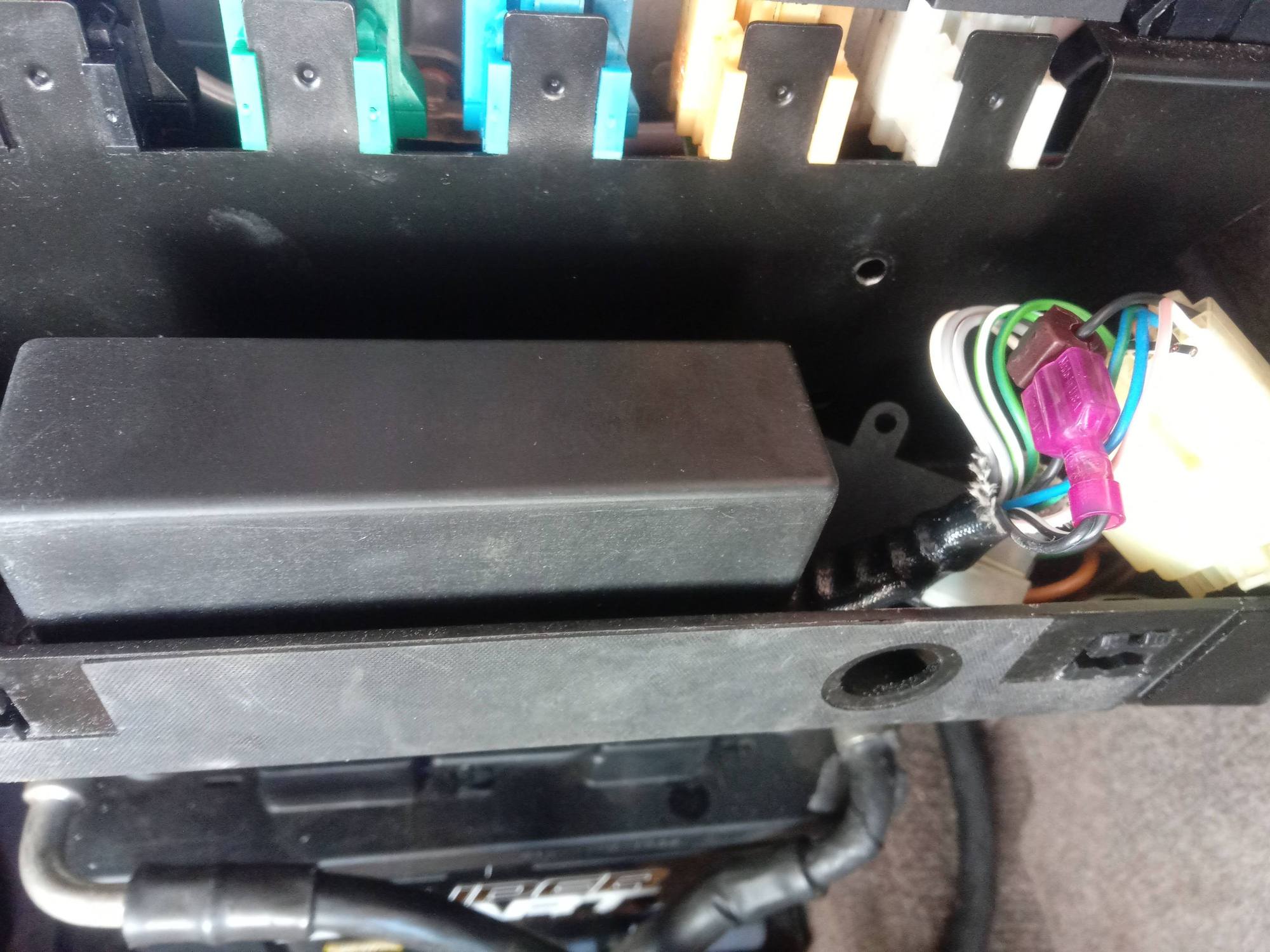

Don't know if this has been covered before, couldn't find anything, but I decided to do away with the need to be in P or N and have the parking brake on before I can operate my convertible top. I found it too easy to leave the brake on and neither of these are a requirement of my XKR top operation.
So I found the two wires (black/white, black/green) that give these signals to the top ecu, cut them and grounded them permanently via the black wire at the ecu input. Now I don't have to mess with the parking brake (or be in P or N). And I can now lower/raise the rear windows whenever I want.

Yes it has been done, however the "standard" wire people usually do is by the pump, same idea, same wire, different location. Basically you can just make up a jumper wire and ground it. The best part is it's completely reversible. What are you using to do your rear windows up and down?

I did it without cutting any wires. Details in this post: https://www.jaguarforums.com/forum/x...6/#post2090470
