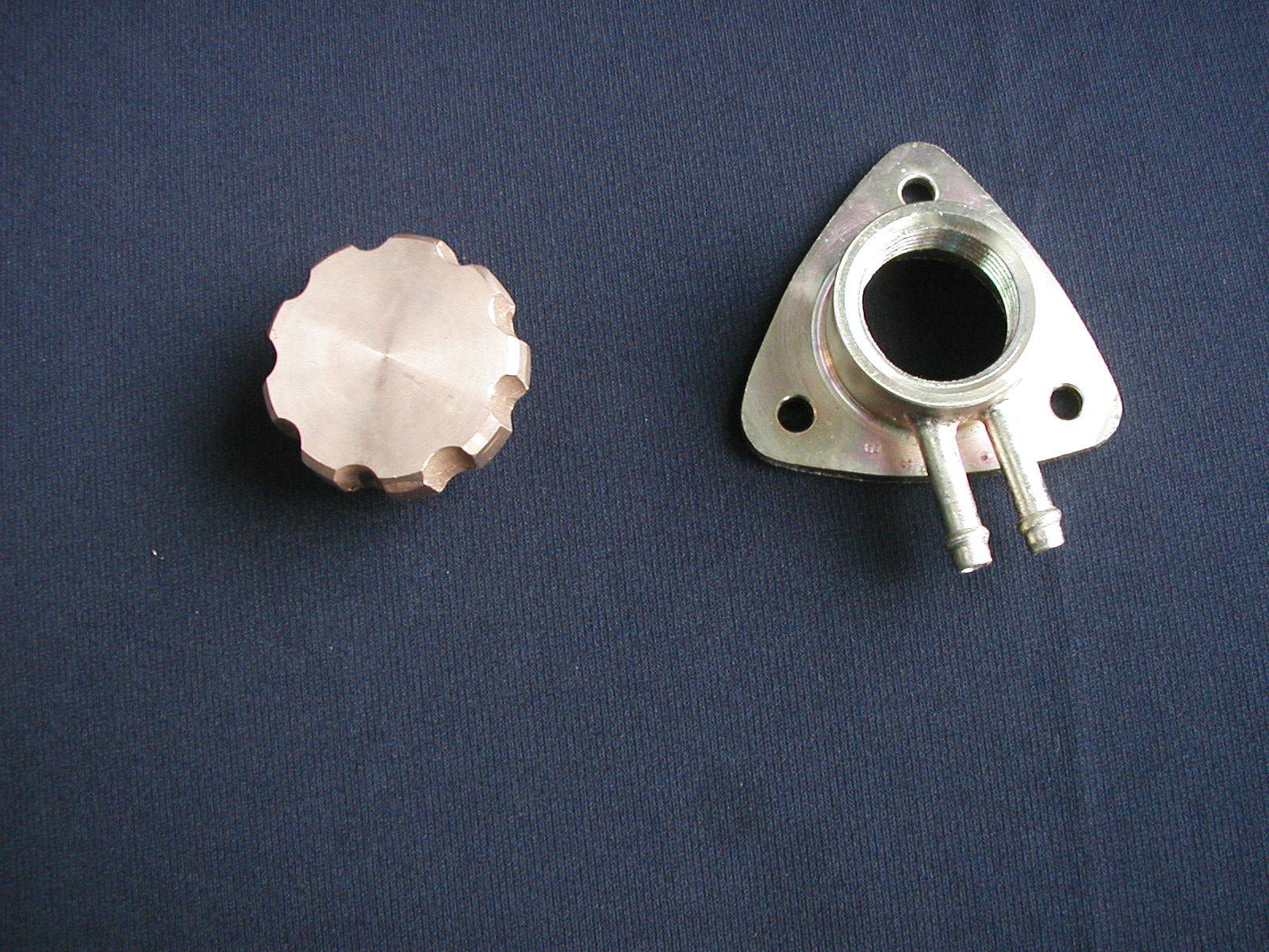

I found these today for the XJ6's, maybe they make one for the V12 too. Call Gary at JagAyre if you want to check it out.
Jaguar Parts Melbourne - JagAyre Leading Independent Jaguar Specialist - Jaguar Parts Melbourne Jag Parts Melbourne Jag Repairs Melbourne
or he trades on ebay as phantomjag
http://stores.ebay.com.au/phantomjag...p2047675.l2563
Coolant on the engine filler cap and A/C compressor-%24t2ec16hhjiqe9quhu0jlbqj4beyfrw-60_57.jpgCoolant on the engine filler cap and A/C compressor-%24t2ec16zhjhie9nyseyozbqj4bgnkvg-60_57.jpg
Old May 5, 2015 | 03:14 AM
  #40
paulyling's Avatar
Joined: Jul 2014
Posts: 6,356
Likes: 1,209
From: Queensland Australia
I'm stumped mate
What are they?
I am still having this problem. Would like to get on top of it if I can.
