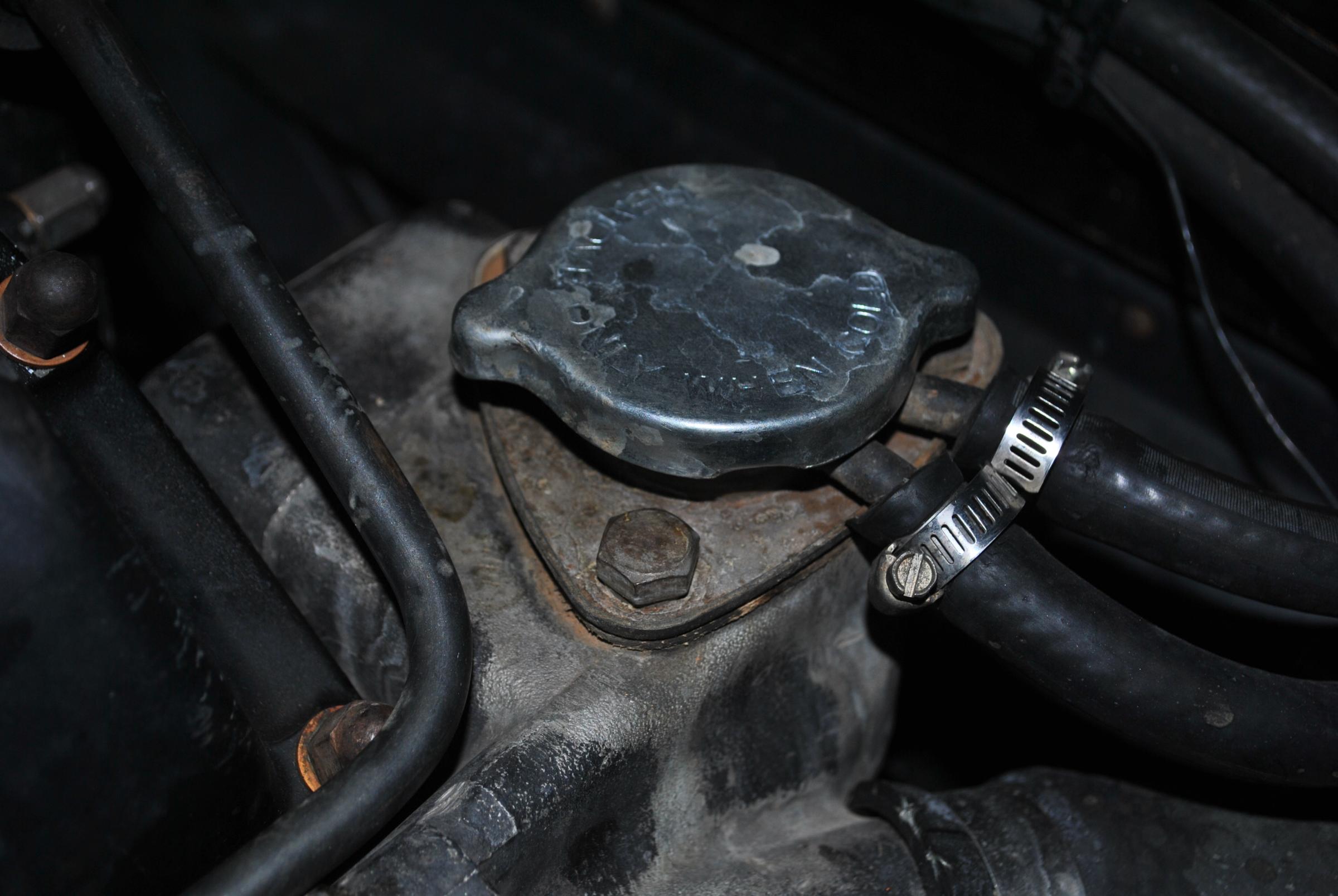

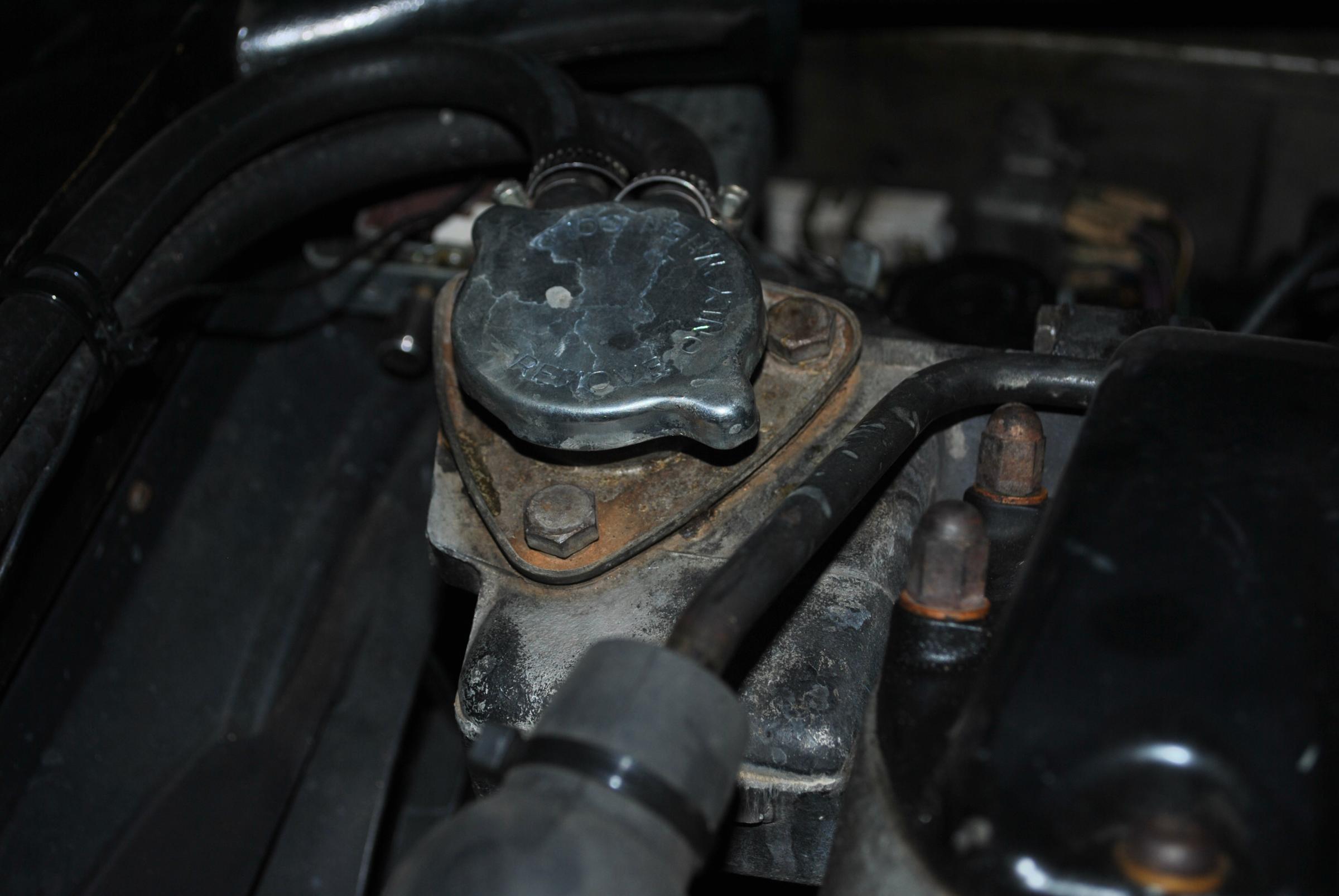

Today I swapped the center cap for a brand new cap identical (16PSI) as i noticed the seal wasnt great (although not real bad). After cruising around for a few more hours I noticed again though that she still had evidence of coolant on the cap.
I found out, outside of the forum, that this cap doesn't really need to be a pressure cap (only the side one does, which mine is 13 psi) and that you can use a blanking cap for the center one. (called the engine filler cap in the manual)
This was also the case for a mates XJ6 who had the exact same problem. Swapped his middle pressure cap for just a blanking cap, and he had no further problems.
Tomorrow I'm gonna try and source one and test out the theory. In the meantime I have been watching coolant levels and engine temp like a hawk but she has been fine.
Ill post if it fixes the problem.
Stay tuned...

Do you still have this problem? If so, I suggest that you do the following things:
- There is a little spigot that goes from the filler spout about 2 inches below the filler spout cap to a little rubber tube that goes to the RHS rad top banjo bolt. Remove the tube from the spigot and check that the spigot is not blocked. If it is drill out the blockage carefully so it is no longer blocked.
- The check that the rubber pipe has the non return valve in it and that this is working. It should blow through towards the rad from the fill pipe and NOT allow the reverse. If this is absent or blocked, get it out of the pipe and replace. JCP still have them and they are cheap.
- Then check that the radtop banjo to which this rubber pipe goes is NOT blocked. Also check that the thin pipe that goes across the radtop is not blocked anywhere. This is the coolant air bleed-off system and it must be free of blockages
- Then replace the filler spout cap with a solid cap such as: Radiator Cap Valveless - Car Builder Solutions - Kit Car Parts and Accessories
Greg

HI guys thanks for the response I appreciate it.
Yes my leak or residue was coming from the filler spout near the centre of my engine, right near the A/C compressor. The cap I use is a blanking cap (non pressure)
I kinda lived with it up till now, checking the coolant levels periodically though.

Paul,
Greg has some very good points and I reckon you and Clarke have covered them
The banjo on the Goose has been modified.
The valve in that hose is NOT there, as I could never get them here, and have not run them for as long as I can remember, and so far no issues, BUT, Greg is correct with what it does, and why Jaguar put it there.
I reckon that the actual spout that the blank cap screws onto is the problem, its distorted from old age and many on/off's of said cap. I have seen them distorted badly, as they are only made of brass. They are in fact, the cap section from any conventional radiator in the world, silver soldered to that upright tube. NOT specific to Jaguar in any way, or "Rocket Science". Any decent radiator mob could simply replace that cap section for you. Even the new" Stainless Steel" crosspipes still have that Brass cap bit silver soldered to the vertical pipe.
Failing that, the pressure cap on the header tank is blowing off too high, but again, I reckon you guys covered that. I run 13psi caps.
As a side thought, I do that. That screwed arrangement Clarke showed for the 6 cylinder cars, could be adapted to the V12 filler spout without too much fuss. You would have to be thinking waaaaay out there, but I reckon Clarke is real good at that, and the radiator guy would need to be out there with you.

They do go home quite quickly Paul. I have just changed mine as the first one only lasted about 4 years. Grant's idea of taking the spout to a rad shop and having a screw top type fitted is a very good plan, IMO.
