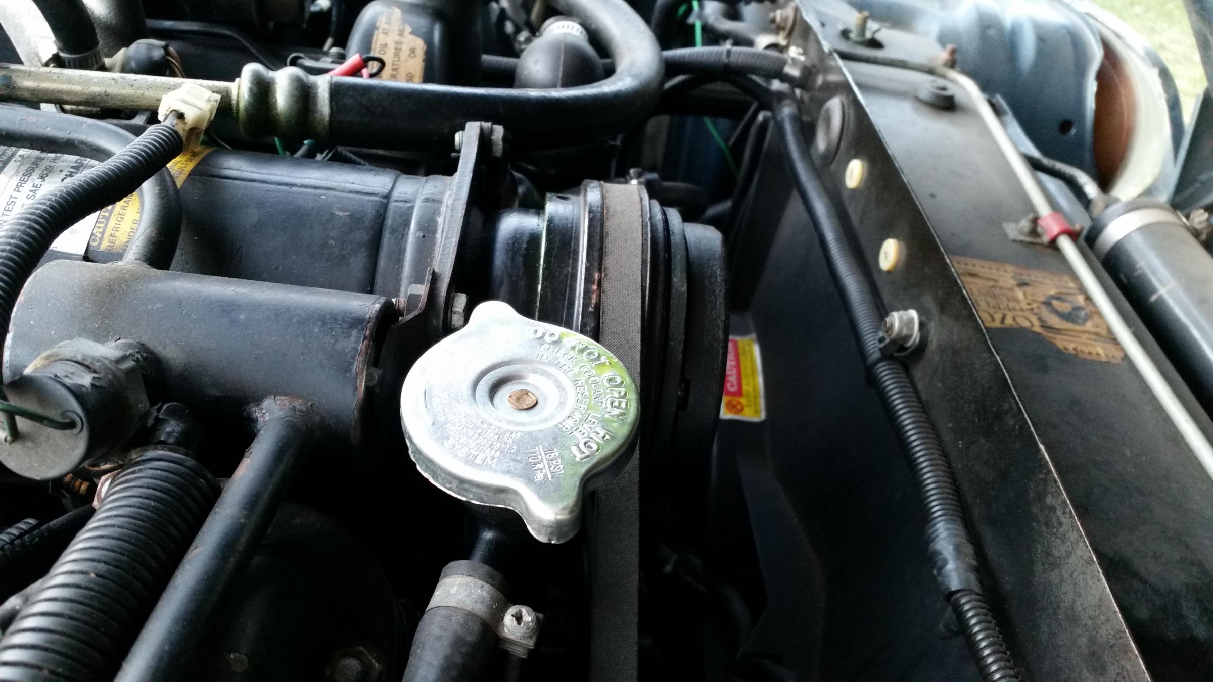

Heh guys
For the last few days I have noticed coolant sitting on top of my Engine filler cap, dripped down the stem and also around the A/C compressor close to the fan belt. I wiped her down but the coolant is back again today, just not as much as when I first noticed.
My coolant levels appear fine (if leaking it would be minimal) and the engine has been running great, with temp sitting around or under the N on the gauge.
Im very new to this game so any advice would be greatly appreciated.
cheers

Try a new cap - the rubber seal is probably just buggered and steam is escaping then condensing on the exterior bits.

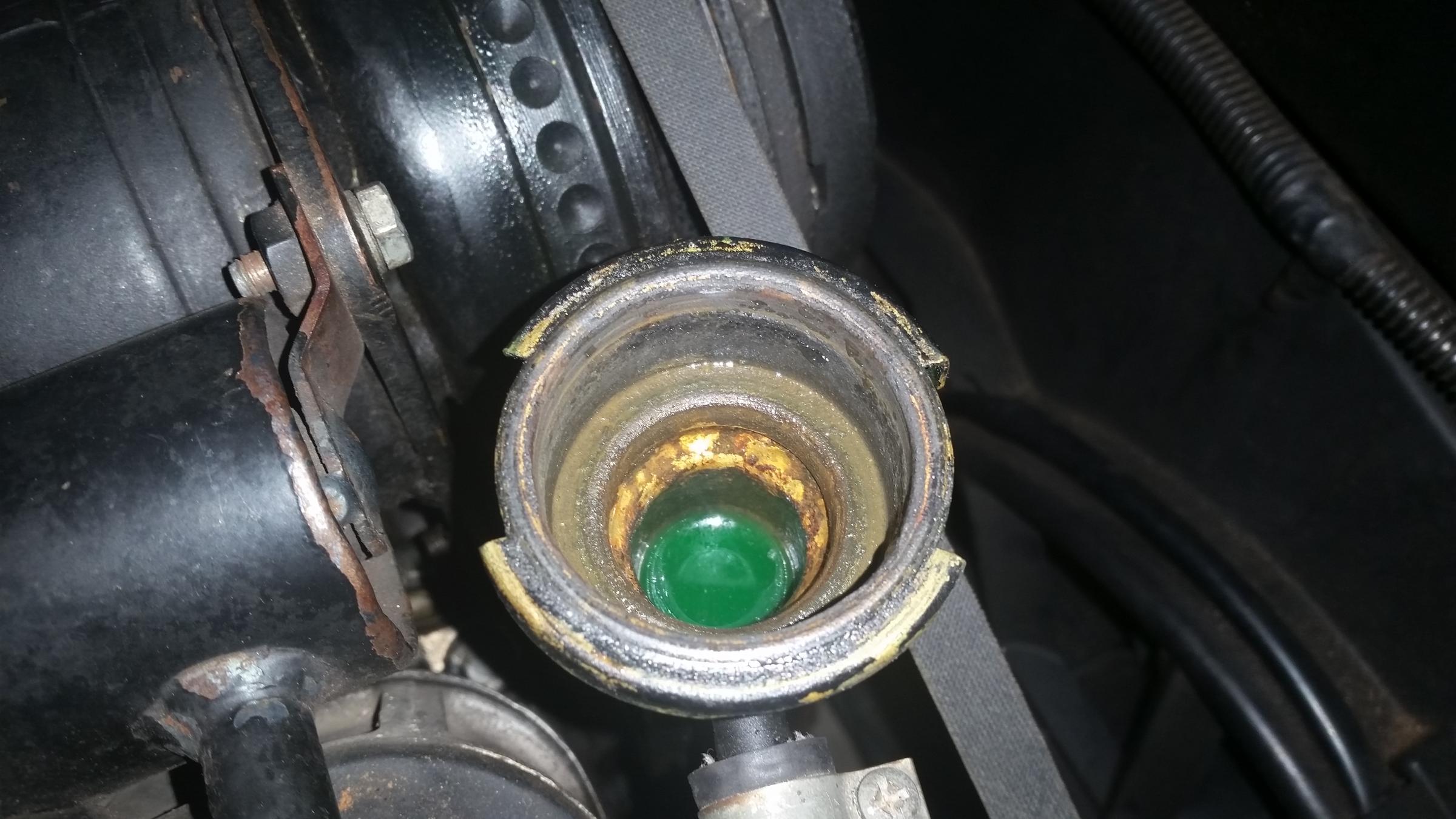

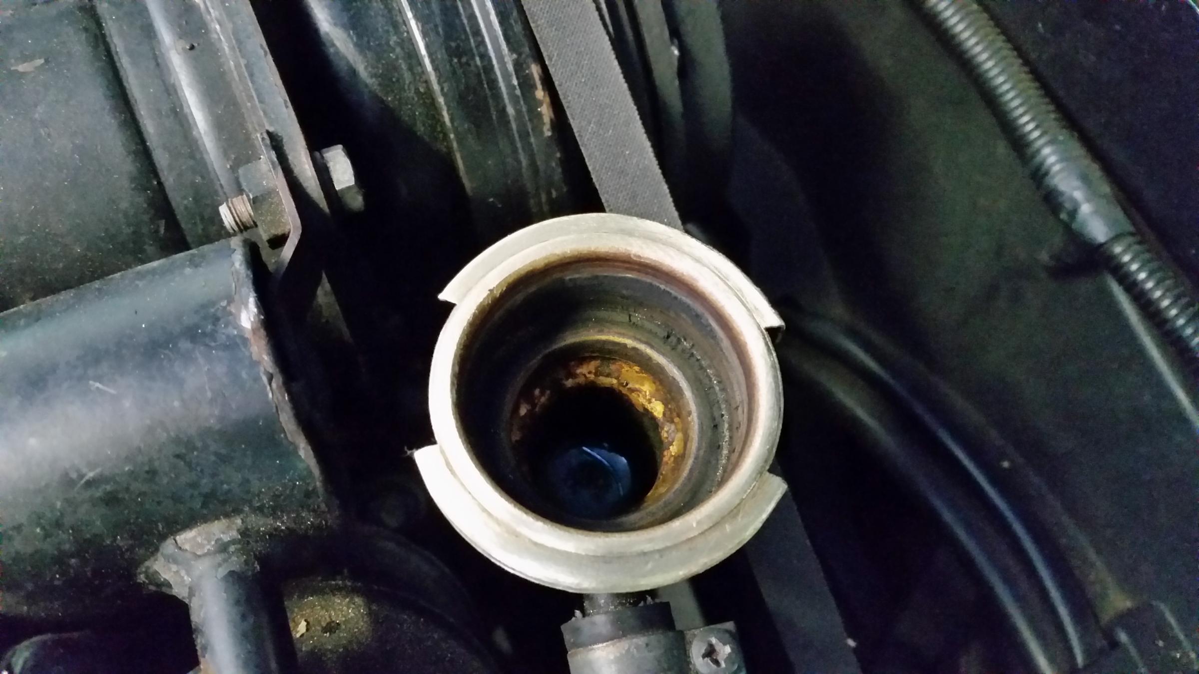

Don't forget that the cap has to sit on a decent face to get it to seal. If the top of the filler neck is a little bit worn,distorted or covered in crud then the cap won't sit flush to it.
Stuff a rag in the filler pipe to keep the crud out and go over the top of the pipe witha fine file until you get a nice shiny ring all the way round it; the cap should fit properly now.
It worked on mine.

Well I gave her a good smoothing down today and was surprised to find how well she came up. I even think the blanking cap "feels" a little more snug.
Unfortunately....I took her for a spin and after checking on her she still is getting some vapor droplets. bugger!
I might try and get that CPC brand blanking cap and try from there.
