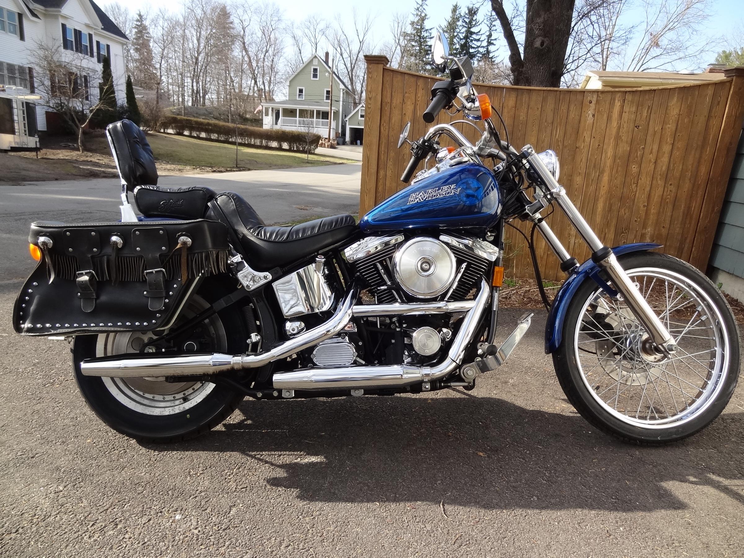

Yes. I sold my softtail not because it was unreliable, but it felt as though everybody was trying to kill me! I still loved polishing it up and looking at it though. And in the end, when I sold it, it paid for the XJS (but I still miss it).

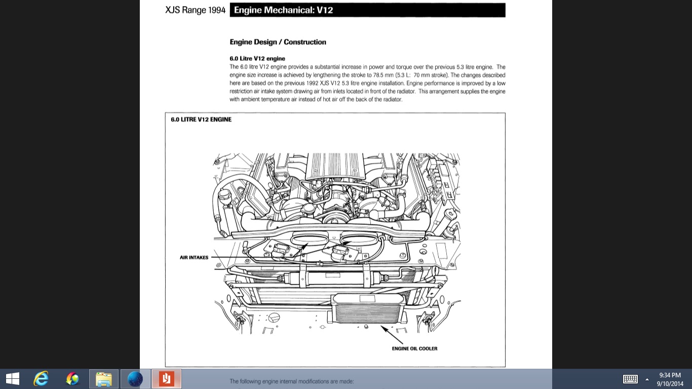

I'm neither an Engineer or a Mechanic, just someone enthralled by his car and trying to understand it a bit better. So correct me if I'm wrong. The small electric aux fan is not meant for after shutdown cooling as there is no coolant flow. And I don't see much airflow benefit during the short time that the fan does run with the engine off (typically under 60 seconds on mine with the hood open). If airflow is wanted after shutdown, then it's either an open bonnet, or louvers.
Anyway, on the one hand, I agree with Greg, that it is possible that venting the engine bay may not help with the longevity of the components. But, I'm not ready to sign off on that yet. I think it's got to make a difference.
On the other hand, I can understand Doug's view that, with improved non-OEM wiring and proactive replacement of rubber parts, venting is a moot point.
Regarding the cold air intakes. The later model cars have just that. By "later" I mean '94 and on (maybe earlier, but as mine is a '94 and it has this change). The intakes have been routed more forward and above the radiator.

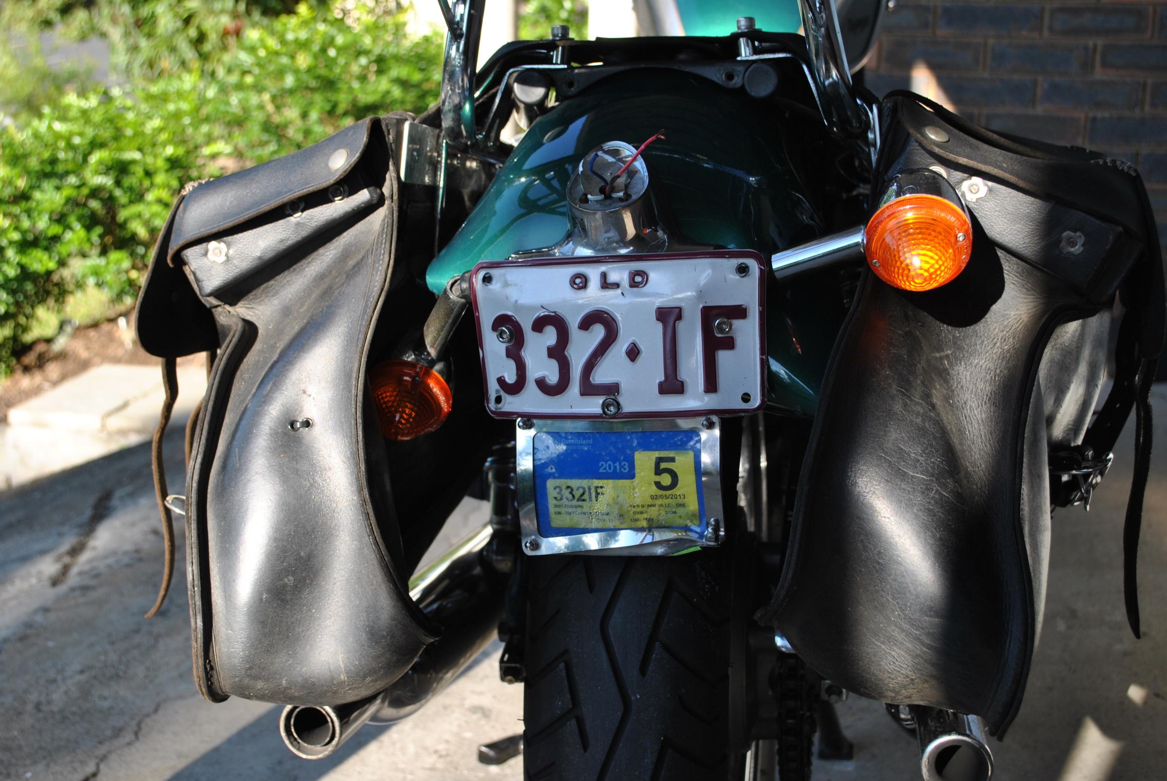

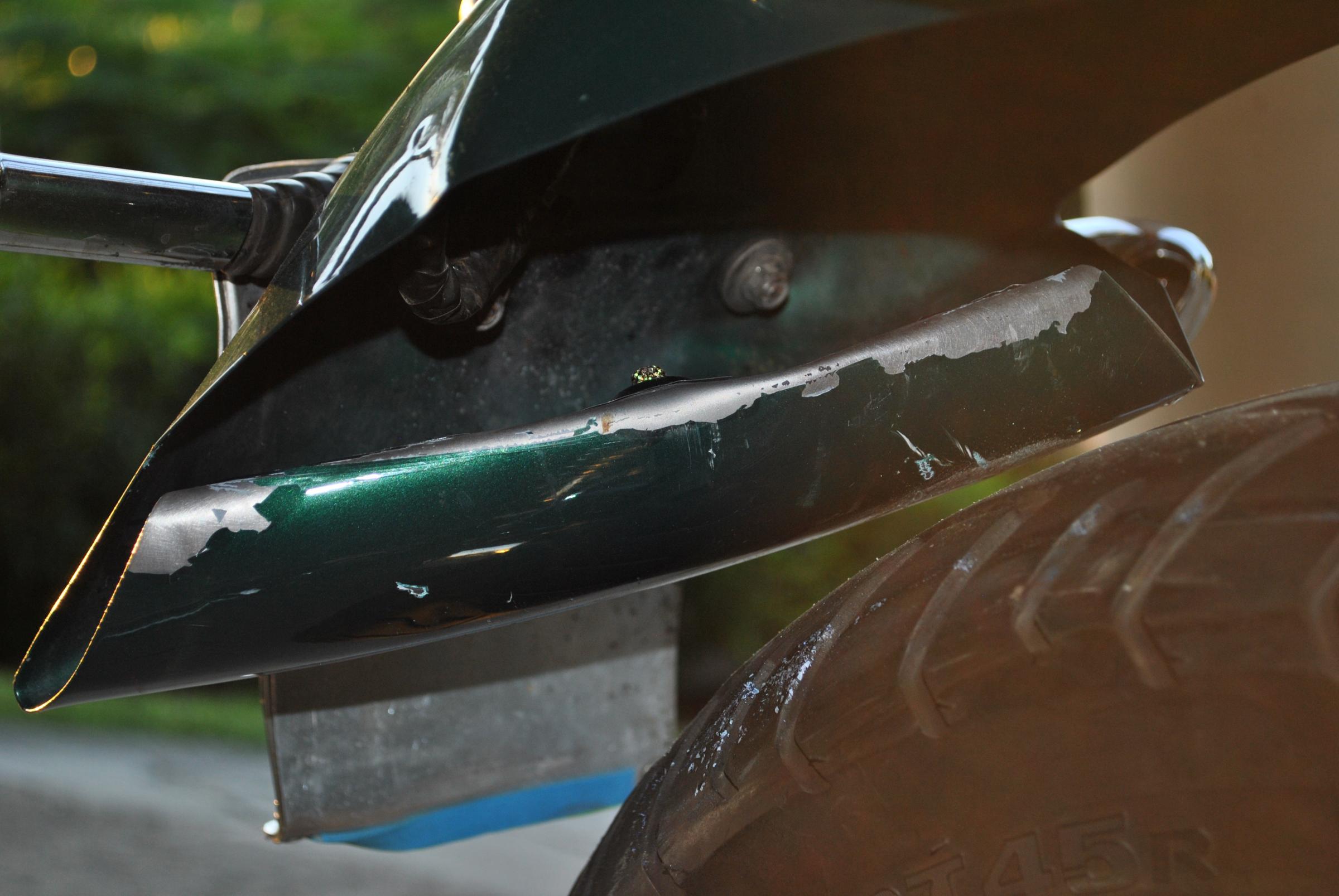

The pics below are what happens when a texting youth doesn't see the lights go red. Although it did make me fell better when I extracted myself from his bonnet to see a destroyed grill,radiator, twisted bonnet and a dimple in his windscreen shaped just like the back of my helmet.
I'm just glad there wasn't a car in front of me. He didn't even brake.
The 4th pic is how the bike was returned to me,better than new!
