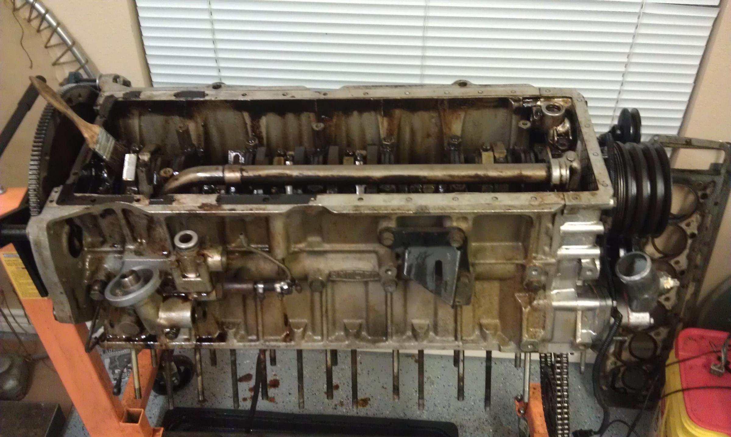

Update. Ordered new valves. Thank goodness for friends in parts departments. Saved me 50%. Took a pressure washer to the rest of the motor last night and cleaned her up good. From there we immediately blew it off and pulled the lower pans off. The sludge in the sump was pretty thick. But wiped out easily.
