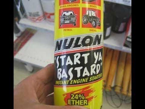

Good spark but is it in the right place - fuel pump cycles but does it deliver anything - crack a line and see - check and recheck connections especially the injectors if you didn't replace the old n crusty injection harness. Beyond that if you give it some of this
and it still won't run you don't have spark or it is occuring in the wrong place and it may indicate this by trying to burn off your eyebrows - the V12 spits fire if provoked, if it does run you have a fueling issue

BenKenobi's advice on using canned ether should be painted on every workshop wall for all to see!
No start, despite good battery and adequate cranking speed?
Then . . . No spanners. No mess. No guesswork, A 5 second spray of ether into each air intake and observe . . .
  • if engine starts, runs for for say 10 seconds, then stumbles and dies . . . you have a "no fuel" issue;
  • if engine coughs, spits, singes eyebrows . . . you have an "ignition timing" or "valve timing " issue;
  • if engine remains as dead as a dodo . . . you have a "no spark" issue.
This is an unambiguous, quick and easy first step to your fault-finding.
