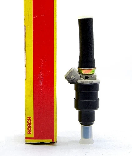

FUEL INJECTOR FOR JAGUAR XJ12 XJS DAIMLER DOUBLE SIX S3 H.E 5.3 V12 0280150164 - Picture 1 of 14

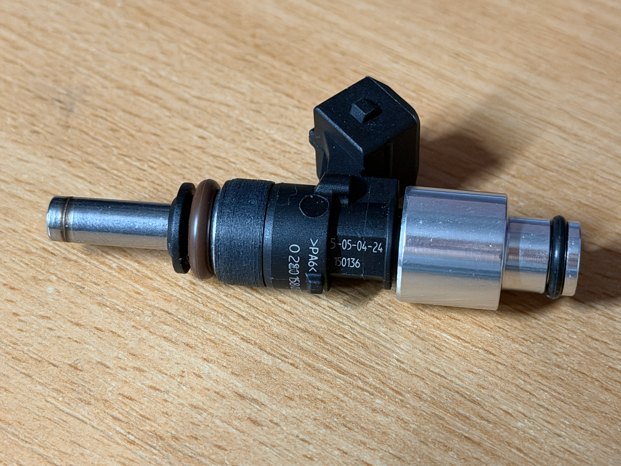

Hope your supplier isn't leading you astray, 162 suffix is an EV1, single nozzle, they're a low impedence single pintle.
An EV14 profile won't fit standard 5.3 manifold unless you get clever with the O rings as the standard 5.3 inlet won't play nice with standard O rings, the injector pocket must be a smooth almost mirror finish with an absolute max dia of 14mm, ideally 13,7 - 13.8, EV14 will likely be high impedence too (though I think you can get low impedence versions, the standard ECU won't like high impedence unless you get rid of the resistor pack and even then it might not be able to fire them. The standard EV1 is easy to open for the ECU but then requires the resistor pack to maintain the open state or the ECU gets fried I don't know if it would have the beans to open an high impedence. The rubber sealing rings used on the EV1's won't work, EV14's don't take hoses either.so fuel rail needs work.or you need to machine hose tail adapters,
The EV1 uses the clamping pressure of the retention plates to press the injector into the seal which is more like a rubber washer than an o ring, there is also a secondary seal inside the collar that the retention plate clamps down on, sits in the groove in the larger body.

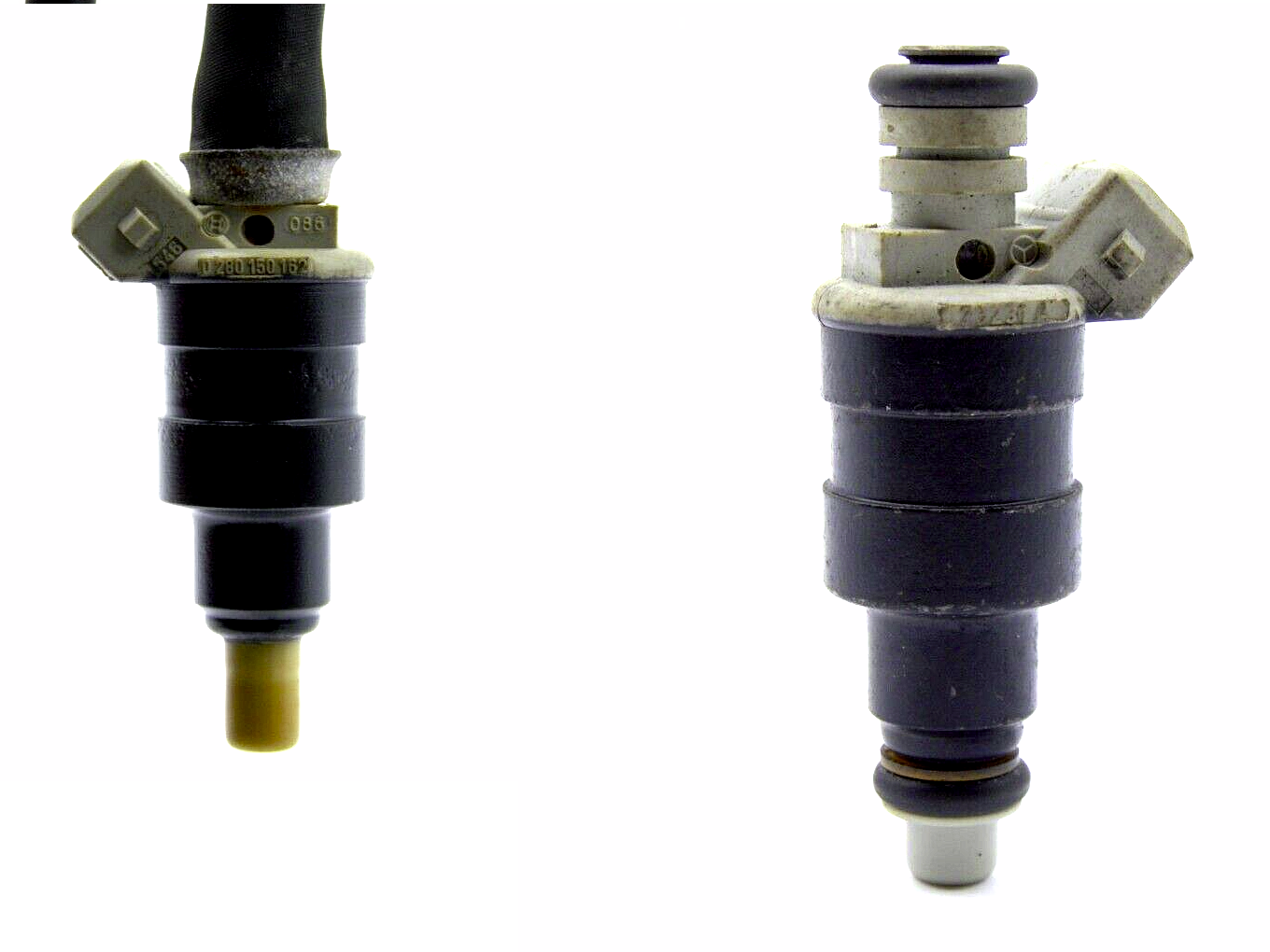

Both of these in this image are EV1, the version shown on the right was fitted to the 6.0 but the fuel rails are totally different (and harder to find than a unicorn in decent condition), notice the '162' on the injector on the left (last three digits of number)
This is an EV14 with an extension pocket.

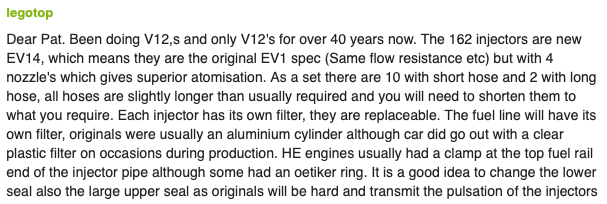

I may have been missled with the description of the product I purchased. I have Bosch 161 in my car. Ben is selling Bosch162. It looks like the Bosch 162 will fit in my car but it is not a EV14 and it does not have four nozzles. Below is the description Ben sent me and attached are pictures of the products I purchased. Are all the parts in the pictures what I need? Is there anything missing in the picture or the description to reassemble the fuel rail? I purchase the injectors from this supplier because he was recommended to me in this forum. I liked the price but the cost went way up with the shipping, taxes, tariffs and other fees. If I knew the total cost would be this expensive and does not have the short hoses I probably purchased the parts from some one on this side of the pond. It is my understanding the long hoses are 9mm and the short hoses are 4.5mm is this incorrect?

The pdf of the Bosch injectors you posted are indeed the correct type for your 1989 v12
https://www.jaguarforums.com/forum/a...703d1772304904
To fit them you will need the small and the large rubber seals from this kit:
https://www.mrinjectoruk.co.uk/produ...ervice-kit-180
If you contact Mr Injector they may sell them separately.
