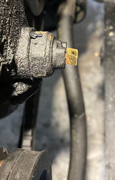

One more question in addition to the bleeding one above. The two wires that go to this sensor, does it matter which one goes to which spade connector?
Help on both questions is much appreciated.
Thanks
Doesn't matter on the sensor question. On the bleed / banjo question, bleeding has never required more than running motor for a few minutes, shutting off and removing crossover pipe filler cap, top up if required and cap back on, done.

That sensor is the thermostatic switch for the auxiliary electric radiator fan.
