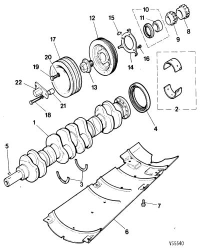

I am looking for:
Crankshaft Damper XJ12 V 6.0 1994
EBC9389
New or used
Can you help with that?

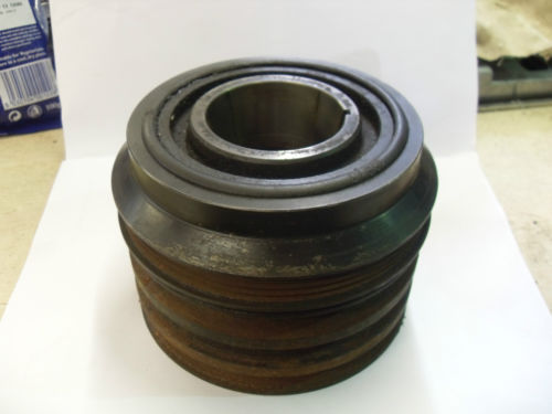

Thank you. But my damper is not posible to rebuilt. destroyed

If it's just the rubber in between, it is rebuild able. If the metal parts are bent, then maybe not. The rebuild process replaces the rubber.

No way. Not Marelli. For cone. it is from ebay
