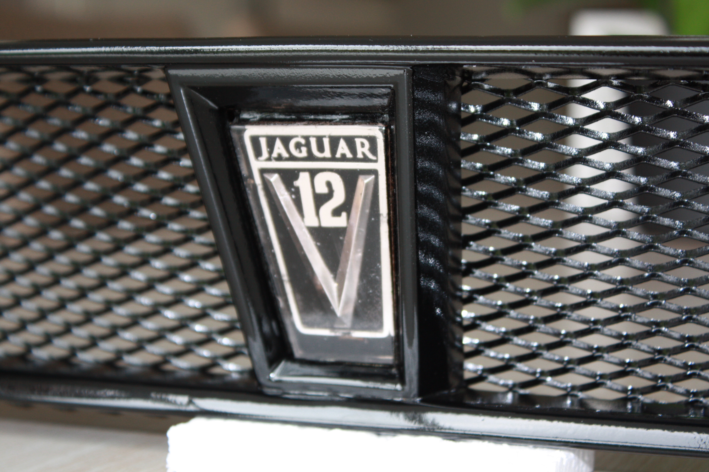

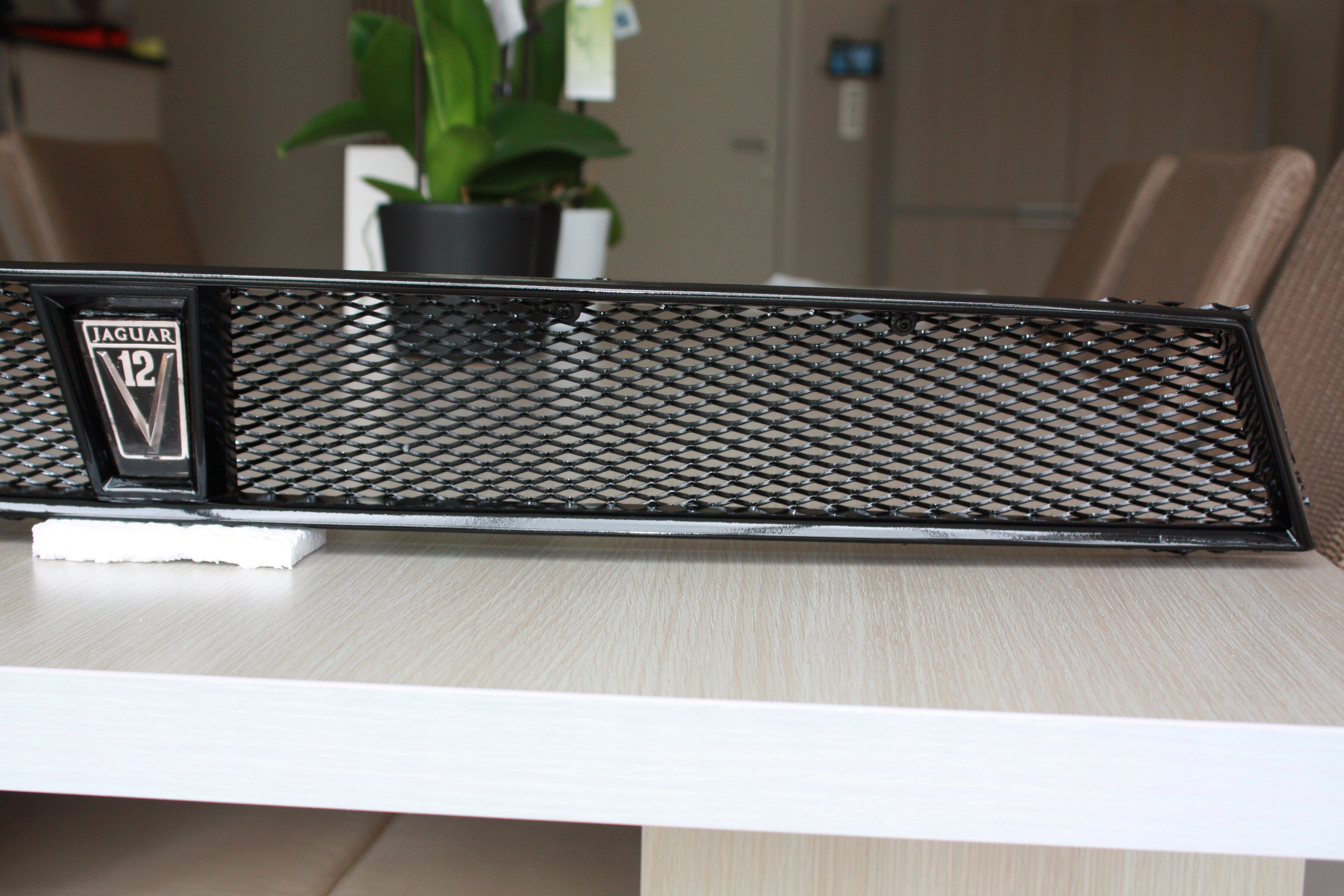

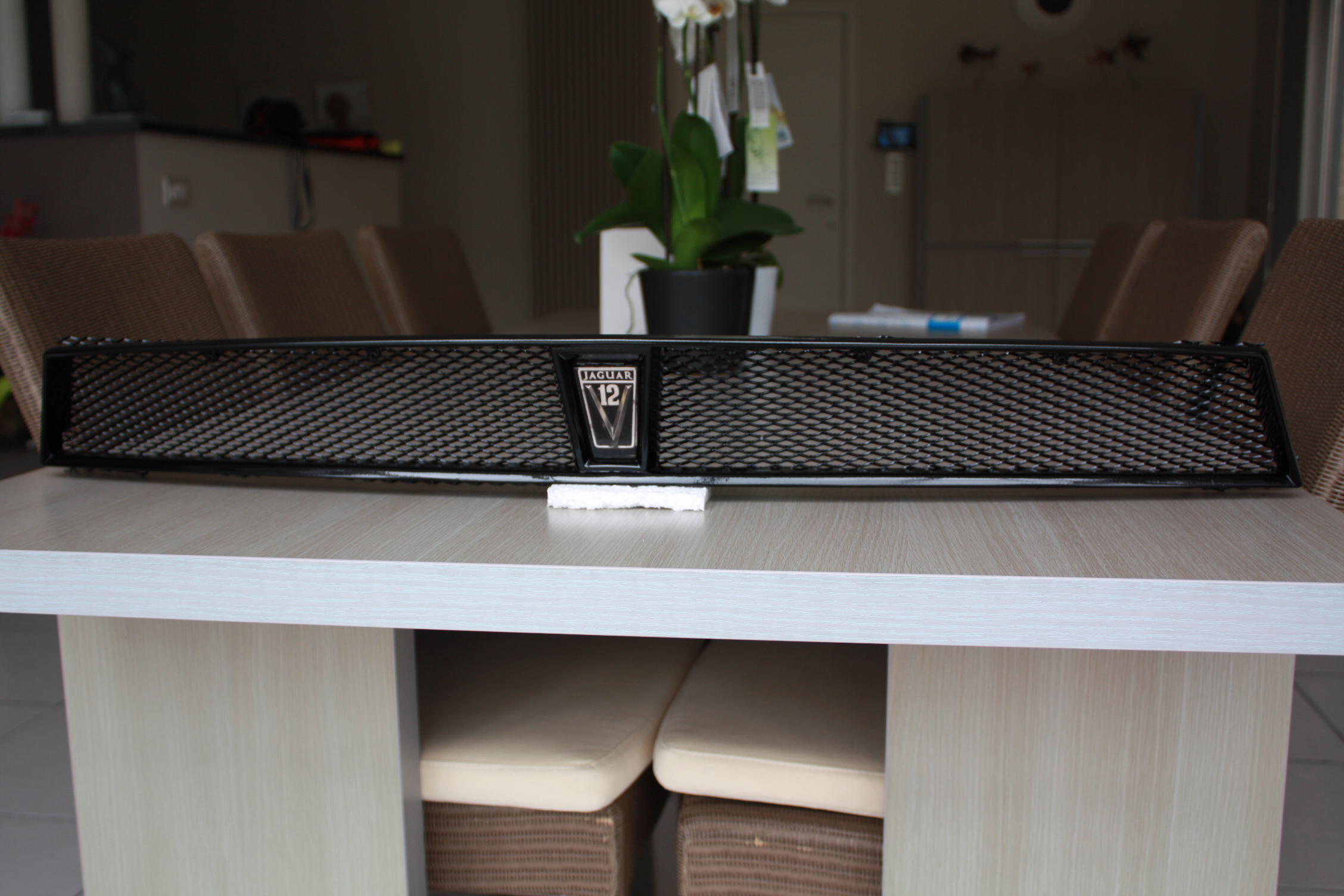

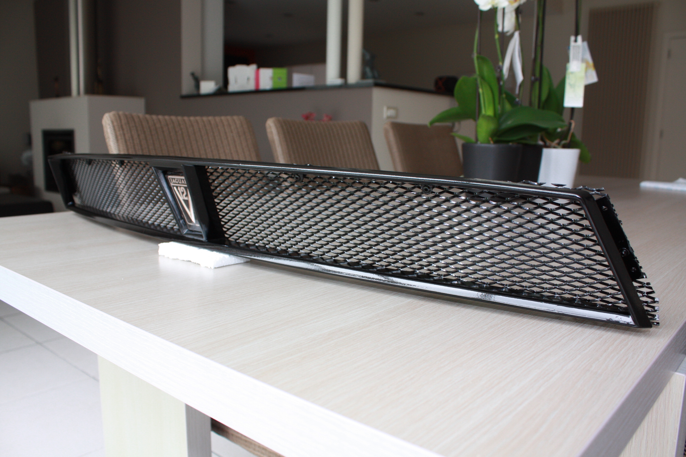

I'm very happy with how the grill turned out
all the filed off pieces filled with metal putty and then sanded and primed with spray filler.
after that 4 layers of black paint I will let the paint dry for a few days and then add a red pin stripe at the bottom of the grill.

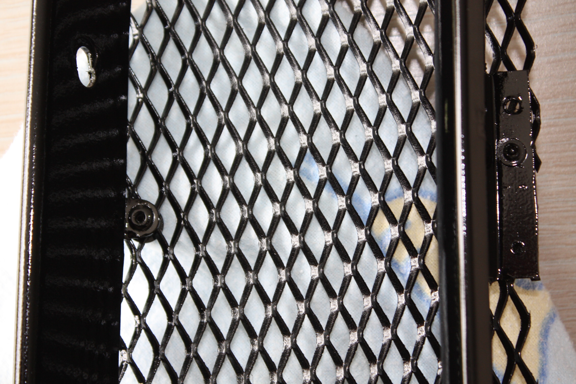

That looks awesome!
How did you attach it to the old grill frame? Can you show a photo of the other side?

Great job!! it looks realy good. I did the same a while ago and agree with Jagzilla that it brings out the V12 emblem.

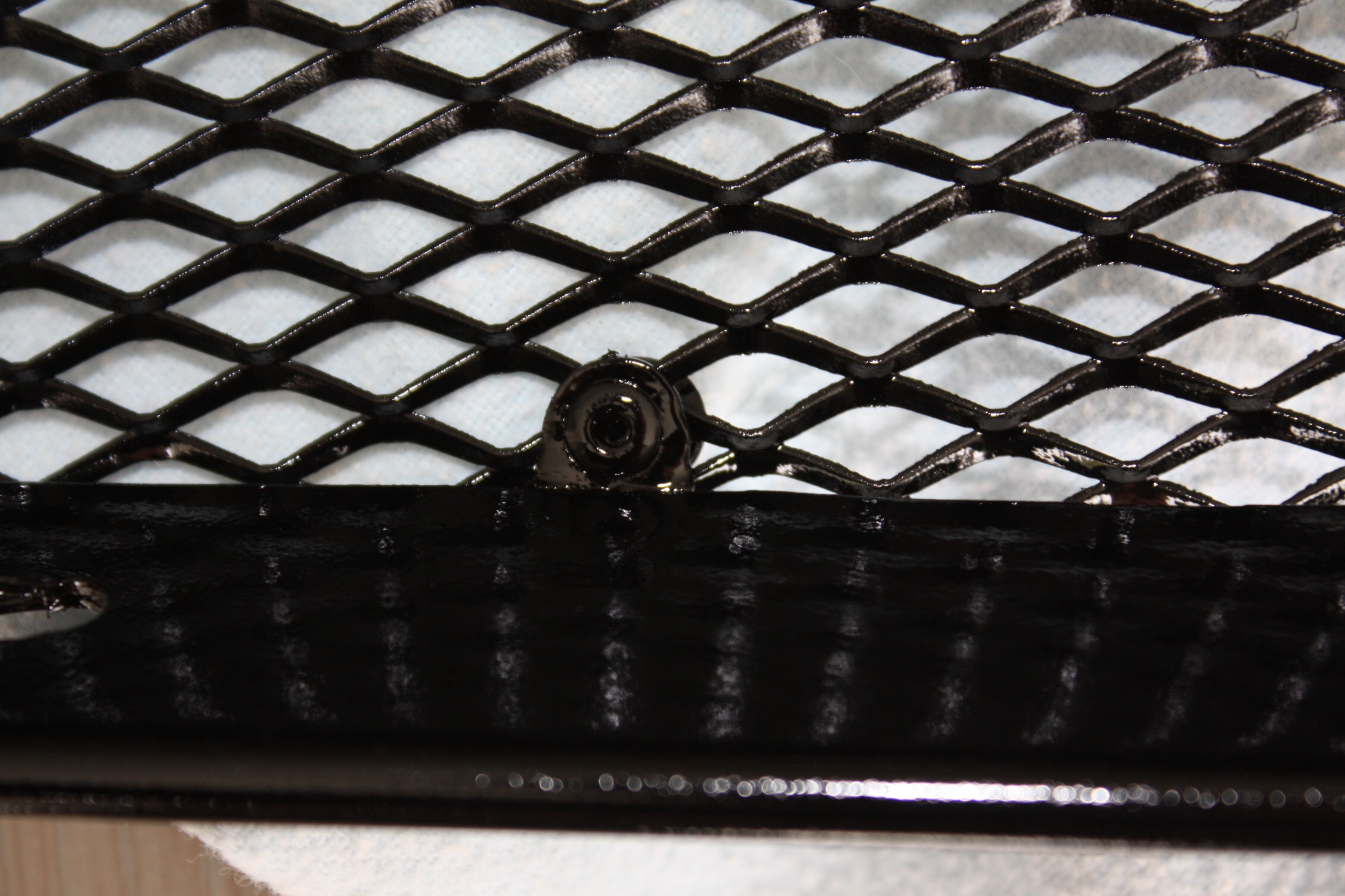

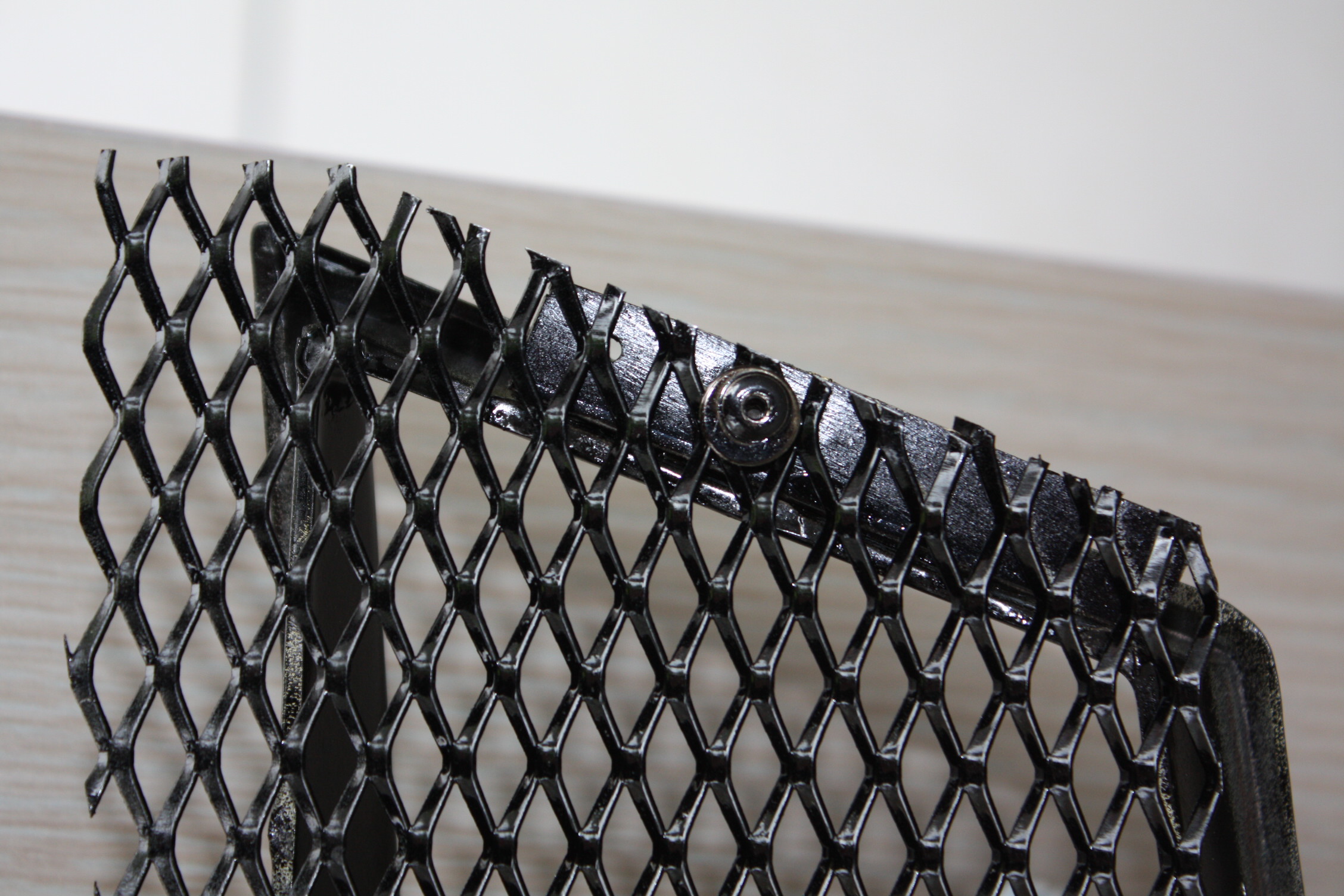

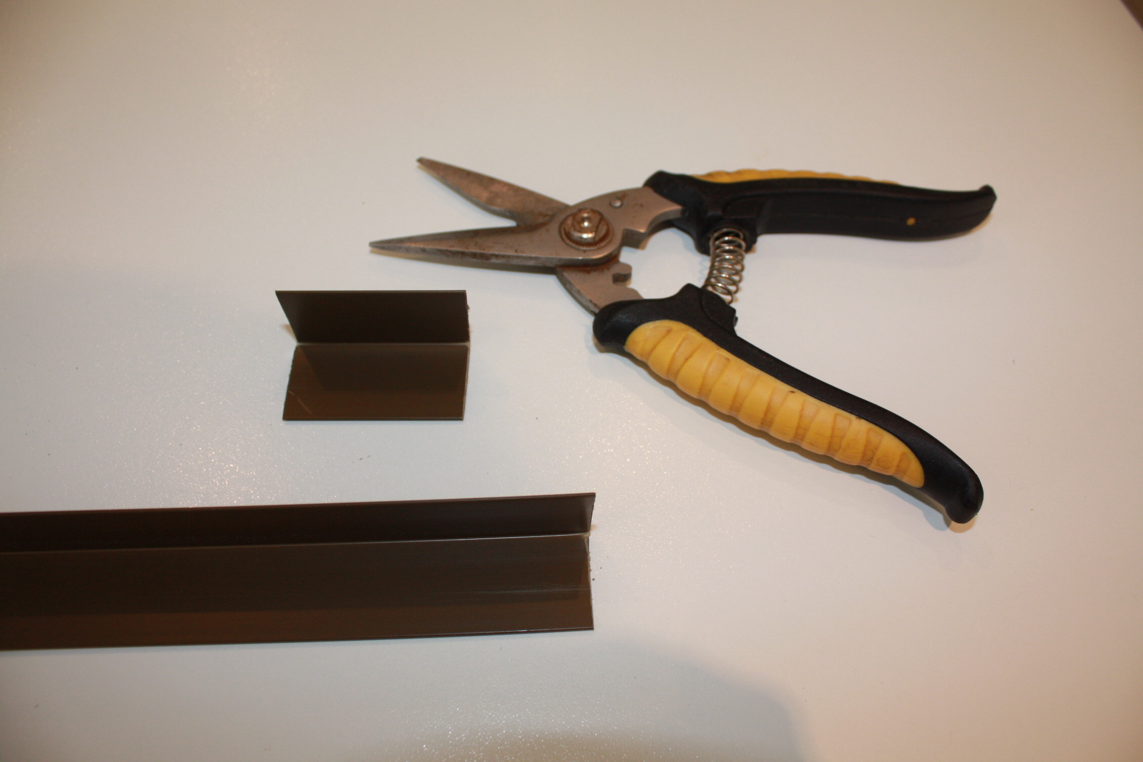

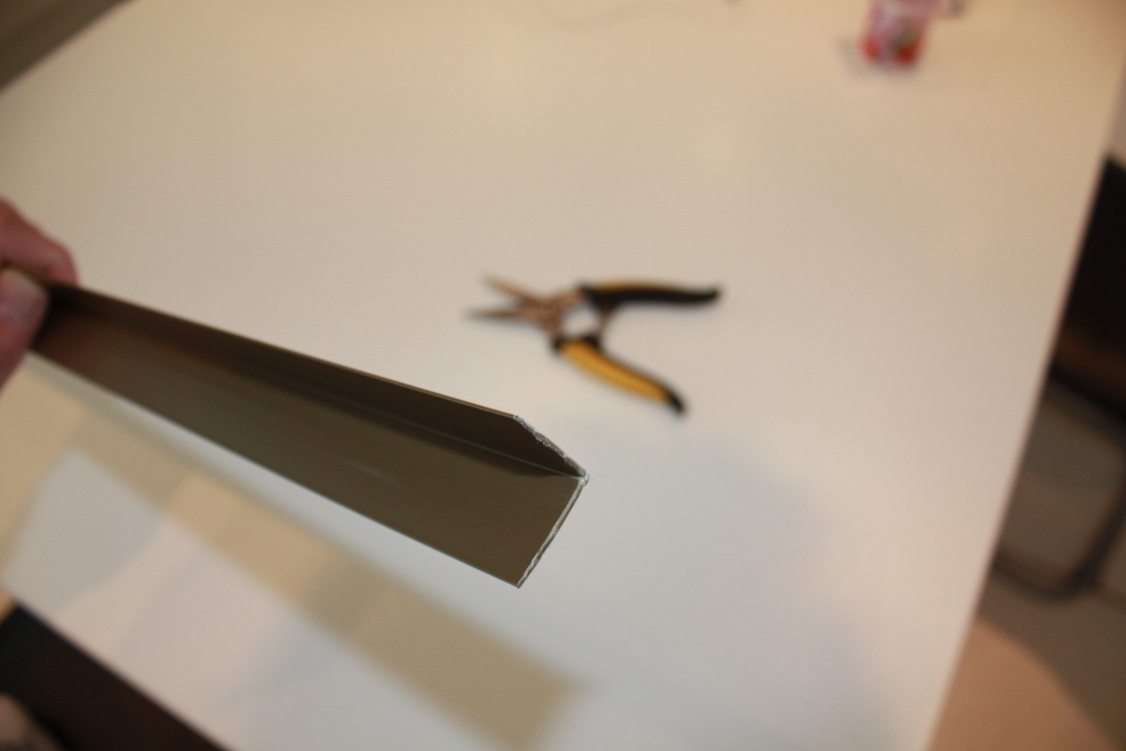

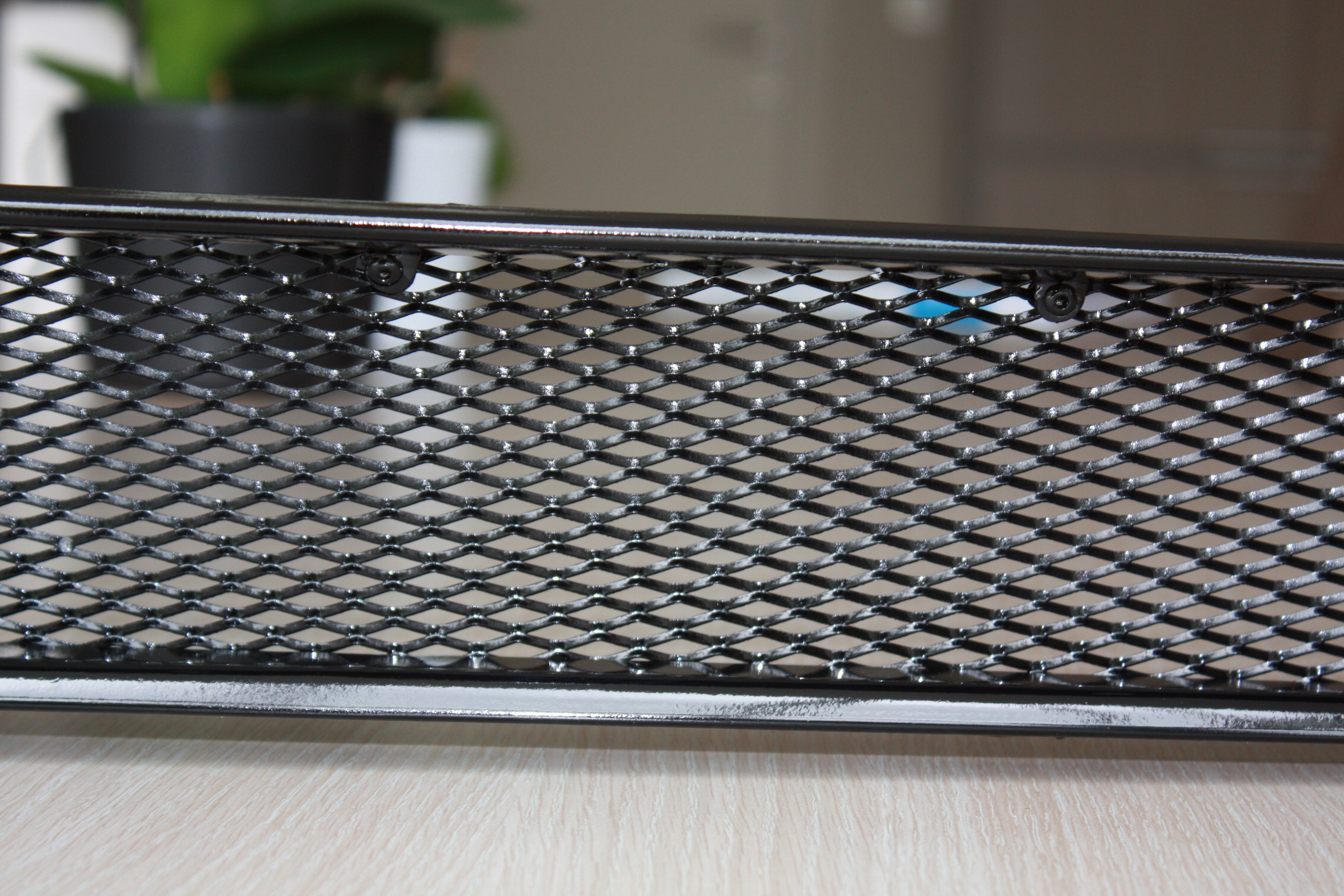

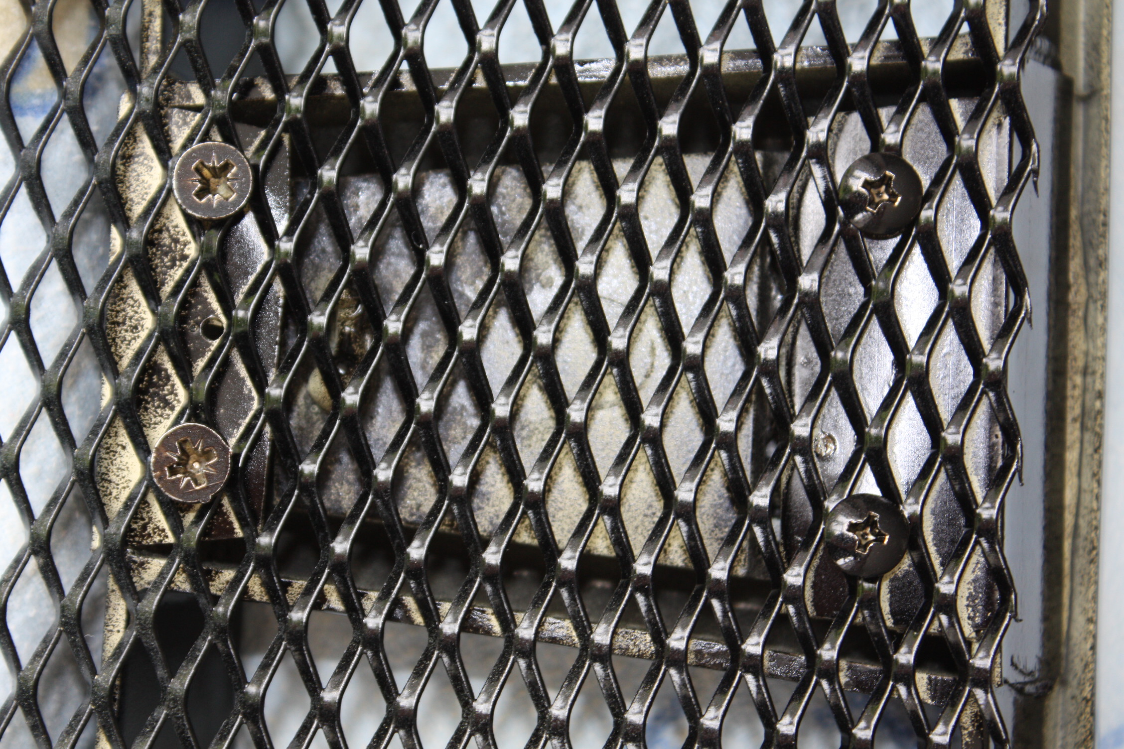

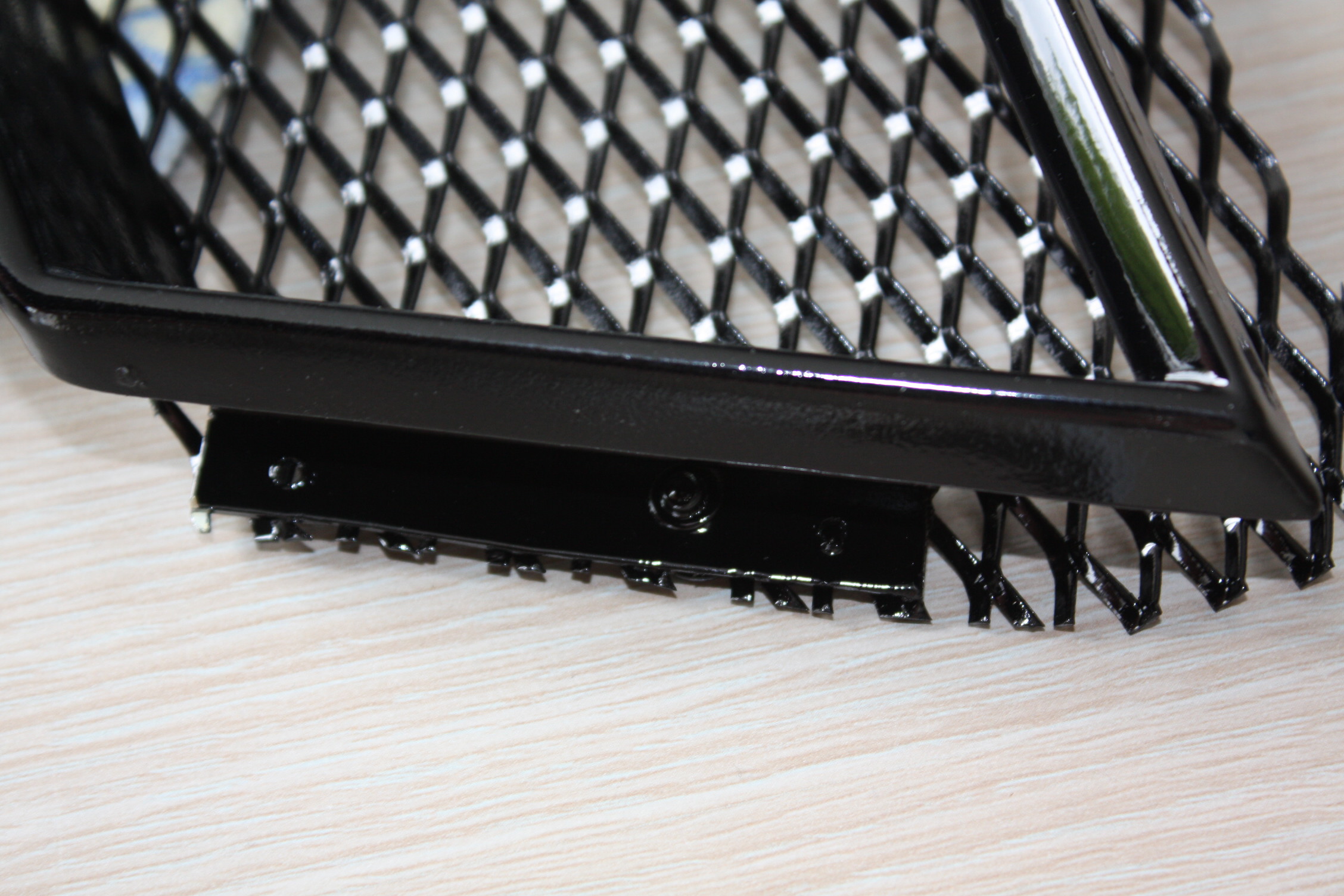

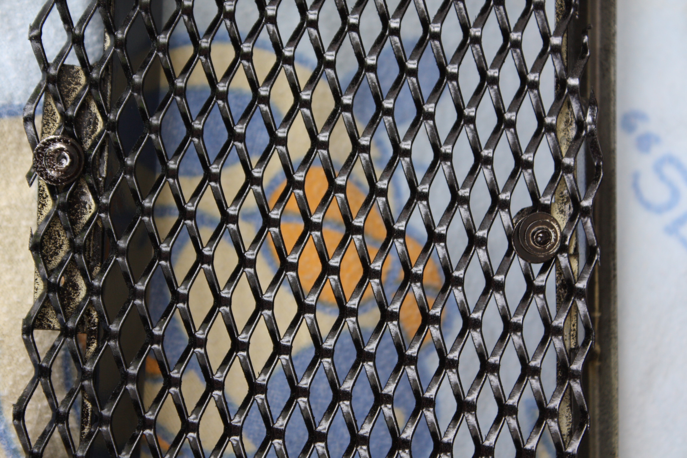

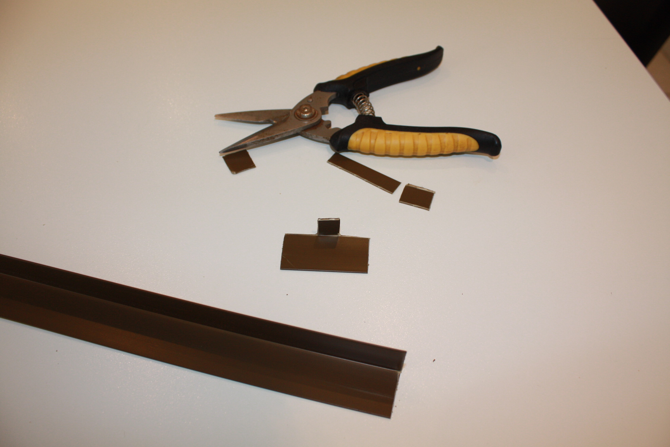

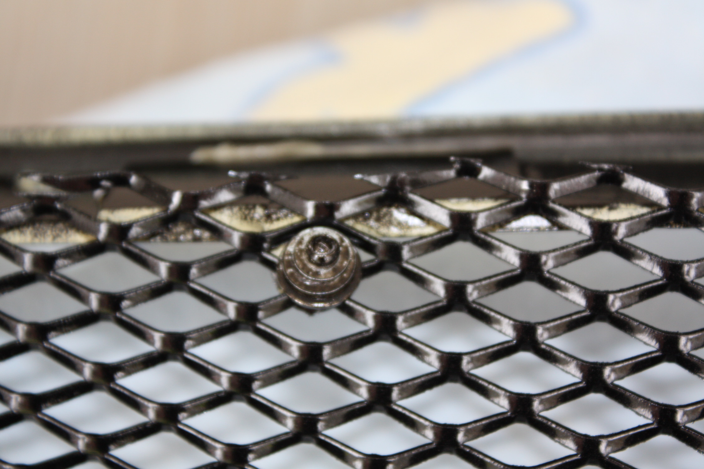

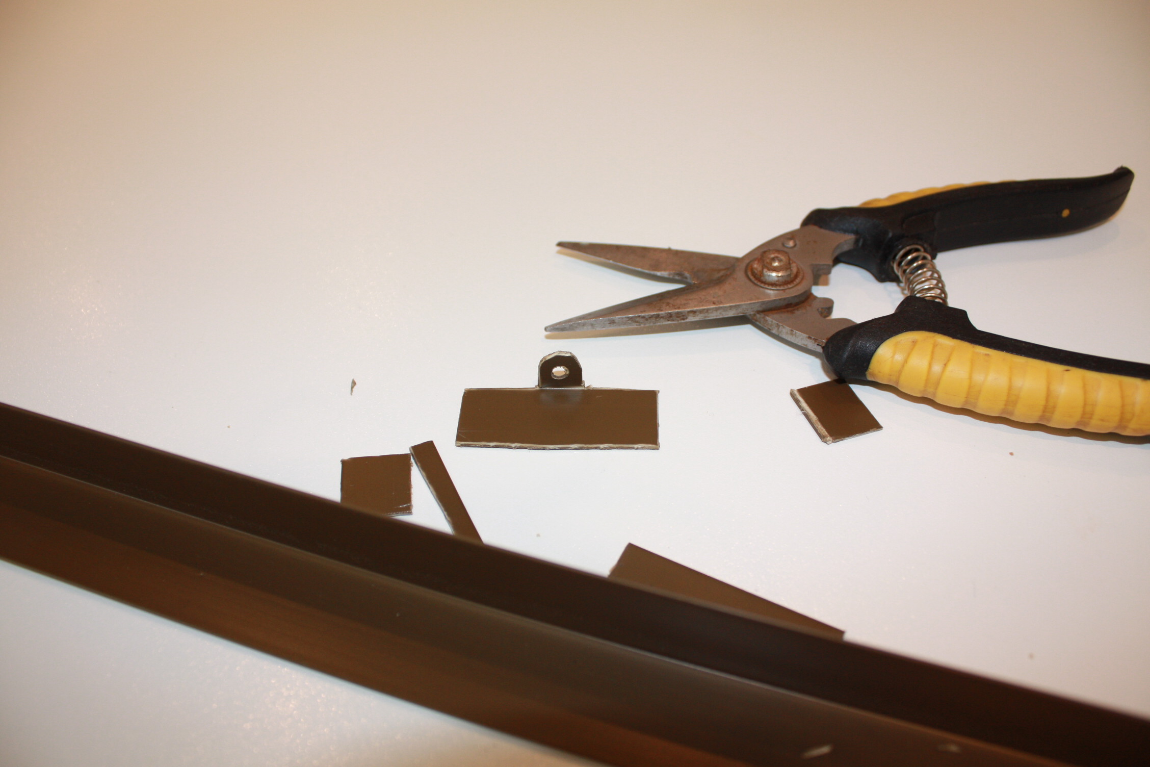

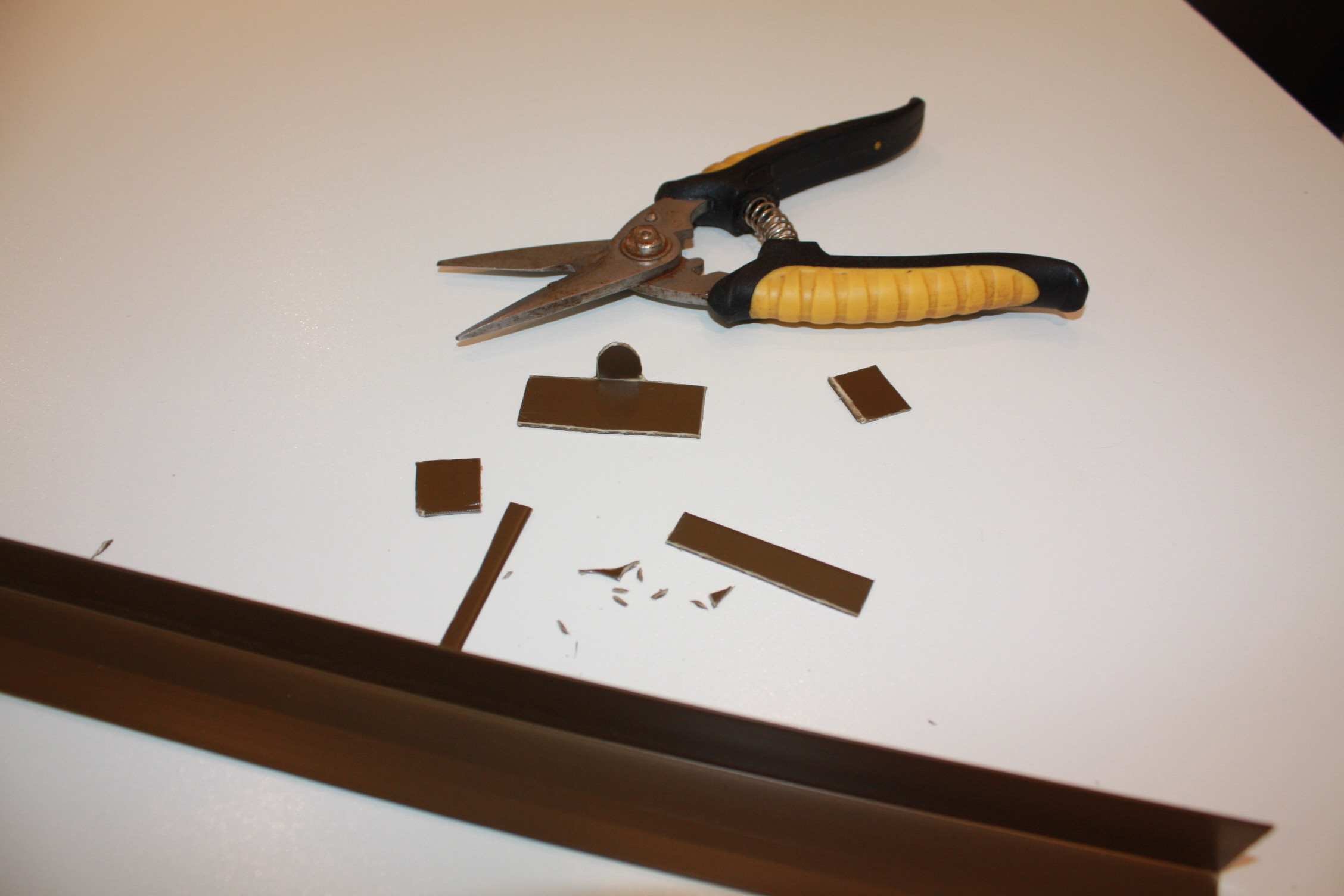

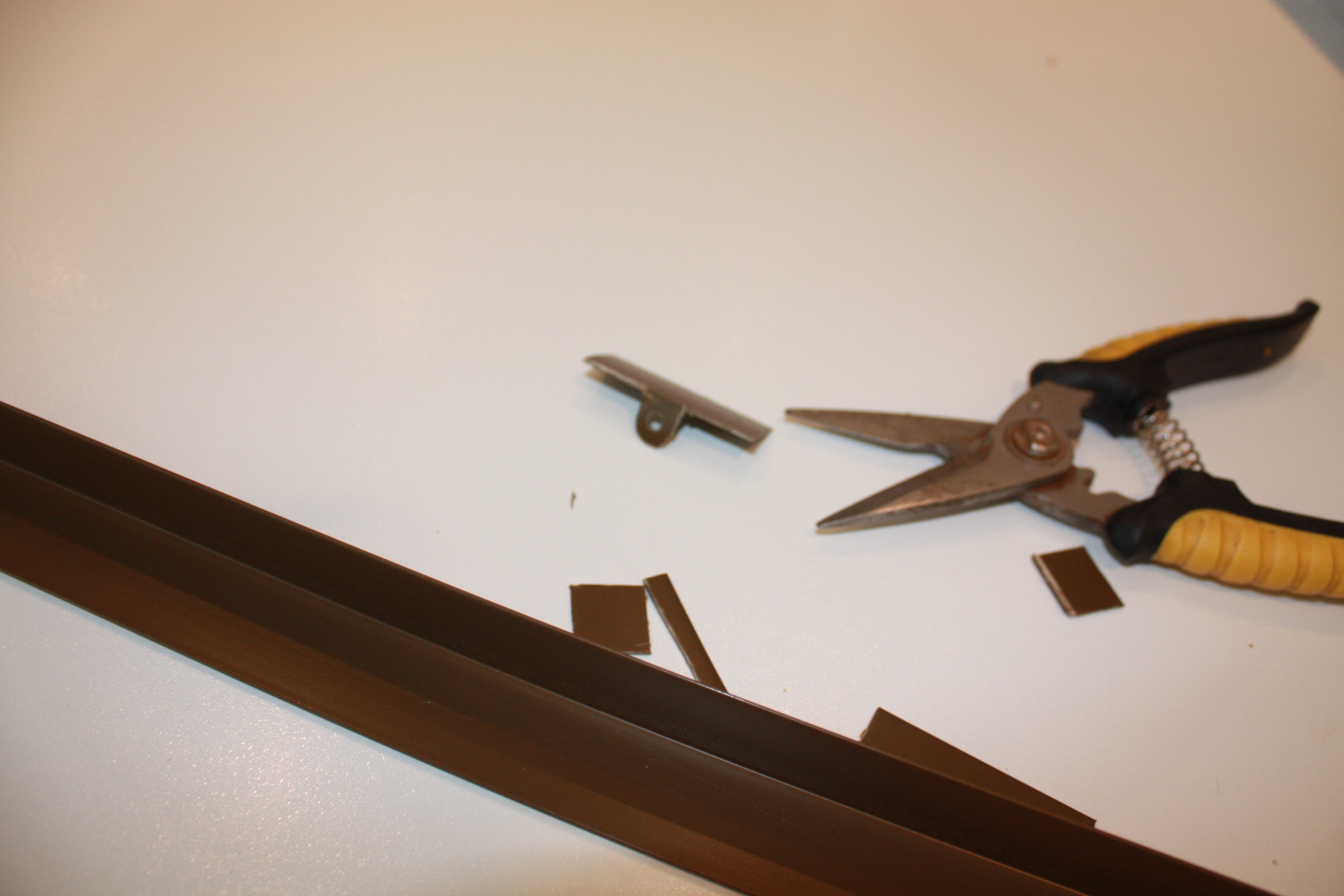

It is really a simple modification that everyone can do, this is what you need
- scissors that can cut through plastic
- plastic 90° rail, 40x40mm , 200cm long (durable and bendable)
- rivets 3mm thick, 7mm long + a few screws
- 2K superglue
- filler + filler spray
- sandingpaper
- black gloss paint
I started cutting the pieces of plastic out of the plastic rail. 4 on top, 4 on bottom and 2 long in the middle + 2 long on both sides.
On top you cut to nice rounded shape and drill holes in it. on the bottom I left them wider so they hold the mesh better.
Start sawing the inner pieces out of the grill. Where the plastic was attachted to the frame, use a dremel grind away the plastic. Grind away all exessive material on both sides of the V12 badge and the outsides. Start filling all the plastic so it becomes smooth and you can no longer see that there was plastic before. sand the filler to perfect finish.
on botom side you will be left with 2 triangle pieces missing on both sides (where lower attachment was. I glued a piece of plastic underneath the frame and filled that too with filler...
Now glue (with 2 component superglue) the plastic pieces you made at exactly the same spots where you removed the inner frame on both sides of the grill.
Let dry for 12 hours.
Now place the mesh on top of the grill. Screw the mesh to the grill (behind the V12 badge). The rest of the attachment is done with the rivets. Now cut away excessive mesh.
Mask the V12 badge with masking tape.
Clean well and give it a few layers of spray filler. sand each time with P1000 paper in between layers.
When you are happy with the look, give it a few layers of black paint.
It took me 2 weekends but I take my time for these things
