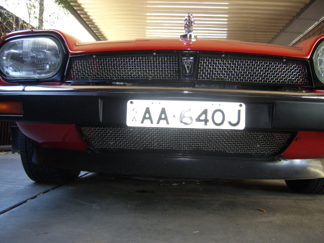

There was a post about this some time ago.
Lots of variations shown from memory.
This is mine I did about 15 years ago.

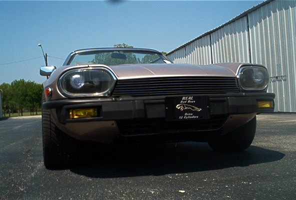

mine is a bar grill, straight across, cut to fit opening.

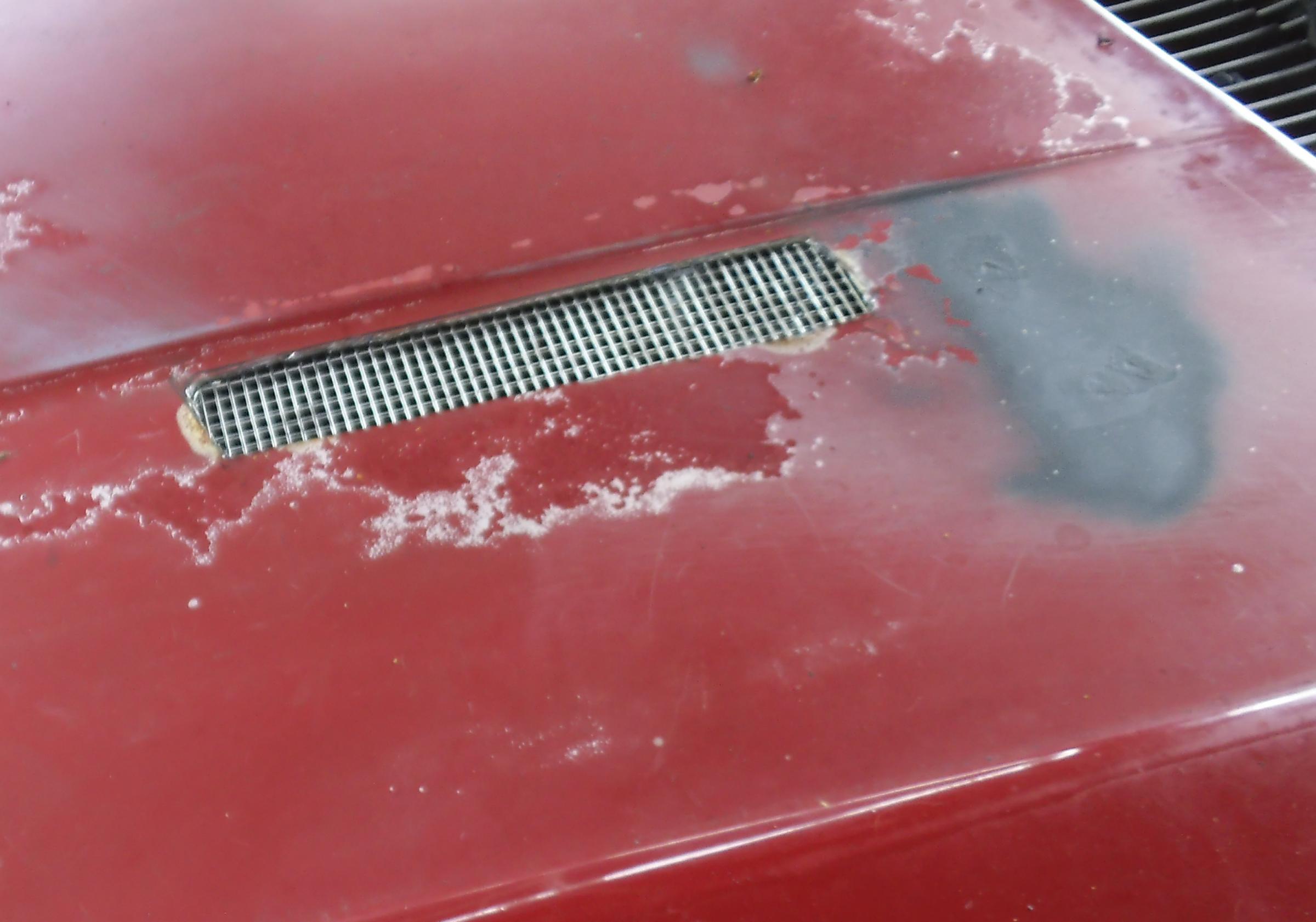

Default grill and louvers
Here is a picture of the grill and the rough cut on the louvers. This is with a stainless square grill in the louver but I am using the existing pattern I used in the front grill and paint it black. This weekend I should have the drip trays finished also. Not enough time for all the projects! Im waiting to finish the louvers so I can do the body work. It is incredible the amount of heat that comes out of the louver.
