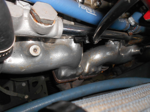

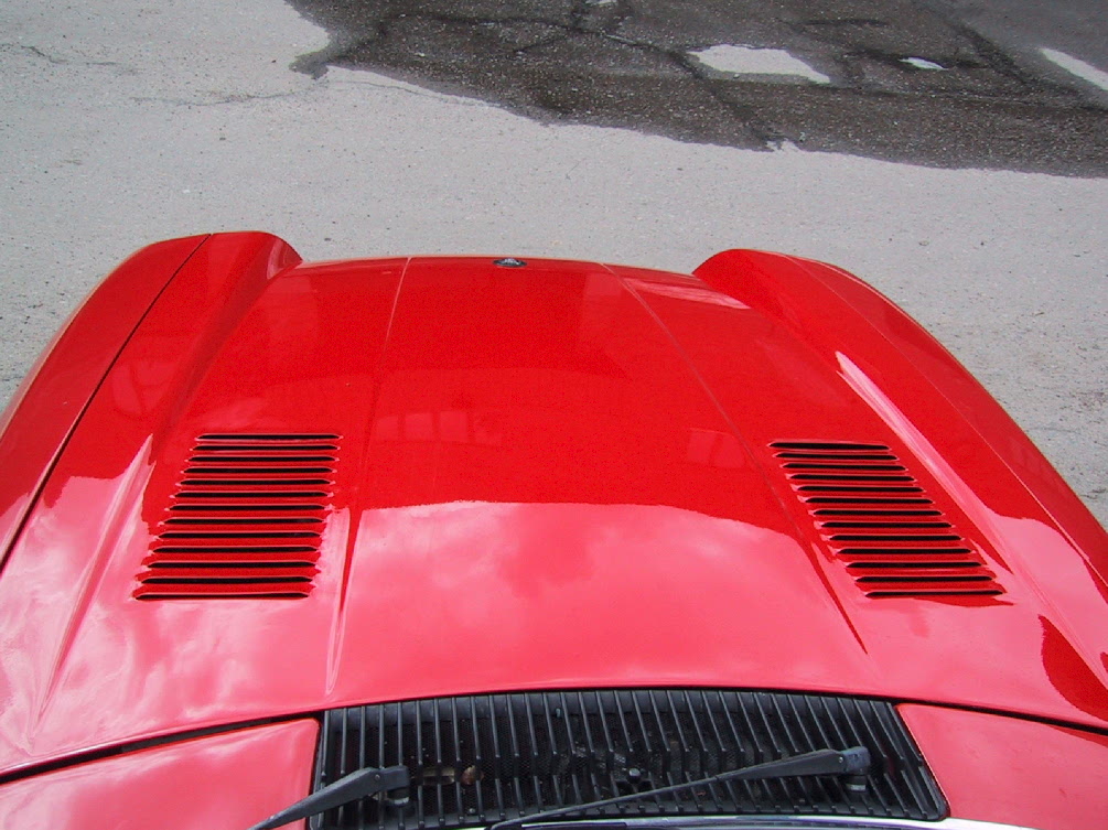

hood louvers are kool(pun), lousy pic of some i been looking at.

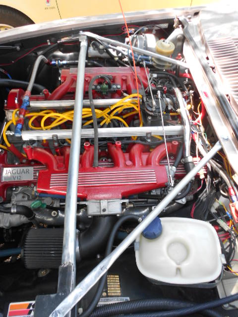

my modded cooling system with tank mounted high in engine bay,any air bubbles that may form in heads or anyplace rise to the top, and stay there as air space for expansion.

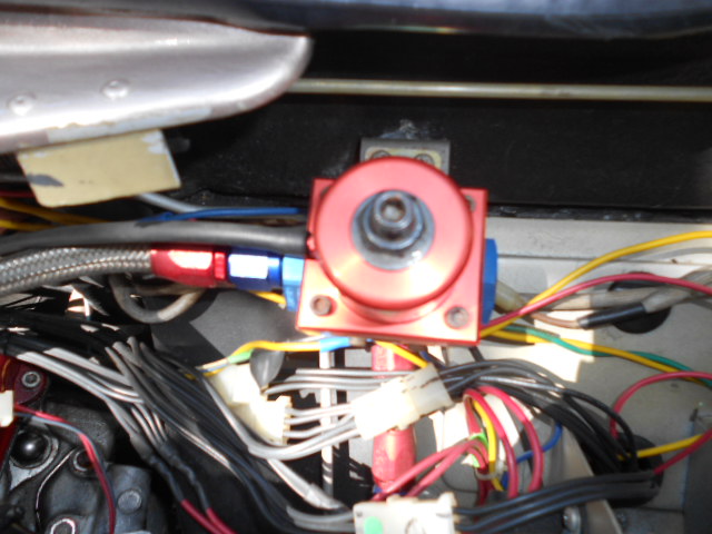

fuel press. regulator, pretty much like yours, XS aerospace product, along with my injector rails extruded aluminum, custom injectors,etc.

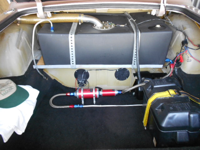

fuel pump in trunk with hi-capacity filter, oversize lines aeroquip.
two elec.fans, so far no everheats, with internal engine coatings of chambers and ports,+ piston tops.

Default trunk fuel system
it would help if i posted a pic,DUH!
Attached Thumbnails Custom Grille?-trunk-xjs-fuel-system-union-jack-001.jpg   Custom Grille?-trunk-xjs-fuel-system-union-jack-003.jpg

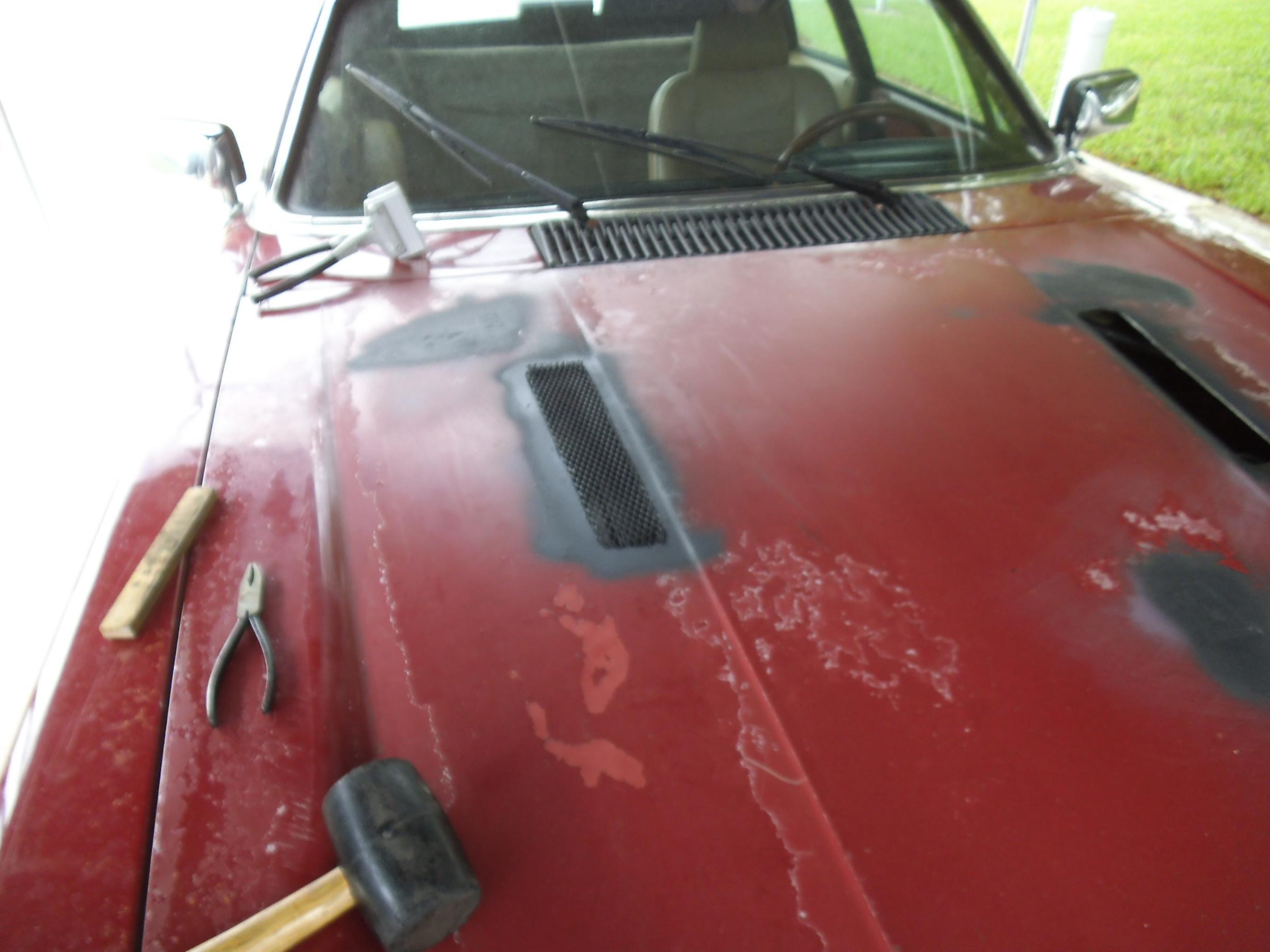

Here is a picture of the grill and the rough cut on the louvers. This is with a stainless square grill in the louver but I am using the existing pattern I used in the front grill and paint it black. This weekend I should have the drip trays finished also. Not enough time for all the projects! Im waiting to finish the louvers so I can do the body work. It is incredible the amount of heat that comes out of the louver.
Hector,
This morning I was reading an article on the 2014 Aston Martin Vanquish, in this month's Car And Driver magazine, and I couldn't help but notice the similarity between your hood vents and those on the new Aston. If you could find a way to add a long, shallow bevel all the way around the opening, the similarity would be down-right scary.

Ron, how did you make the louvers in your hood?

Ron,
Great car! Stole a few of your ideas, thanks.
Scott,
I just looked at the Aston pics, beautiful car! have to play the lotto today. Here are a few pics of the louver progress, I will keep working on the grills until they are flush with the hood. It seems this would be the best look. The rain guards are also coming along.

JameyXJ6 and JagZilla,, the car with the red hood is not mine,but one with louvers that i liked.
the gentleman that owns it had the louvers actually punched in by,none other than Grp44 racing, in Sebring fl., but i think they sent the hood to a sub-vendor to do the work!
44 has many contacts in the custom car building arena,(also airplanes).
his car is a true work of art,
specs ,1986 XJS coupe, late model 6L ,1994 model, full upgrade of EMS,ECU fully adjustable by his laptop, many mods for fuelling and ignition system.
big exhaust system, cold air inlets,alumnium radiator, big fans,ETC.

In looking at that great lover job, I'm thinking you would need to separate the top skin metal from the inside reinforcing layer of the hood to properly punch and press those louvers out, would definitely not be a simple job.

have you ever dino your car? Like your fuel rails, they look fantastic!, what type of injectors are you using?
That looks like a big pipe on the side.

It reminds me of the XKE's. I was wondering if there was a special tool or something to make them?

Yeah! it would be a big job,.
it takes a powerfull punch press, with dies that are shaped to the louver desired, for one off presses, it would be expensive!
he has owned the car from NEW 1986, when he bought it, he bought TWO XJSs,one for him and one for his wife.
i'm sure he got a few bucks,a very reserved gentleman, but knows what he is doing!
all work on the car was by professional shops, some in Fl. and some in Houston TX.
and son owns a ski resort in VAIL, so that says something.
i felt special when he said take the car out for a drive, it runs and drives perfect and plenty of torque when needed.
horsepower sells cars,, torque wins races.

HEP, the best dyno pull was at only 355whp, others average around 325-330Whp,at the wheels. tuning did not change much.
personally, i felt,for the mods done,results were not as favorable as i expected.
me being used to modifieng american V8s, that get good returns for basicly the same type of mods,.
jag V12 just doesnt have a hi-performance cylinder head, now if some one(with big bucks) would step up and cast a completly differnt head design, along with inlet and outlet systems,JUST maybe it could make some power!

injectors are Bosch style with O-rings top and bottom, much better than the hoses that original used, many jags met there end with fires in the engine bay, hi-pressure pump pumping fuel all over a hot exhaust manifold.
i just rengineered the fuel rails and injectors, and use the adjustable regulator to fine tune things! along with the adjustable EMS,ECU,of course!
