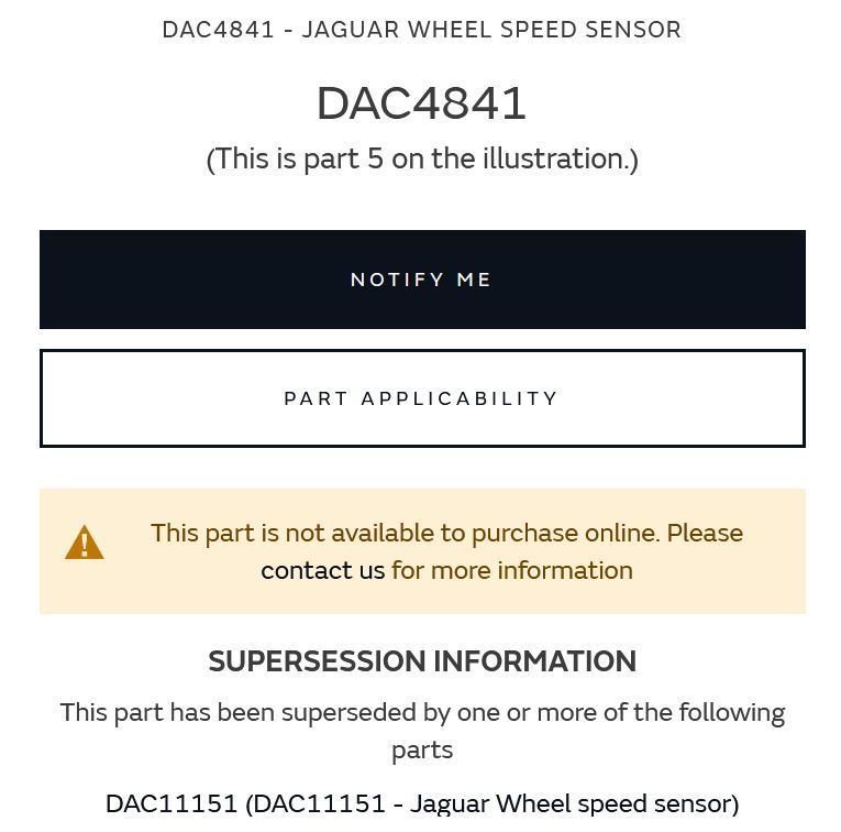

Old May 27, 2025 | 12:08 PM
clubairth1's Avatar
Community Influencer
Posts: 12,100
Likes: 3,371
From: home
I find that Jaguar has superseded DAC4841 with DAC11151. Not the other way around?
This is from Jaguar Land Rover Classic.
And they shown the DAC11151 as available and at a cost of 344 GBP! Pretty expensive for sure.
Terry Jags also carries this and it's even more expensive at $695!
