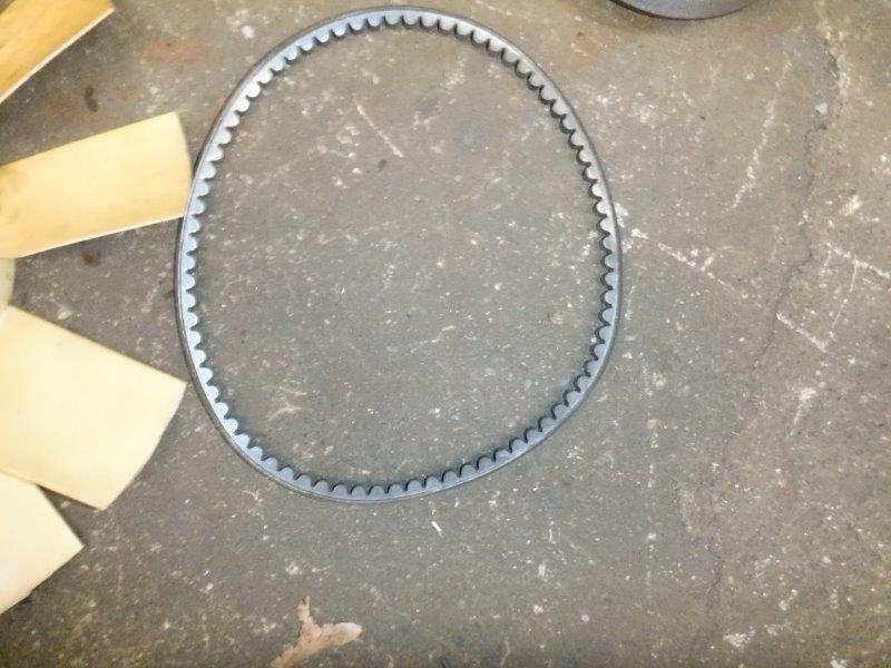

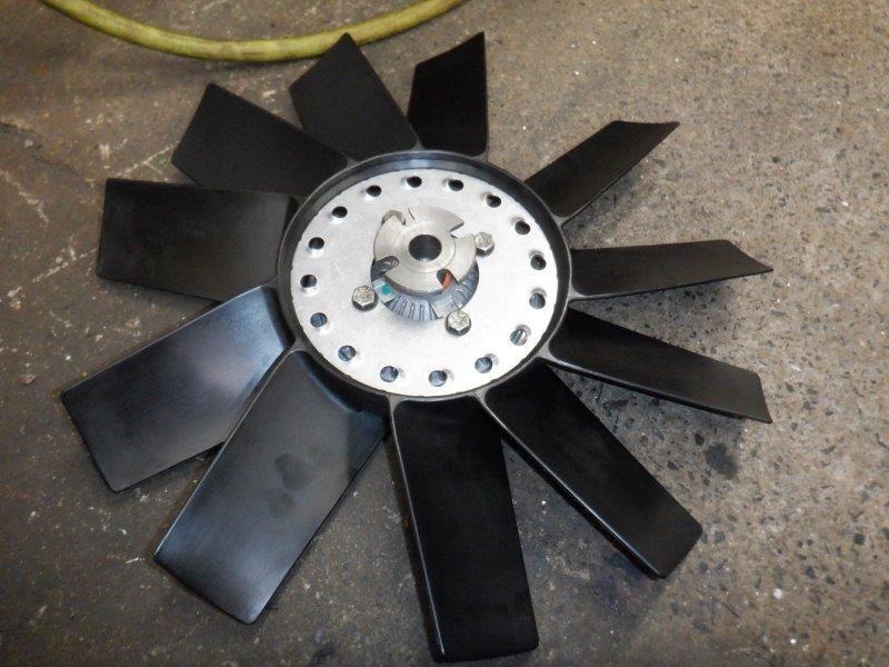

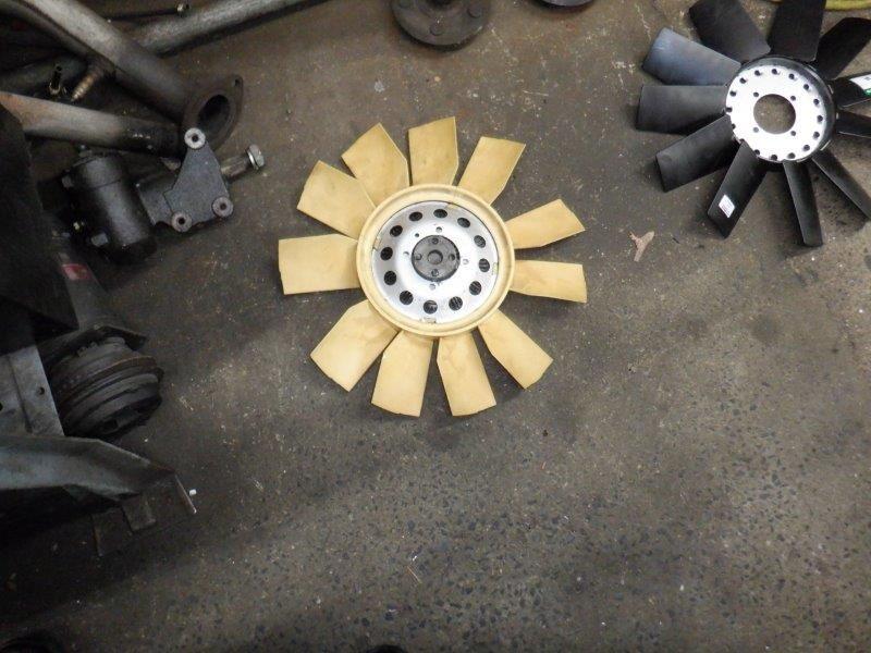

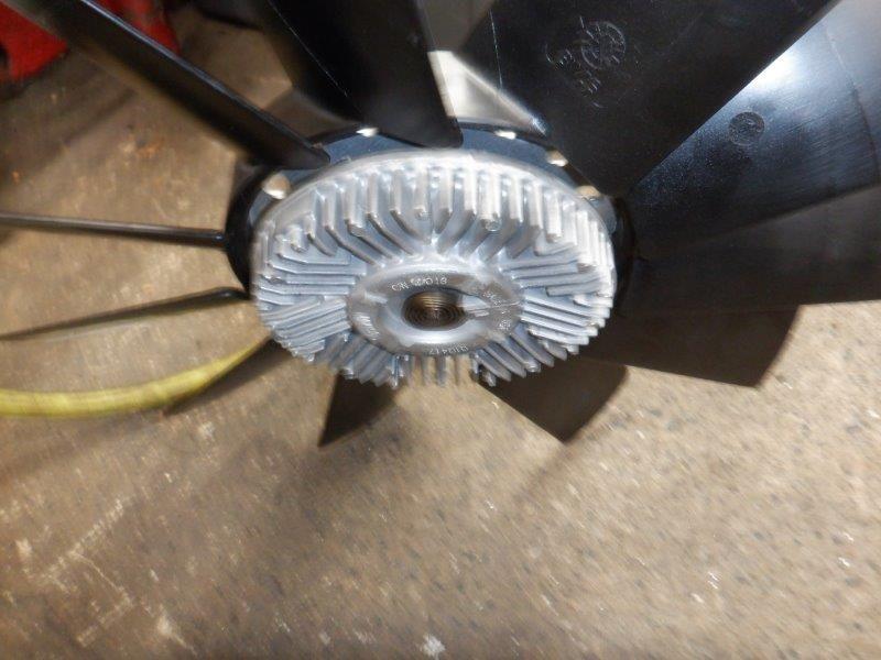

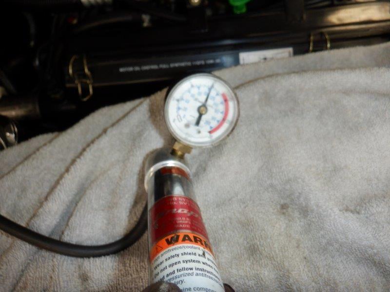

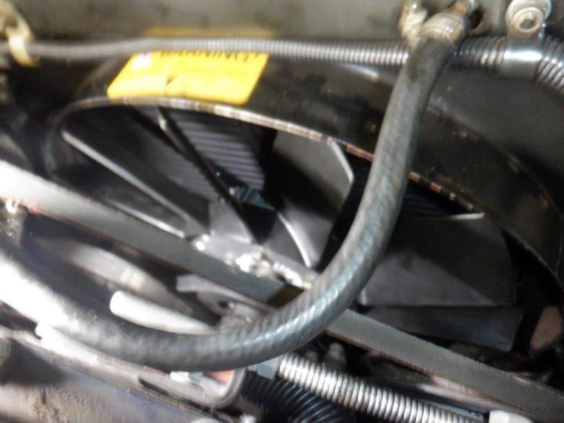

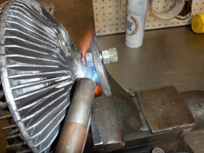

After inspecting the fan I noticed a few hairline cracks so I decided to change the fan, fan clutch, drive belt and pressure tested the cooling system. Took her for a little ride and put her back in the garage.

apart from siezed bolts (hence torch) was it straightforward?

Originally Posted by Mozambique
Nice work!
extremely easy.
