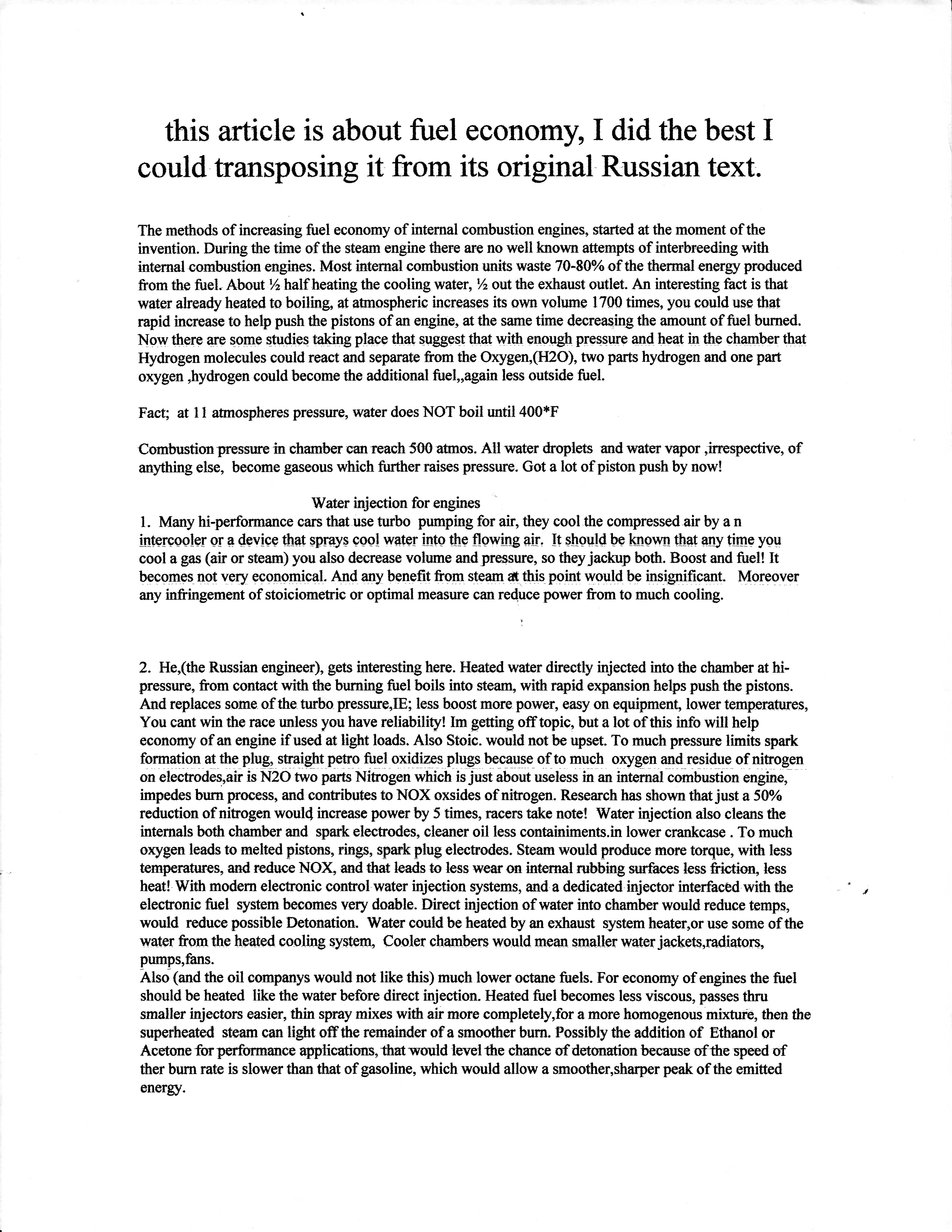

direct chamber water injection .
seems this theory has been around for some time , water injection.
but never injected into the combustion chamber, along with fuel injection!
article i have studied from about 8/10 yrs ago.
and FORD of Germany has jumped on board, so must be a viable idea!
pic old ,
pic old ,
Water injection to minimise detonation is well documented; I use it myself in a turbo 4 cylinder.
If i'm reading it correctly that page is talking about direct injection of water into the combustion chamber, as happens with petrol/diesel in modern engines.
I've no idea why you'd want to do that & think after that we're into the realms of pseudo science - along with the same old story of increasing fuel economy/ sticking it to the oil companies etc.

i think most here have missed the point of the article!
simply put , with the use of steam(Daim) to push the pistons instead of fuel it just may be possible to increase power as much as 500%.
he is using the water for the steam, the combustion of fuel is to boil the water into
steam! expanding the pressure 1500 times slowly and piston pressure lasts way beyond petrol pressure in crank angle degrees! =read torque.
read it and think about it.
as far as water injection into the inlet manifold , i was doing that in 1962, so wasnt OLDSMOBILE, it helped some, but saved engines a lot.
my Mazda Rotary , made 100whp more with manifold water /alky injection.
from 420whp petrol, to 510whp with water /alky.
but direct water injection could make 1000whp, if the internals can handle it!
RON

Steam replaces air as a gas. So if you have your normal fuel and air in the engine before ignition or even upon ignition, and inject hot water into the cylinder, you may extinguish the flame from the spark. At the same time, should any steam actually be formed, it would force unburnt fuel away from possible ignition areas. Resulting in no ignition. So it would cause a reduction in power...
The idea of H2O turning into H2 and O under pressure doesn't actually work. No matter how much heat and pressure you put into this, H2O stays H2O. Either in vapor form or, when hot enough, in plasma form. The only way to separate H2 from O is either via electrolysis (or how ever you spell that - it is just 1.13 am here as I am writing this) or giving it a different material it can react with... And hydrocarbons (aka fuel) isn't that reactive to H2O...
I think still, the best way for a steam engine to work properly and efficiently is to have an external steam generator... But this is going too OT. 'Tis is the XJ-S I6/V12 forum... Not 'steam my Jag' or so
think a little deeper, Wiki,, superheated steam, or dry steam!
saturated steam can be seen, but superheated steam is invisible to the human eye!
also very dangerous.
good thing we can not seperate H20, two H, 1 O
the earth is made up of 2/3rds water , could make another Big Bang thing! spooky thought.
No need to tell me about steam there buddy!
Compound steam engines, steam turbines, steam generators, wet steam, dry steam, ... All my sad life and luckily partly something I now deal with in my new job
H2O is easily split. You can do it at home. Heck, you have a 12V DC battery in your car... You can do it with that!
Big bang is rather not the issue, more so fission... i.e. what the sun does with it's H accumulation, turning it into He. Though fission is the future... The first reactors have managed to sustain a constant H fission... Combine that with a possible new developement in nuclear technology, tnurning He into H and you have a never ending power supply formthis planet... H+H=He. He/2=H. Oh, and use it to heat water... So back to steam
Another bad physics example. Energy out is less than energy in.
