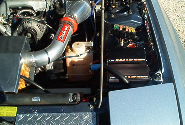

i know you dont know that 1962 OLDSMOBILE F85 with all an aluminum V8 Turbocharged had worlds 1st production car ,water/alcohol injection system,(worked on one,nobody including dealer would touch it).
and lets not forget the GMC TYPHOON Turbo, water/alky system,factory.
seems there is more to it than you realize!
pic of an old system with resivoir, did well on this car., look close and you see the resivoi on Mazda.
Attached Thumbnails direct chamber water injection .-20170725_114133-2-.jpg   direct chamber water injection .-20170725_114223.jpg   direct chamber water injection .-good-pix-old-yellah-001.jpg   direct chamber water injection .-mazda-rx7-002.jpg   direct chamber water injection .-mazda-jaguar-008_new.jpg

the systems do work quite well in cold weather ,alcohol dont freeze!
