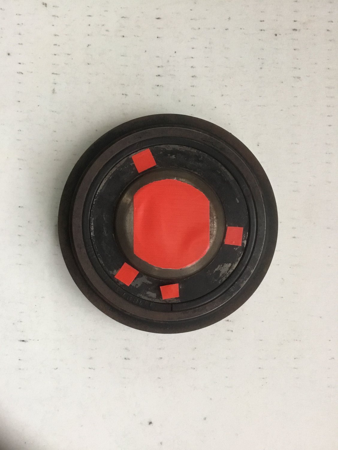

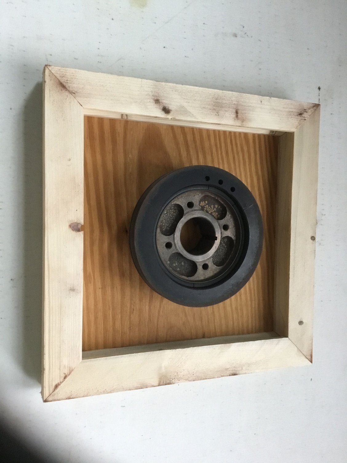

Been wanting to eliminate the squealing damper noise that sometimes occurs at startup due to the failed rubber between the crank portion and the pulley drive ring. First I started to build a form box to cast a plaster mold of the assembly for future reconstruction.
I blocked all tappings, roll-pin key and center hole to prevent entry of any materials.

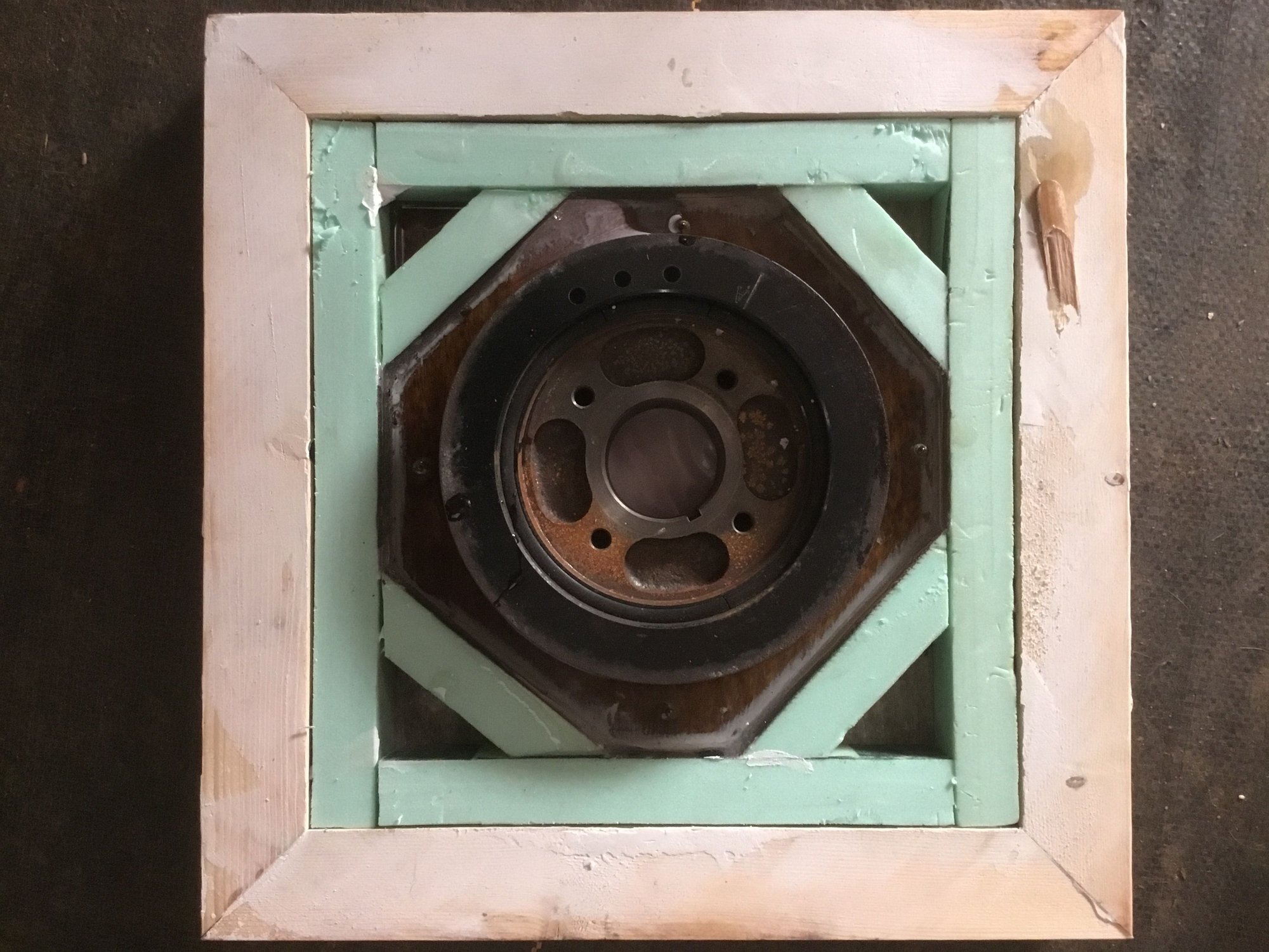

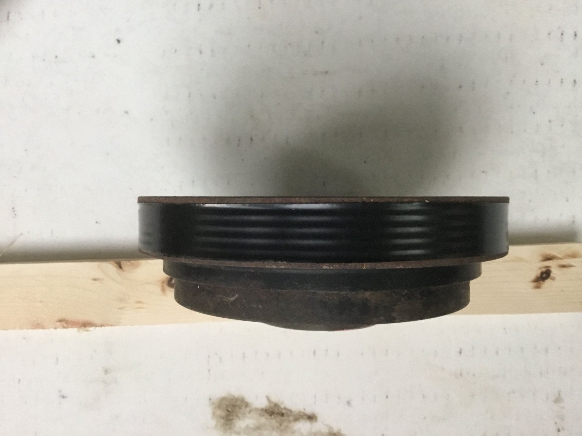

I made the tray just deep enough to form up to the bottom edge of the accessory pulley.
After trying a fast setting plaster type of compound I was not satisfied with the results so a turned to using a two part epoxy.

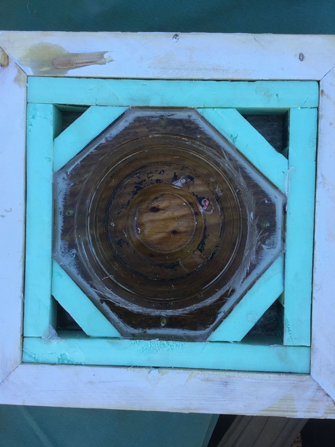

The reason for the foam inside the form box was to reduce the amount of epoxy needed to make the mold. Here it is cast.
This is the finished casting for setting up the damper.
It is now ready to receive the parts and have the new rubber injected.

One note is that the epoxy could only be poured in 1/2" lifts, so I used 4 screws set endwise in the bottom layer to help key the second pour of materials in case there was any tendency for them to separate. Shouldn't be but just in case.
