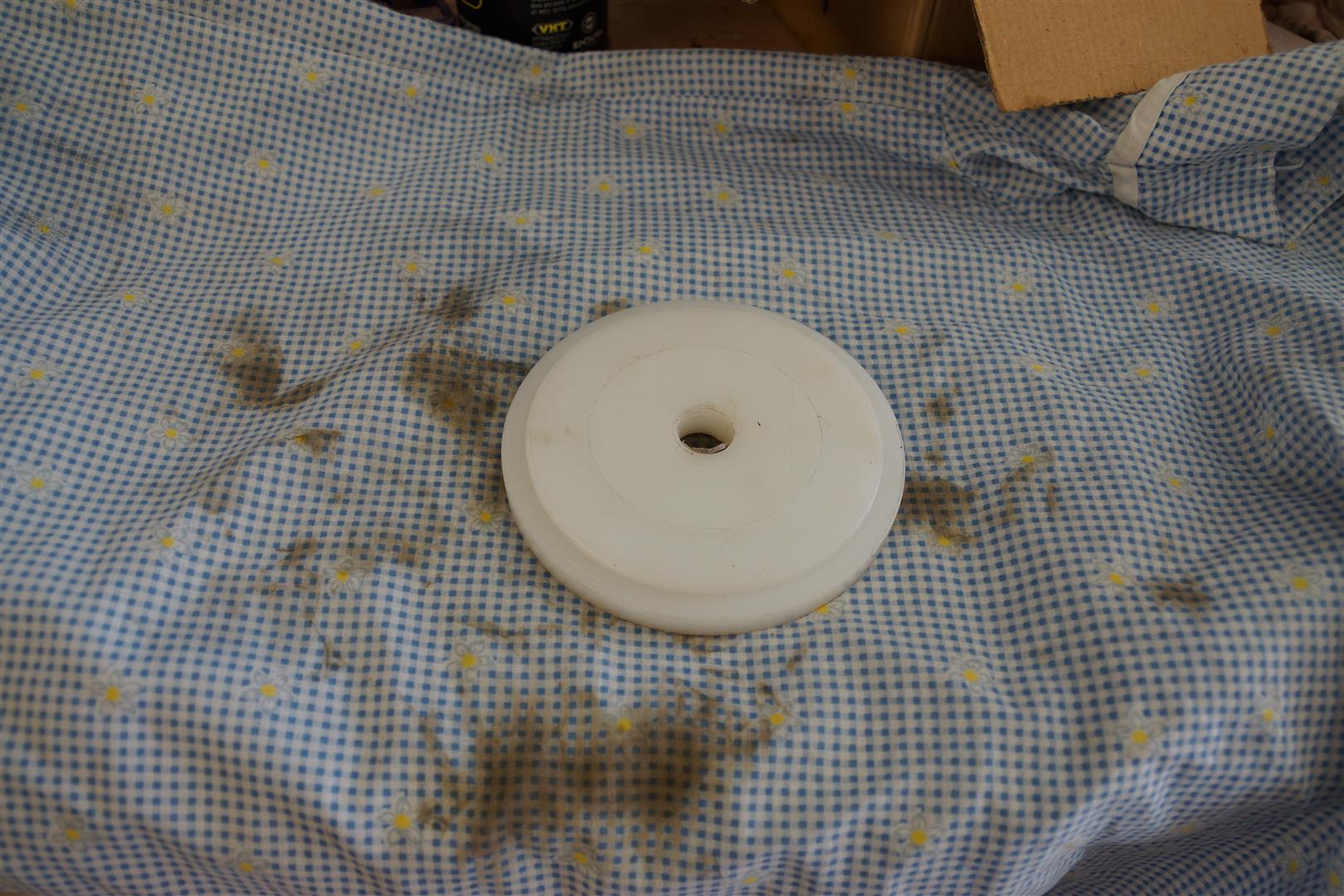

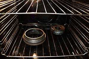

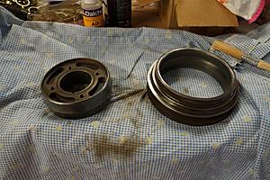

The jig is simply a nylon disc turned so the outer diameter locates inside the outer section of the damper and a machined step locates the hub in order to keep things centred. Damper parts were cleaned up by a light sandblast then primed with urethane primer. preheated as per instructions and urethane mixed and poured into cavity. This was then cured at correct temperature.
Have had no problems with it for some 4 years since the rebuild.
(Please note the parts of the damper shown are NOT same way up.)
