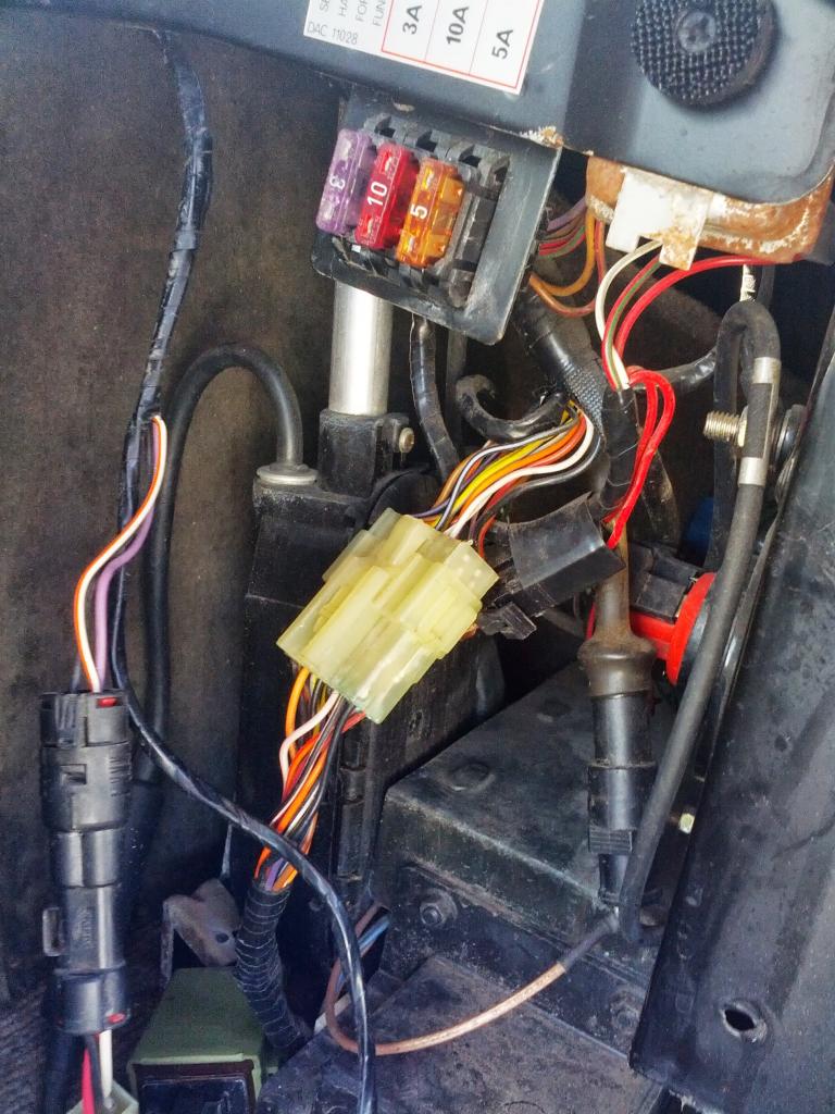

On the earlier models the control unit sits behind the right hand trunk side panel. A box is fixed behind the rear light and has cables that go to a big white cable connector
Link to programing remote
https://www.jaguarforums.com/forum/x...emoval-128608/
