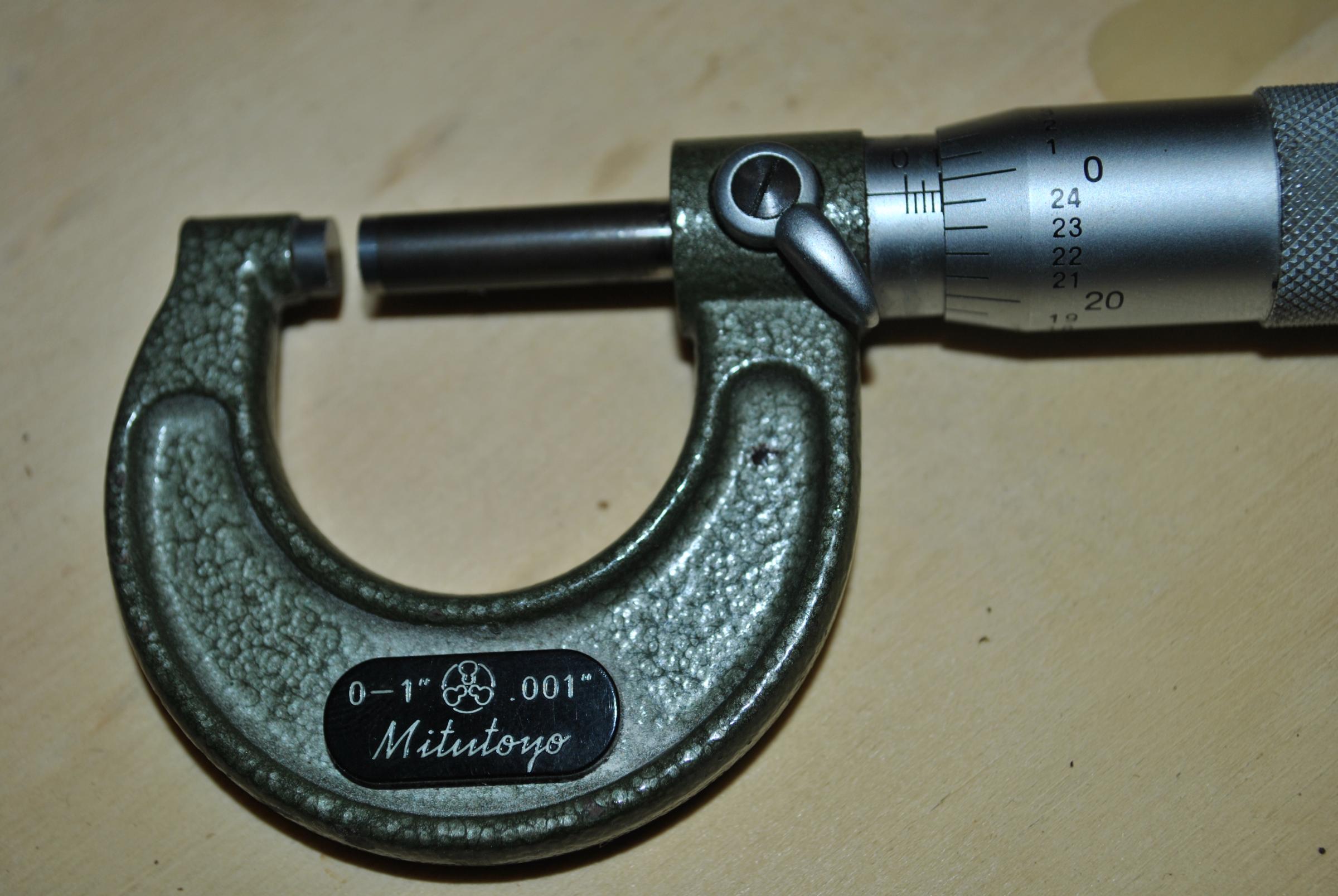

I have a no-name ebay caliper for throwing around the garage doing exactly the kind of job you are.
But for work I only use Mitutoyo calipers and micrometers, both metric and imperial. I have had my work ones since 1983 but they cost me 2 weeks wages(apprentice pitance) for the set of four back then. And still use them daily 32 years later.
I keep this washer on my work key ring that caused $25k damage to a multi million dollar printing machine. It reminds me that not everybody calibrates their tools correctly. An extra 5.9 thou (0.15mm) an a machine with 3 thou(0.075mm) tolerance can cost you your job and your employer a migraine.
Drooping Exhaust Problem (XJS V12)-dsc_1529.jpgDrooping Exhaust Problem (XJS V12)-dsc_1530.jpg
But for home use the cheap ebay tools serve the purpose.
