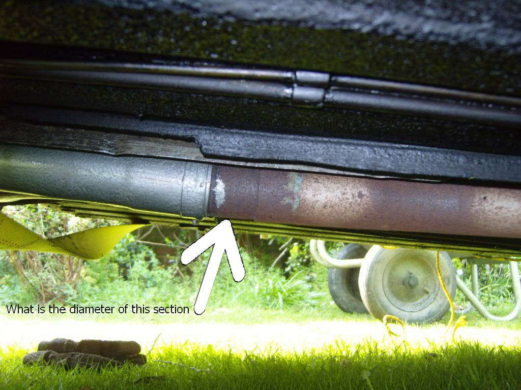

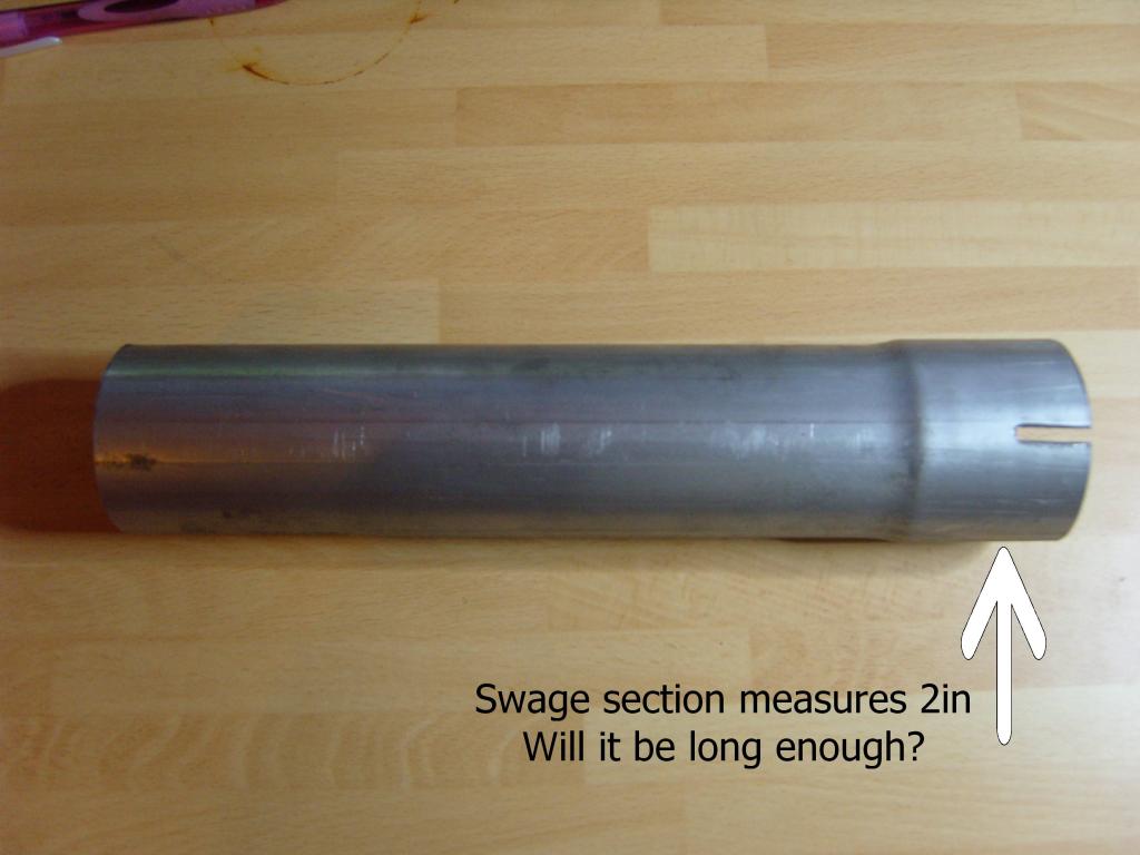

I've just received the extension tube, which has to be cut to length but what is concerning me right now, is the length of the Swage, which measures exactly 2 inches.
Its much too dark to offer it up for a trial fit right now and no room to do so, till I get her out of the garage and tomorrow they forcast Rain!
I would have liked that Swaged section to be a little bit longer.
But what do you think Guys, do you think the Swage will be long enough? as without looking, I am not sure how much of the exhaust pipe is already tucked into the existing Swage section, as it needs to be pushed right home to take out that 'Droop'
P.S. I already know the diameter 54mm (Thanks 'Grant')
Does anyone happen to know the rough length of the Swage on a Standard Exhaust?

The swage will be long enough providing you use a decent clamp, preferably one of those ones a bit like a heavy duty jubilee clip with a bolt pulling the thing together, rather than a U bolt type. Plus a spot of exhaust putty.
It might be worth testing the rusty pipe to be sure it is really strong enough to take the dis-assembly and re-assembly, rather than just crumbling under the effort. Good luck though, but when is the covered space going up? That's what the autumn is for!

But looking on the Brightside, the repair piece is 'Spot On' at 54mm!
(Well done 'Grant!')
Although the other end is such a tight fit, that once I hammer it in there, I will never get it out.

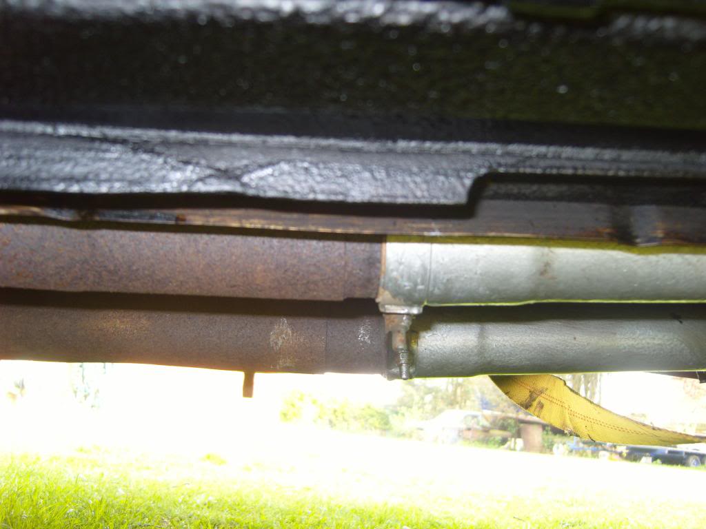

After getting Paranoid that the Exhaust was about to fall off, last Summer I wired it together to try and ensure that it didn't hit the Tarmac if it did.
And while I'll admit to bodging it up, this year I decided that I would try and do a better job.

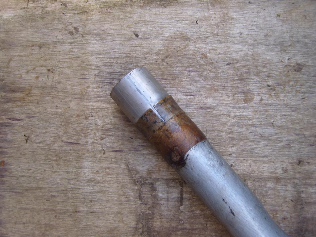

So first I obtained a 54mm repair piece with a Swage at one end, then cut it to length and hammered it into the Silencer.

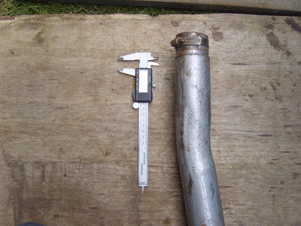

Then Trimmed up the Straight Pipe to ensure a perfect fit, using a hose clip, as a cutting guide.
Together with my Caliper which I used to measure the length, which was only a Tenner from ebay and has now proved so useful for all sorts of things, that I'll never know how I ever managed without one.
Using a Hose Clip as a cutting guide.

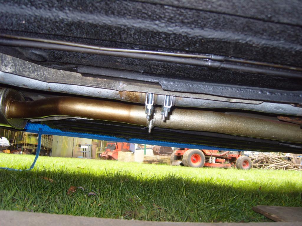

After which I bolted it back and then made some final adjusments, before clamping it together with two 60mm Exhaust Clips.
Job Done, good to go!
Before:
After:
