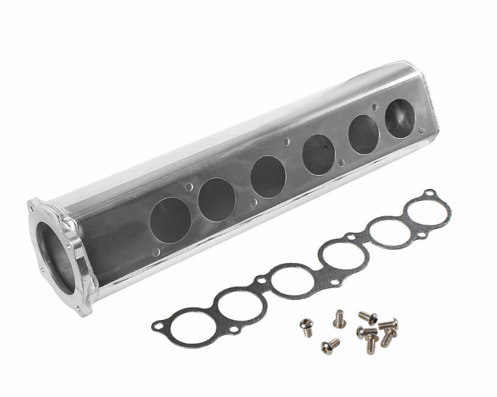

For a central plenum with twin turbos I was thinking about doing something like this:
would hopefully make use of the space left by smog pump and p/s, alternator might need to be moved... somewhere
I don't intend on copying the blow off pipes through the hood though that's for sure, I'm not sure if you can call a build that started out as a sports car a sleeper but I do want to avoid mutilating the bodywork where possible, although some fender mods might be in order to squeeze in a little more tire
as far as headers go I think they're silly on a turbo car anyway, they're worth it on NA cars just for the sound though... I was thinking about doing essentially just a large pipe with a flange for each exhaust port and the pipe mounts directly to the turbo.. not sure if that's ideal for flow but it certainly is simple
pretty much like this.. almost seems too simple to work well though
Old Mar 26, 2025 | 10:43 AM
Mguar's Avatar
Joined: Aug 2019
Posts: 1,240
Likes: 426
I should have taken pictures of my twin turbo set up. Sorry I didn’t.
Here’s what I found out though. Back pressure kills the engine almost as much as heat does.
Forcing air though a intercooler, adds a lot of back pressure. (How much depends on several factors such as size, inlet & exhaust tubing size, bends & curves. Involved etc. the best intercoolers tend to be the big bus sized ones. But those block the radiator from doing a good job of keeping the coolant temp down.
Don’t fall in love with any one number if you want things to last. I hate to say it but moderation is really the key. Almost never will the very last bit of power/boost/ or anything. Be the end all. I vintage raced with the same engine untouched ( other than regular maintenance) for over 20 years. The car got faster and faster over time due to me learning the tiny little things it takes to be good.
Those who built hand grenades wound up spending so much time and money working on it they became discouraged and never did learn the little things.
Personally welding up a manifold doesn’t gain enough to offset the time invested. that’s hours worth of work with risk of failure the way you are suggesting.
You don’t want a really big turbo. It takes too long to spool up so it will feel sluggish. Two smaller ones spin up much faster. And peak power is very close. Plus then it’s really easy work to go to a bigger pair of bigger throttle bodies.
Besides peak power typically doesn’t get used much other than on the dyno. ( primarily for bragging purposes. And never on the street.
Even if you have a long empty road, it’s hard to use the full power of a well tuned twin turbo engine.
Only on big long tracks like ELKHART LAKE ( a 4 mile track) there are only 3 spots where if you have the exact right gearing you can reach full potential. And there, someone even momentarily blocking you, you won’t achieve it there. Nor if you take a slightly off line exit.
I used to use a fractionally taller gear ratio so that if another fast car was ahead I could tuck into his draft and use the tiny bit left to pull ahead and pass.
Winning is a mental chess game. Where things like that make the difference.
I digress. Use a pair of stock intake manifolds ( with bigger throttle bodies
from the throttle body go forward through the inner fender, 90 degree bend to the rear and straight into the turbo.
The stock exhaust manifolds join together and then goes up underneath the inner fender and into the Turbo.
Such a short length from the turbo to the throttle body will ensure it doesn’t pick up any engine bay heat. With only 1 bend in the system. Back pressure is at an absolute minimum.
As will be heat pickup and the heat gain from the turbo will be easily dealt with by the alcohol in E85.
