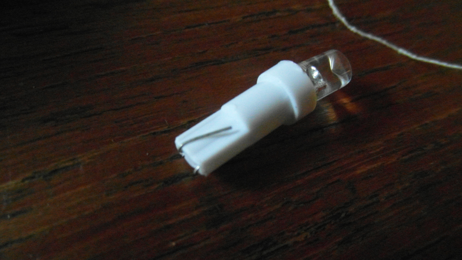

I bought the same bulbs that SouthernGypsy advised us to buy from superbright and they do have resistors in them. I will check to see if the bulbs from China have resistors or not. If you look at the picture posted by SG (I'll try to post it repost it below) you will clearly see that he is using the bulb holder from superbright and not the original holders from Jaguar. I will try what you are saying. If anyone with my style XJS has done the mod then cam you please state how you got it to work?
Thanks,
Jomo

I tried just pulling out the light (or whatever it is called) from the bulbs from China but the whole assembly comes out with it. I think that you are saying that these bulbs are like some of the side marker bulbs-with the wires on the side and when you push the bulb into the socket it makes contacts with the bulb holder. These bulbs are just not that way. Check out the pictures of the bulbs on the websites. https://www.superbrightleds.com/more...-led/223/1037/
and Wholesale Product Snapshot Product name is Free shipping 10XFree shipping Car Auto LED T5 B8.5D 1 led smd 5050 Wedge LED Light Bulb Lamp 1SMD White/Green/Blue/Red/Yellow

just had a quick look , and yes, that is a whole complete lamp
you should pull the complete unit from your dash , and twist in this LED unit....if they don't work then turn them 180 degs , if they still don't work , get ur money back

BB, In theory the bulbs work as all you have to do is give them 9 volts or more. I tried each and every bulb with a 9 volt battery and they worked. The only time they will not work is when they are not given any volts like when they do not make contact with the circuit board on my dash board. I would have returned all of them from SuperBrite but I removed the inserts to put into the original sockets as that was what I thought you meant after realizing that just the bulb did not come out and now they will not take it back,

Thanks Greg, that's kinda what I figured.
I was really careful the 2nd time to make sure that all that contacts were good and the cleaner had several days to dry before I refitted it.
I did notice with the LED bulbs that if the two wires were not exactly parallel to the body of the holder then they wouldn't make contact so no circuit.
I'm going to take it apart again just to see if I can get the temperature gauge to move as it is stuck in the middle at the moment for some reason.
Attached Thumbnails Easy Solve found for dim Warning/Indicator Lights!-004.jpg   Easy Solve found for dim Warning/Indicator Lights!-002.jpg

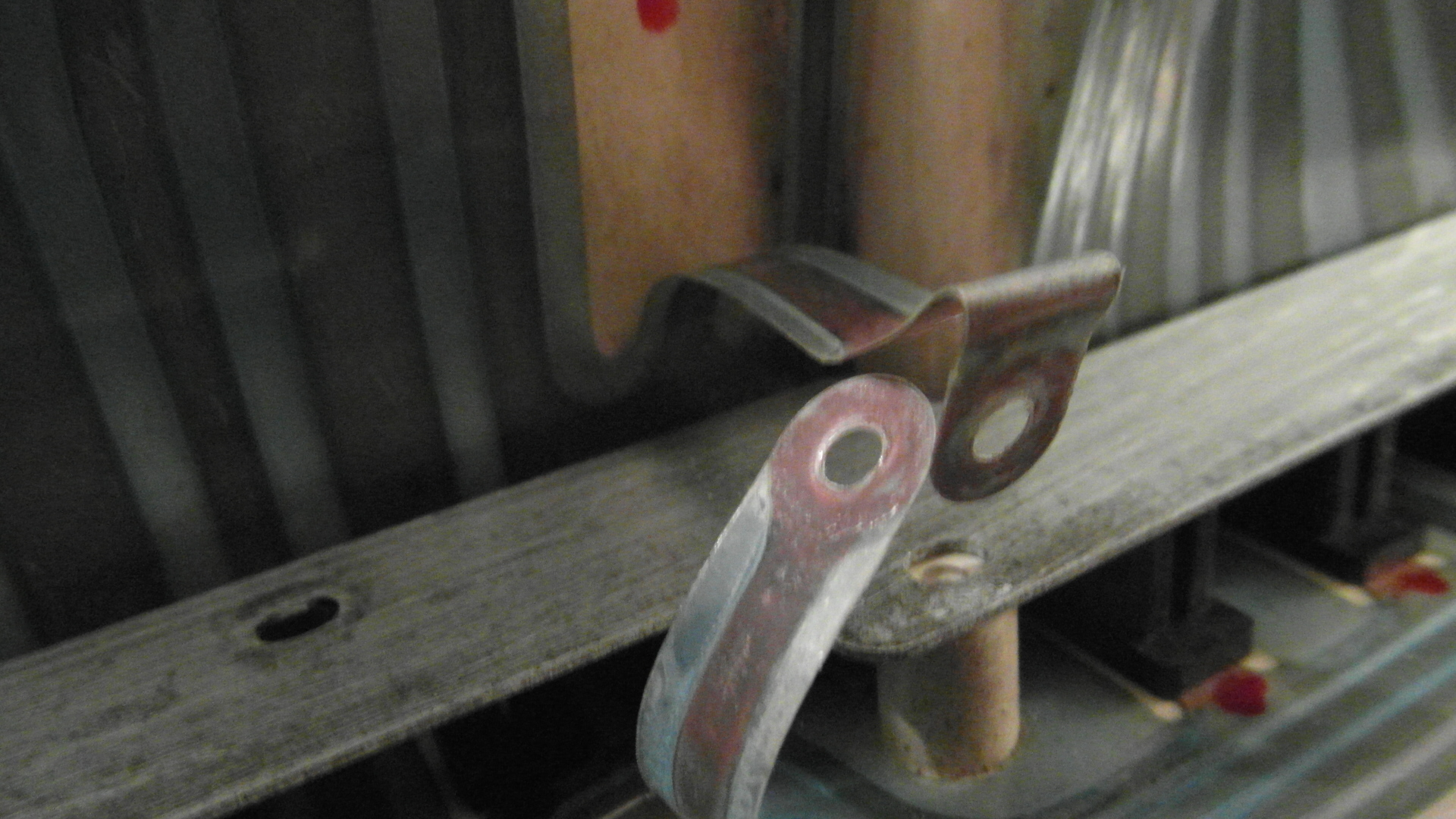

Ok, a bit of improvement.
The temperature gauge is moving freely now, I had somehow managed to bend the needle slightly whilst refitting so it was sticking to the gauge (finesse has never been a strong point of mine, think'bull ' and 'china shop').
Had a good look at the connections to the earth strap and removed the folded over one with the additional one sleeved in (photo 1).
I had refitted it with both sections on top of the bar but (much) closer inspection revealed that the folde over feed is plastic coated on the top all the way round so when fitted as I did (photo 2) it wasn't making contact.
It should be folded and fitted beneath the earth strap (photo 3) not on top of it; the extra feed can go above or below as there is no plastic on either side.
Have to wait till Wednesday now to see if it works.
Be prepared for a tantrum!

Steve
That is EXACTLY the thing that I did, and tried to describe in my last post! I trust you brightened up the copper with some fine grit paper ? I did the bent needle bit too! Congrats
Greg
