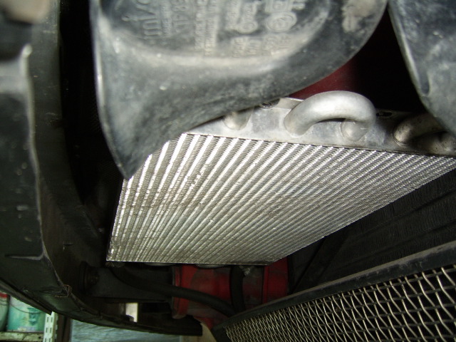

HA, Part 2.
The foam missing is no biggie, just heaps of HEAT transferred into the cabin from that area, and I mean a HEAP. There is still heat getting in with the standard foam, and the newer stuff, so the engine bay heat exiting via that area is enormous.
This, I theorised back in 1994 with mine, and when the engine was out, and the newer, thinner insulation pad fitted, I did notice less heat in that general area inside the cabin.
I used a material that the "hot rodders" use, and then a thin aluminium sheet that I profiled to "pop in" and hold it all in place, AND, give a very smooth surface for that engine bay air.
Also remeber, I removed the trans cooler from the radiator, and fitted a standard V8 spec air flowed unit under the front bumper bar rubber.
Then, just for giggles, I removed the V pulley pack from the crankshaft harmonic balancer (4 bolts), and had the first V removed, no going back now, and less weight, more speed, sweet.
Over the years I continued to do little things here and there, and kept few snaps, as I never thought anyone would be interested, and no digital cameras then either. Its all in the brain, haha, and I will keep putting it all to Word, as I get time.
Ask away if something is "missing", as I do tend to assume too much at times, and need to be TOLD regularly, and that is what wives are for, NO???.
If I think of anything else I will add to this.
