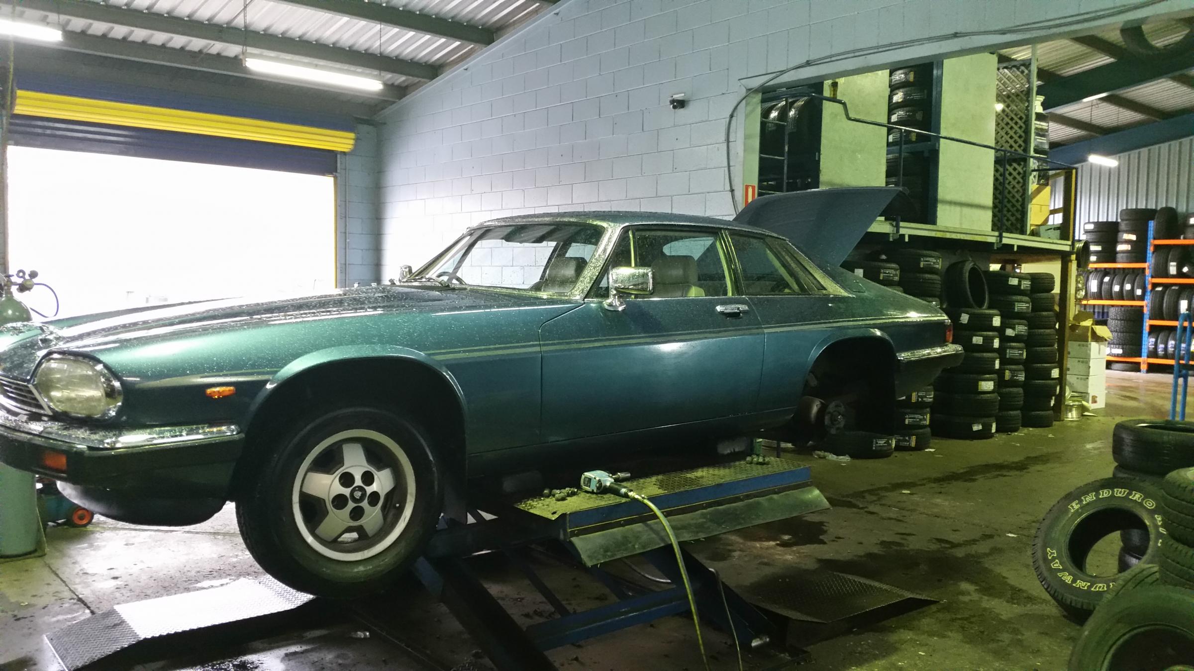

Originally Posted by Grant Francis
Also mentioned is a blocked return line, COMMON enough. Not blocked, but crushed by errant tyre fitters using the wrong jacking points. Look under the LH side of the car, you will see a metal pipe about 10mm diameter, running the length of the car. That is the fuel return line. Look around the front jacking peg, and see if there is any crush damage.
Then look in the same area on the RH side, as that pipe is the "supply" pipe, and also gets damaged.
Paul,
I dont want to be a wet blanket, BUT, that scissor lift worries me a LOT.
Have a CLOSE look under the Goose at the panels. There are fuel metal lines in that area. The RH is the SUPPLY, and the LH is the RETURN, and those lifts have been known to crush them, so NO broom, broom.
ok if the operator puts the rubber pads in the correct places (HAHAHAHAHA), but most have NO idea.
Found both of these pipes damaged on Paul's "Blue Goose" this week, but not crushed enough to cause a problem. About 2/3'rds flattened.
