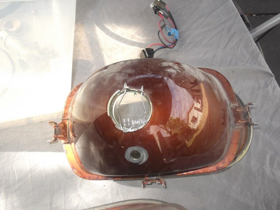

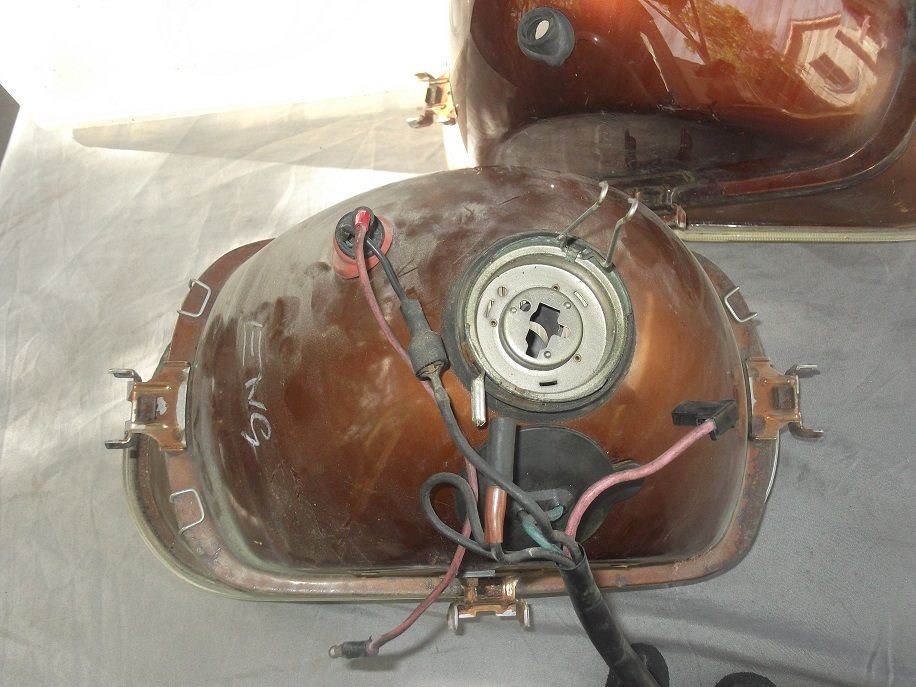

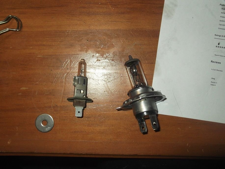

Once you have figured it out - can you please write it up - this is on my to-do list which I have procrastinated on for some time because they were difficult to get out
I also noticed that my lights are different, so I must have an old type and a newer type, which I have been scratching my head over as well
2 different light bulbs
Part number is correct for this type, have 2 light bulbs each for low beam and high beam
Part number not correct for my year

there should only be one bulb for the hi/low beam, the bulb to the right looks like what I have for my fog lamps. as for the lights they look right, but not sure why there is what looks to be a rubber plug on the bottom on the one. Here are the numbers from mine, they should be the same as yours Right 480394 Left 490393. Getting mine out wasn't a problem, but now that I have found a replacement for my left one, I decided to re-install them for a bit just to have a change in looks, but they are a pain to get back in

Early cars use 2 single filament H1 bulbs, while later use the dual filament H4.
Mine had new headlamps mounted in 1989, so I use H4, and the H1’s I had bought according to the user handbook is now sitting on the shelf...
