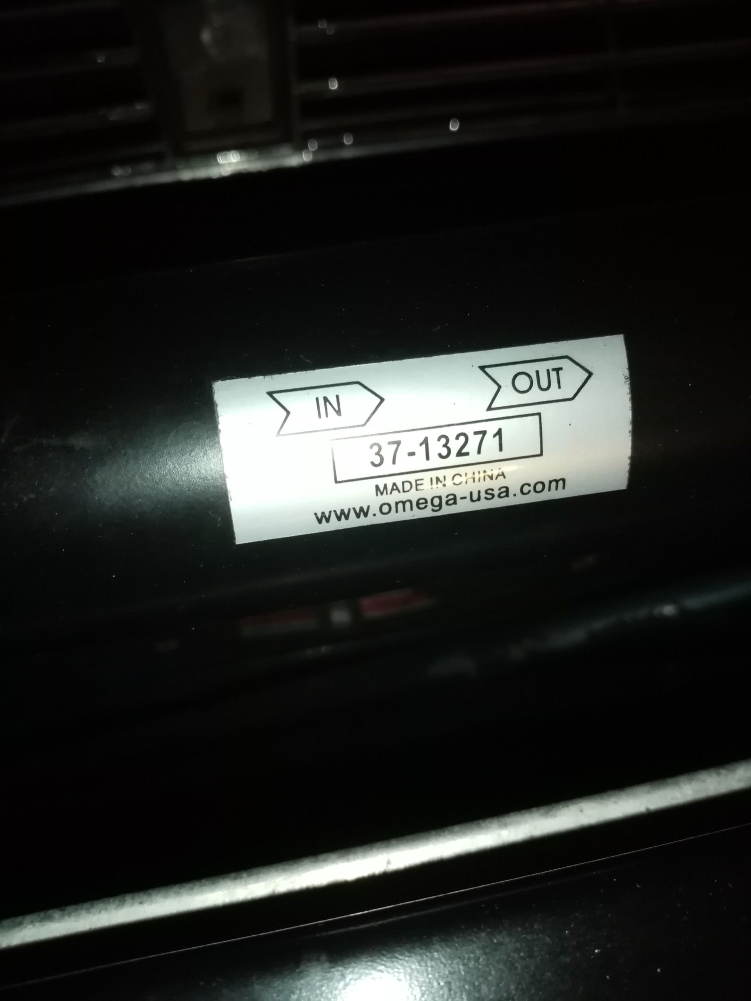

I have a 1996 Jaguar XJS and I am planning to replace the drier (and the TXV) in an effort to correct an A/C problem, but that discussion is in a different thread.
I have the Four Seasons 44392 drier, but I do not see an arrow indicating which way to install it. It does have a sight glass! Does that mean the sight glass should be on the outlet end?

Four seasons shows a part number of 33492. Mine is plugged no glass but, has a label pointing to it as the outlet.

I have an omega dryer and the sight glass is on the "out" side on the right, should be exactly the same as the 4 seasons

Sight glass up, right?
Old Aug 19, 2023 | 09:54 AM
Greg in France's Avatar
Posts: 14,588
Likes: 10,783
From: France
Right.
