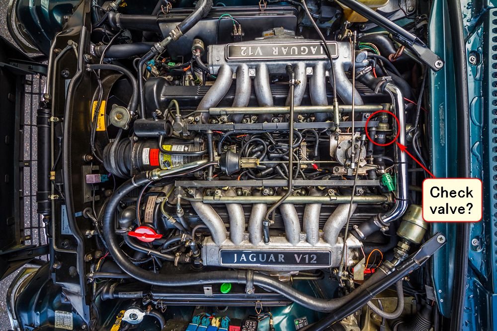

Do I have air injection? Good question. How could I tell? I do have an air pump that comes on when the engine's cold. Where would the air injection check valves be? Back centre... where? I'll take a look when the car gets back.

You do have air injection, I can see the air rails in your photo of the air filter element. The check valves are at the very back of the engine, between the engine and the firewall if I remember correctly. There is just enough space to get the needed large spanners in there. They are a standard GM part, used on many cars in North America, not that that is of any use in Japan. You won't be able to tell anything by looking at them, but if they are original probably worth changing on general principals.
Part Number 9: https://www.jaguarclassicparts.com/u...alve-5-3-litre
The common size is 5/8" hose, and from some digging in the parts book and cross referencing, the valve is the same as this one: https://www.rockauto.com/en/moreinfo.php?pk=40788&cc=1037315&jsn=797
If you need an application, it's the same as a 1992 Chev 1/2 ton truck with the 5.7.
The air injection system puts extra air into the exhaust on startup. This is get the catalyst up to temperature faster. The air injection ports are right into the cylinder head, you can see the yellowish metal tube on each side of the valley of the engine, runs parallel and outboard of the fuel rail. The check valve is to prevent exhaust from going back into the air system.

Ah-ha. So they're the pipes that run parallel to the fuel rails, then? And there's a cross-over at the back with a black rubber connector. Is the check valve located correctly on this photo of my engine?
Thanks also for the detailed writeup on what goes on with the air, and the links to the parts. Weird how it shows different choices for different markets, yet it's all the same part number. The hose would also need changing, then? Probably wouldn't hurt, anyway....
For what it's worth, I agree with your hypothesis about no warmup enrichment being supplied, so fuel values are close to standard. I seem to remember reading something about coolant temperatures being the controlling factor.

Yes, that's the check valve. There is one on each rail, so under the green connector should be another. The Hose is NLA, but I'm sure something could be made up if the old one is fossilized. Try and save it if you can to make life easier.
