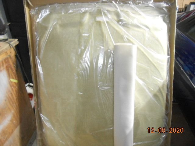

In 2019 I got mine from Myrtle as well and all the predrilled holes lined up properly.
85 XJS coupe fiberboard headliner from Myrtle Ltd.
