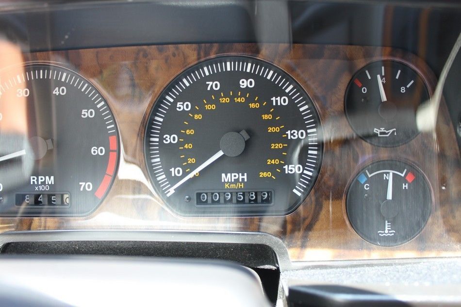

Been lurking since I bought my first Jag in August. 1995 AJ16 with 9,600 miles. Have the service records and even the original window sticker. The elusive little old lady from Pasadena car. Spent some time on brakes and general maintenance. Put 3,000 miles on it in the last few months and it just keeps running better all the time.
Sorted through it with the help of this forum but couldn't find how to take out the headlight bucket. There is condensation and I want to pull it out and clean and seal it up. Any help would be appreciated.
Some pics.
