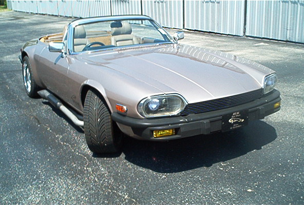

Old Sep 19, 2013 | 11:52 AM
ronbros's Avatar
Joined: Jul 2010
Posts: 7,362
Likes: 1,241
maybe more tire noise than rotor noise! wide tires can be noisey.
