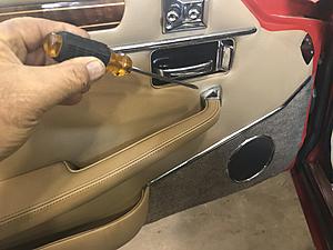

I have a 1989 Jaguar XJS. I would like to remove the front door panel. I have attached a photo and am pointing at the chrome metal cover on door handle that I believe needs to be removed. Once removed there is a screw behind it that needs to be removed. My problem is that small metal cover does not seem to want to release. I can wiggle it but that is all. I am afraid that I may rip my door panel material. Is there a special way to remove this? My objective is to remove the door panel. Can anyone help?

You're right, it will be tight but you just need to carefully wiggle it back a bit just a little bit to expose the screw head. Try gently pushing in the leather with a blunt tool to allow it to move back along the arm.

When you say "back", I am assuming towards the rear of the car. Also, does it pull away from the door panel or just back?

You are trying to lever it off the door panel such it slides along the leather armrest. So it comes away from teh door card and then immediately is turning back at about 30 degrees.
But obviously, because the armrest is at its narrowest by the cover, the cover can only slide along it a very small amount before it jams. But you only need to move it a very small amount just to expose the screw head behind it.
Hope that makes sense.

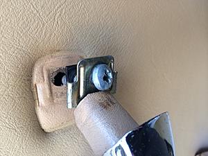

It is a poor design and difficult to remove without damaging the leather on the arm of the door. They were much easier to remove on my XJ6 than my XJS but still difficult. I use a small flat bladed screwdriver. Insert it along the bottom edge of the chrome piece between the chrome and the door panel and twist the screwdriver to release the chrome piece from the clip it holds onto underneath it.
Once it's released it's still usually very tight to pull back far enough to reveal the torx screw head holding the door handle in place. Some people recommend wrapping the leather/vinyl with tape or using leather conditioner as a lubricant to prevent damage while pulling the finisher back.
Make note of the orientation of the clip underneath once you can see it so you put it back correctly. I've tried to attach a photo of one on my XJ6 once the chrome finisher was pulled back. I actually think I have the clip flipped the wrong way here as the 'tangs' of the clip should face outward.

The screw is a pozi, by the by, not a torx. Replacing it with an allen keyed screw helps for the next time, as the cover does not have to be forced back quite to far as with the pozi.
