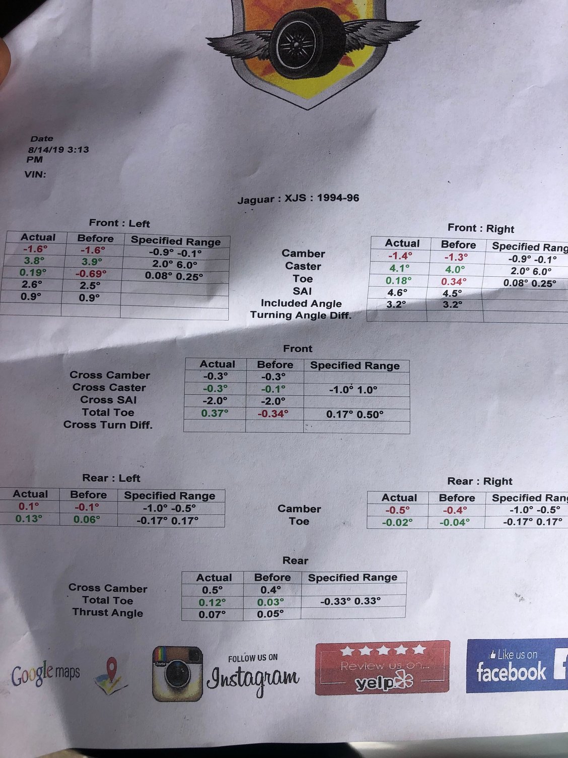

Mark,
I think we're all still guessing at the problem rather than having the full facts.
I presume that after doing the alignment check, they gave you the printout showing the toe, castor and camber setting for each wheel, including the front to rear alignment? If they didn't. I seriously suggest that you go to someone who has a proper Hunter alignment bed or similar and get a proper check and set of printouts. An example of the sort of printout that you should be expecting to see is in attached pic.
The shop doesn't need to be proficient in XJS adjustments. At this stage, you just want to know exactly what is the alignment spec of your car. I really wouldn't be throwing money at springs / shocks etc just because you had some strange wear pattern on your old front tyres.
Good luck
Paul

Originally Posted by ptjs1
Mark,
Good luck
Paul
