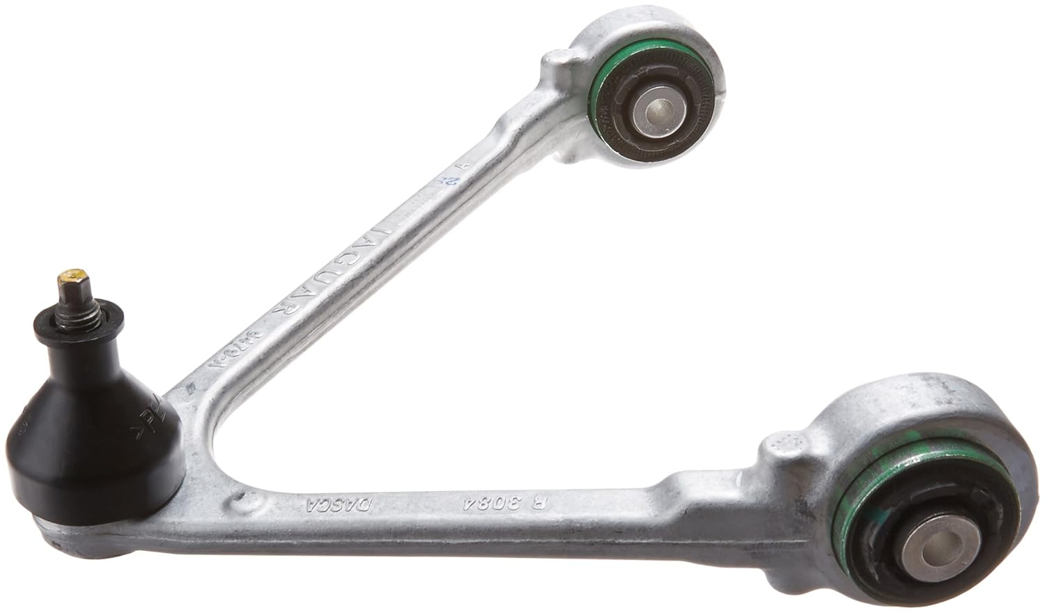

Thanks for the advice all! I can't do work on the car where I'm renting here in south FLA, so I'm gonna have to just buy parts. One question, has anyone had experience with these guys? https://www.carparts.com/details/Jag...J28150004.html - seems like one of those 'too good to be true' scenarios, but I'm tempted to order one just to see what it looks like.
Old Jul 9, 2019 | 10:49 PM
OzXFR's Avatar
Posts: 9,021
Likes: 3,658
Don't know them and never bought anything from them but the part appears legit and for that incredibly low price you don't stand to lose much if it's not right.
Be sure to check the postage cost though in case that is where they make up a heap of the discounted price.
Also it's driver side only, what about the passenger side?

JLR have quite the markup on their replacement parts under their individual SKU's. Here are cross-compatible part numbers for Ford Motorcraft upper control arms:
FRONT
MotorCraft MCSOE38 = 6W4Z3084AA
MotorCraft MCSOE39 = 6W4Z3085AA
REAR
6W4Z5500AB
6W4Z5500AA
These part numbers are an exact match for the suspension components on the X250; they are even stamped with a Jaguar logo! For your reference, here is a link to an Amazon storefront selling one of the front upper arms:
Click here to see the part! Click here to see the part!
Best of luck with your suspension refresh!

Thanks OzXFR! @patrickw813 - the equivalent part number isn’t the same as the part number I have from the mechanic (like C2Z29117). Does MotorCraft MCSOE38 = 6W4Z3084AA = C2Z29117? Thanks, I appreciate looking out!
Old Jul 11, 2019 | 08:24 PM
patrickw813's Avatar
Joined: Dec 2008
Posts: 360
Likes: 105
From: California
MotorCraft MCSOE38 = 6W4Z3084AA = Passenger Side = C2Z29115
MotorCraft MCSOE39 = 6W4Z3085AA = Drivers Side = C2Z29117

Rock Auto and Amazon has the jaguar Version of the Motorcraft Upper arms listed as a 2002 Thunderbird (Share the chassis with the XF) Upper Control Arms
MCSOE38 and MCSOE39 For Aboutn $140
Amazon Upper Control Arms Amazon Upper Control Arms
