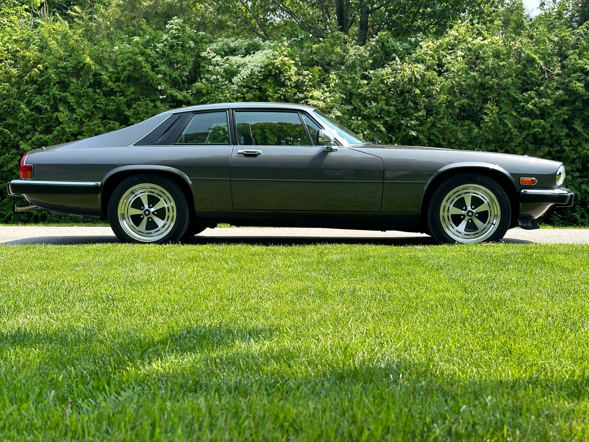

Bilsteins and OEM springs all around in mine.
Firmer than the originals but less floaty which is what I wanted.
Still rides nicely.

Wow. Nice looking car, an d nice straight paint job. Much nicer looking than my POS with its previous owner respray and grungy wheels..

Thanks Doug, paint is original, car had one owner before me. 64k kms on it now.
