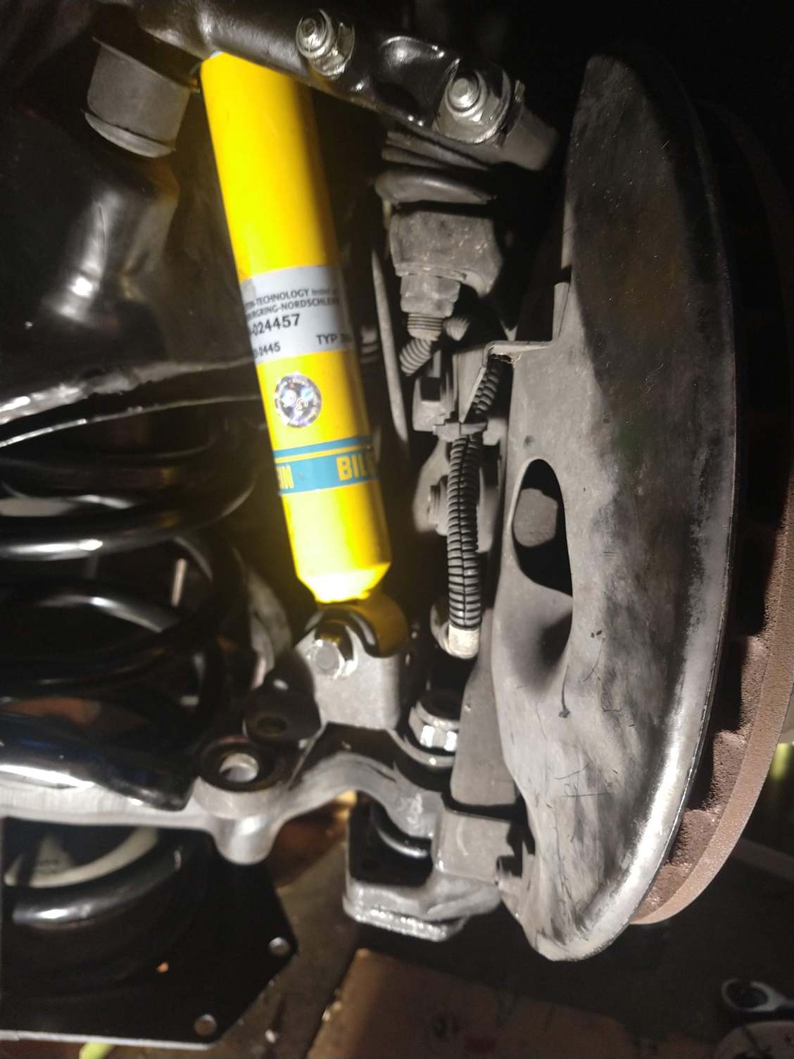

I'm very happy with the Bilsteins on the front of my V12. Much better, IMO, than the KYBs that were there....which may have simply been worn out. I'm not knocking KYBs.

Bilsteins on the front of my 4 litre. I already had them waiting otherwise I might have bought Gaz adjustables which I have on the rear.
In an age where aftermarket spring quality seems so variable compared to the originals, the use of adjustable shocks takes on a greater priority to try and really find the right balance of suspension characteristics that suits you.
