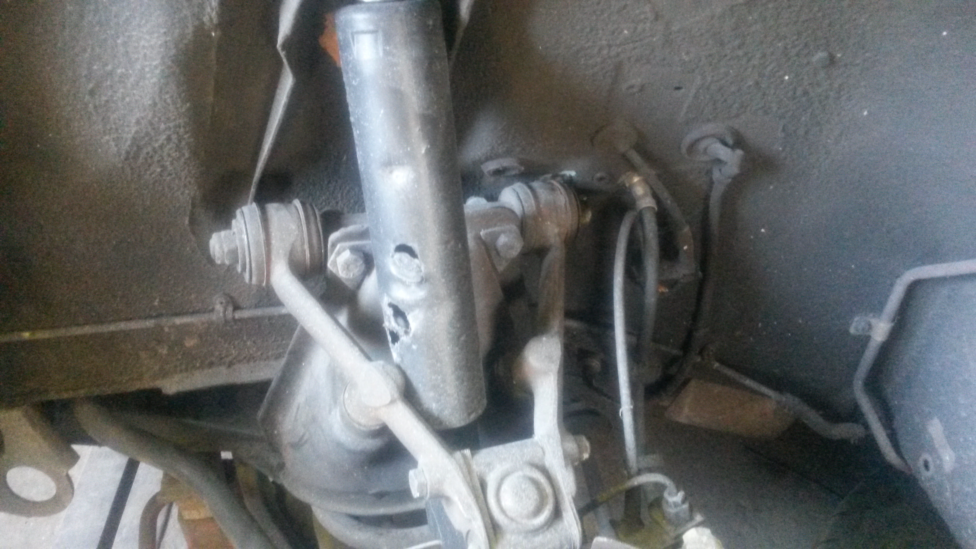

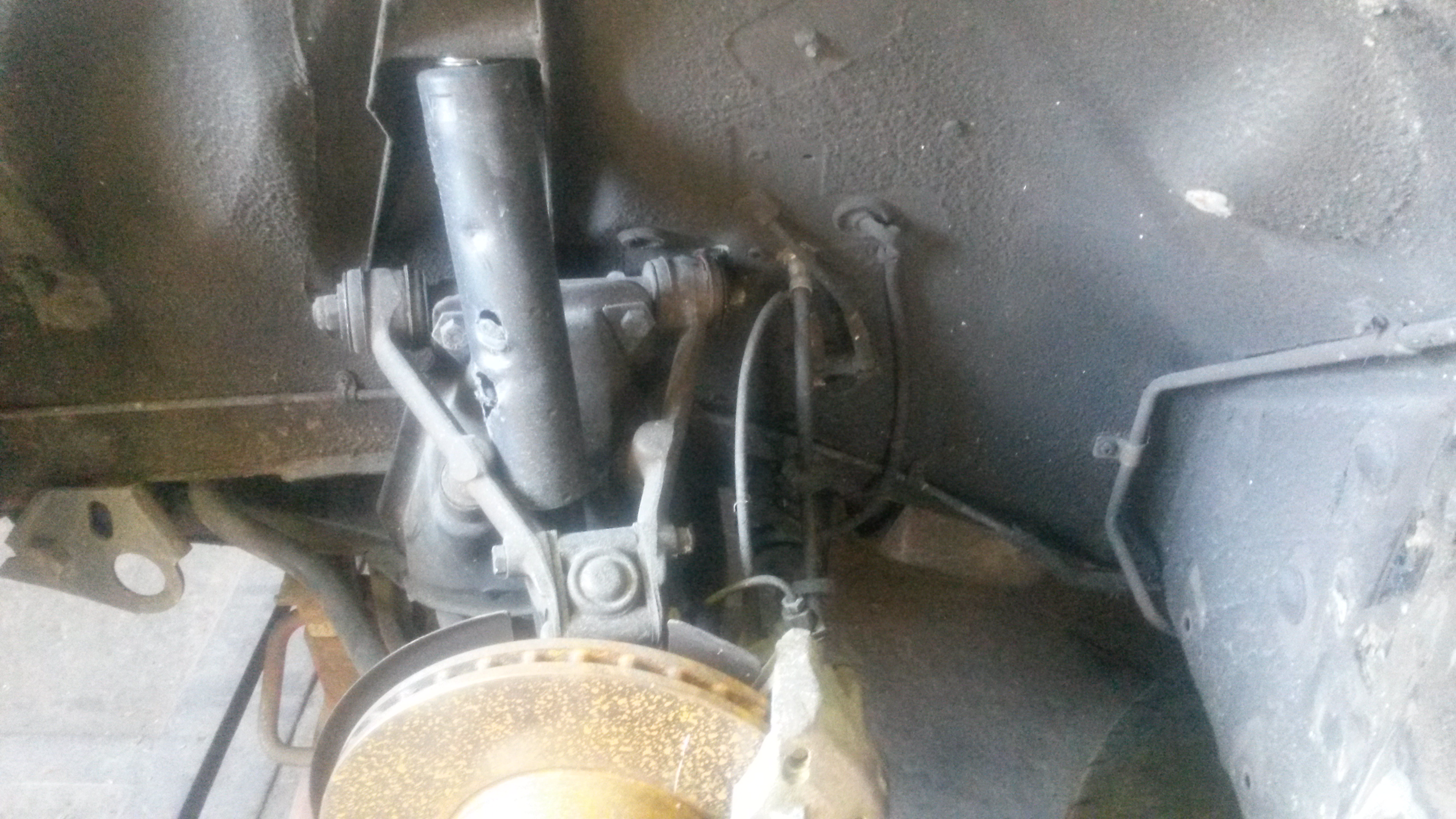

For anyone following along...
Took these at the frame shop yesterday.
It looks like the control arms came out alright. They pushed the subframe in on the rear side. I suppose the wheel shattering took most of the impact.
Of course the new shock with 50 miles on it got pretty bent.

Ouch. Knowing how it should look, that doesn't look good!

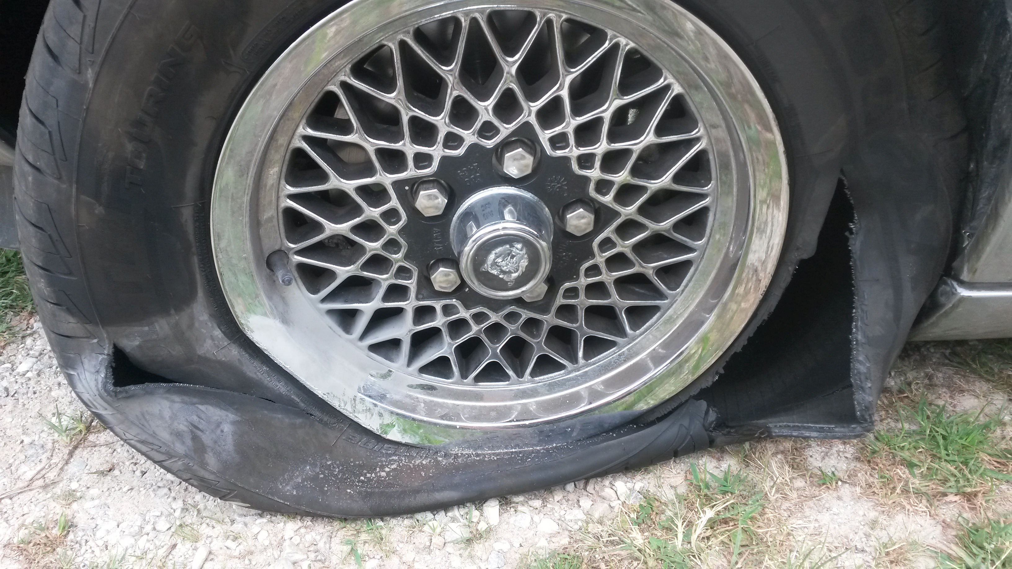

I'm certainly hoping that it's just the upright of the subframe.
This is the wheel (and tire) that took most of the impact.
