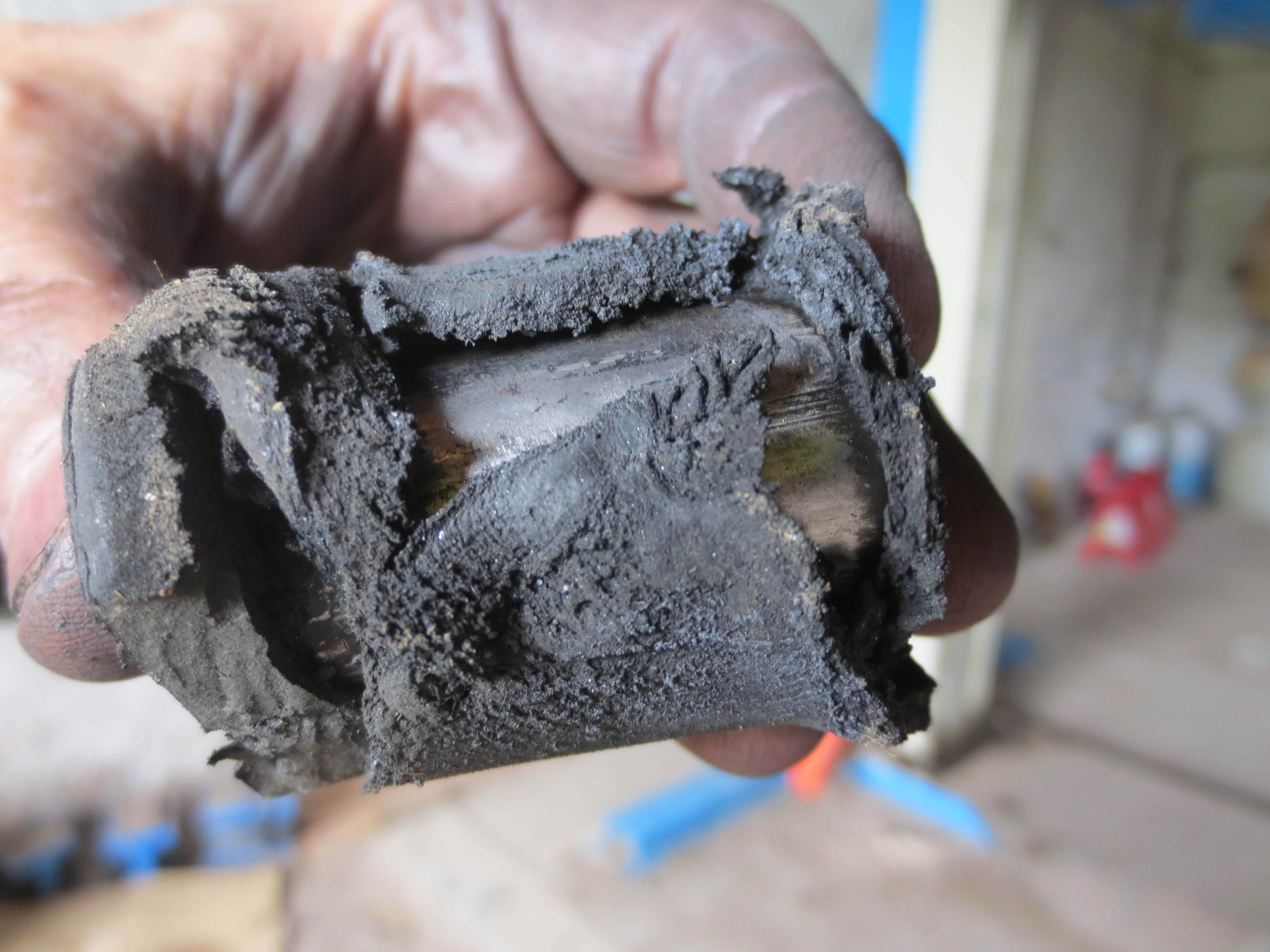

I'll say! Knowing no better I bought some own brand ones from a usually very good aftermarket supplier, and they fell apart in 3000 miles, not just a bit, completely, as the photo shows. Metalastic only. David Manners have them, for example.

That looks melted. I wonder if friction causes heating, as it can't turn freely.

No that is just the rubber material being unable to withstand the forces involved on corners. The bushes do not turn, the rubber is meant to be able to move, (ie give) the few degrees necessary without tearing, squashing out or delaminating.
What is VERY important is to tighten the nut on the pin ONLY when the car is on its wheels, then put in the split pin, so the wishbone is in its normal position.
You're misunderstanding my point. Normal bushes are able to give (shear) to allow rotational movement of the arm. Poly ones are much stiffer, and hence might not shear, but rather might rotate in the outer diameter - creating lots of friction, and heat.
If they weren't rotating, they wouldn't squeek.
I have seen polyurethane get too hot and it looks just like that.

Poly bushes do rotate, in the XJS lower wishbone application about the steel inner, totally agree they are apt to squeak.My collapsed ones were not poly, they were "OEM-style" non-OEM, non-metalastic, parts from a normally reputable supplier.
