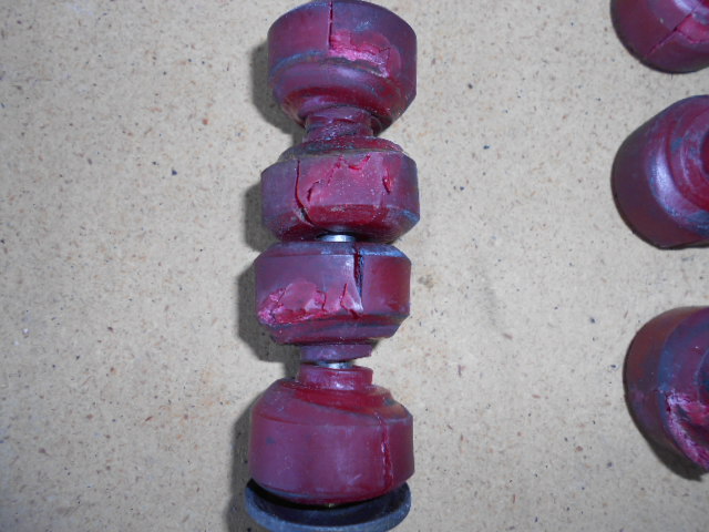

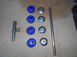

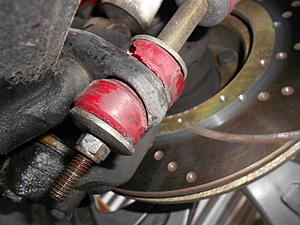

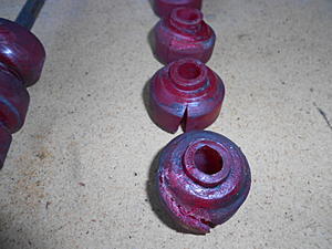

Sadly MOOG packed up their bat and ball and left OZ, so no more MOOG down here.
Jess
A lot of those Moog end link kits are rather generic; no doubt designed to work on many different cars. I've used them on Jags and other cars.
Sometime manufacturers play things a bit fast-n-loose, though. The Moog end link listed for a Datsun 240Z looks just like the one pictured but in that case wouldn't come close to working
DD
DD
