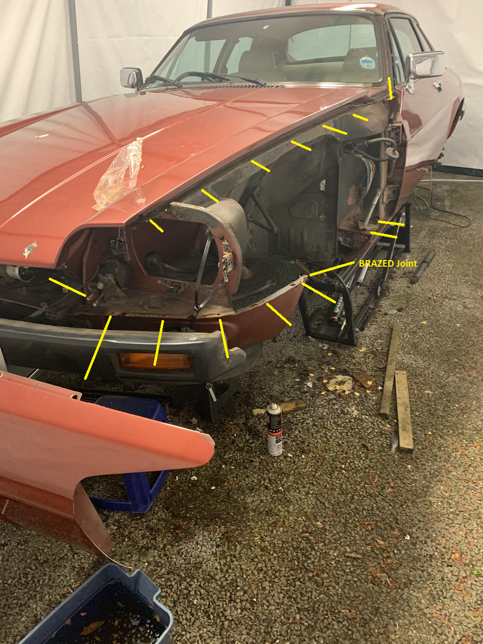

There are and the screws are installed in such a way that straight on access is a nightmare. The yellow lines in this image are my recollection - be careful with the very front the piece under the headlight is also brazed on but there is a small screw that can catch you out - and if you bend this making it look right again will be no fun at all - there is no alternative with the brazed joint but either melting the joint or cutting - either way you will be painting.
This image is from three years ago hence the memory deficiency - there may be one less on the front than I have indicated. The ones at the lower rear can fight you - don't attempt them with anything less than a 6 sided socket - if they round out you are going to be fighting in a really cramped and uncomfortable place - the wing could equally be rotted off here ....

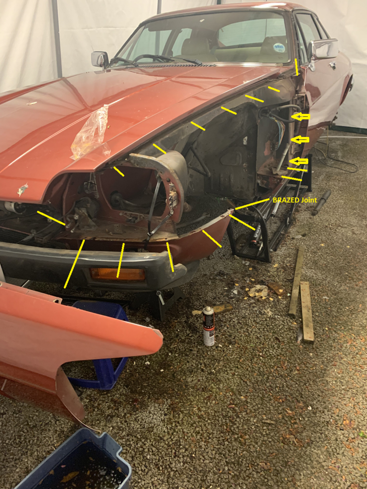

There's 3 more bolts: indicated with arrows on the vertical post that holds the hinges as well. You shouldn't need to get them out completely, they connect to slotted holes in the front wing.
3 more bolts. Accessable after removal of stoneguard
