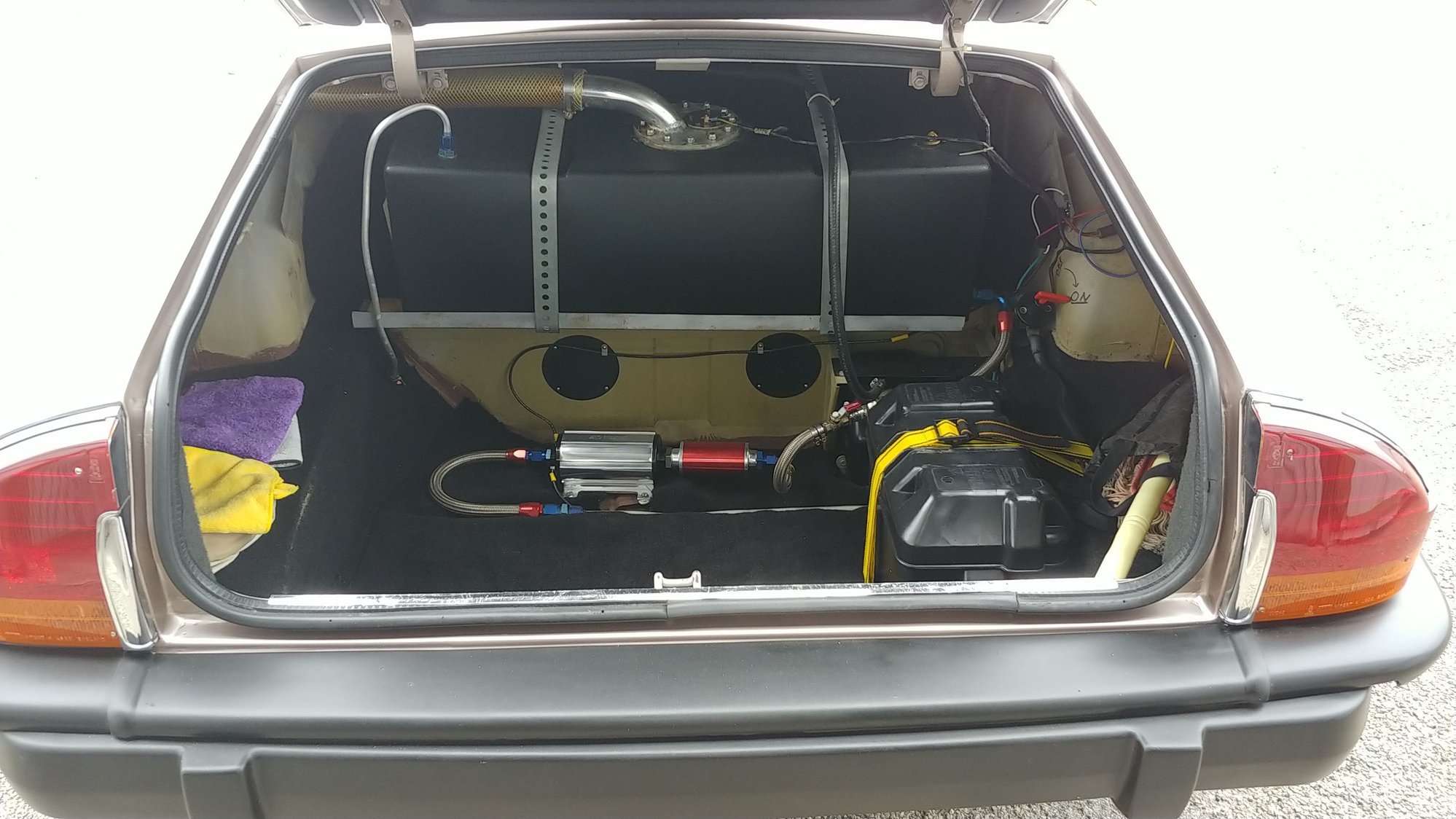

pic of my XJS fuel system, works great , i could not deal with the factory junk!
polyprop, fuel tank, large filter, replaceable element, oversize pump, all aluminum lines and fitting! adjustable FPR, i run constant 42 PSI, Honda injectors(quaulity).
FPR red object, adjust from top , gage connect at front custom rail,! simple and effective
