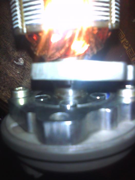

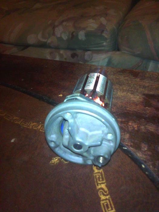

Hose is connected fine. In the most recent attempt I was trying to pump out of a gas can just to verify pump operation. the motor runs but it picks up no fuel.
This is a brand new pump from SNG Barratt just a couple months old and only used a few times for maybe 10 minutes each. It is a different type than pictured in your link. Here's some pics of mine.

I appologize for all the confusion I've caused in regards to this issue. Apparently, checking and double checking the alignment of the impeller was not enough. Upon a third, more thorough, comparison to the old pump, I found that I had the impeller turned 90 degrees off. I'm a jackass.
