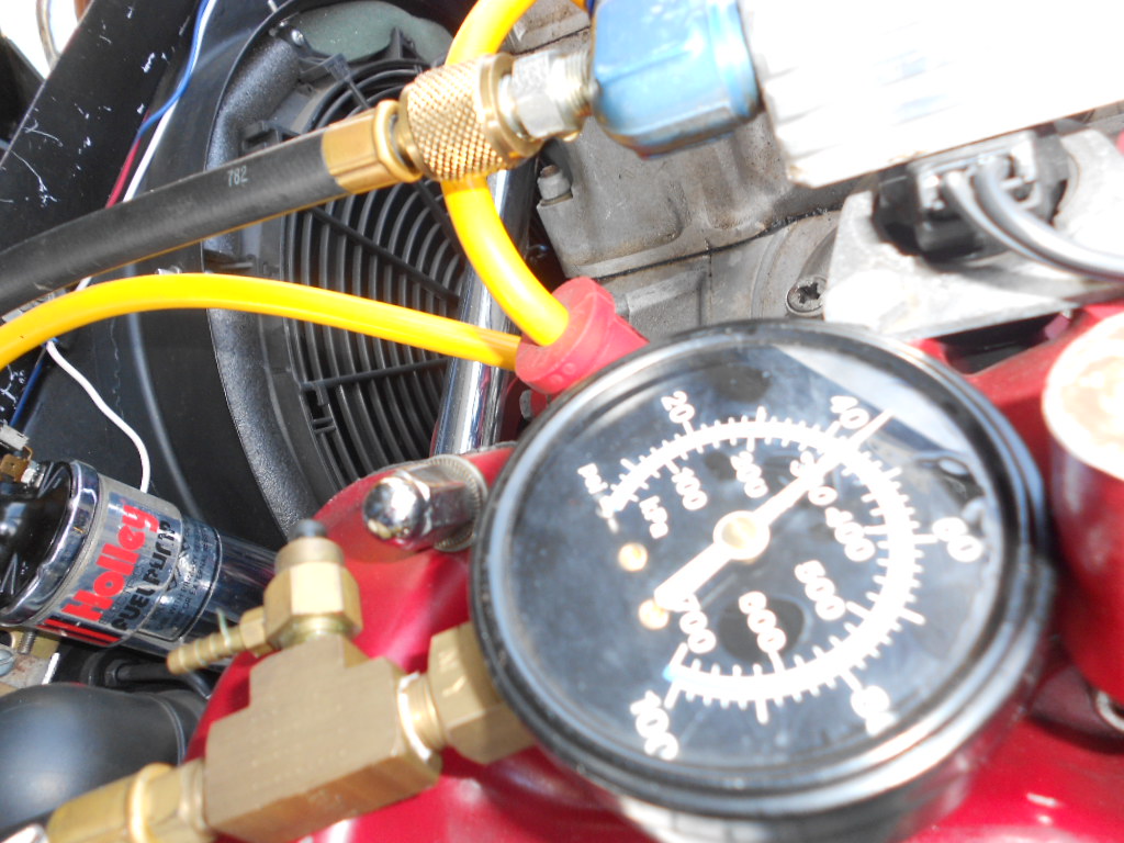

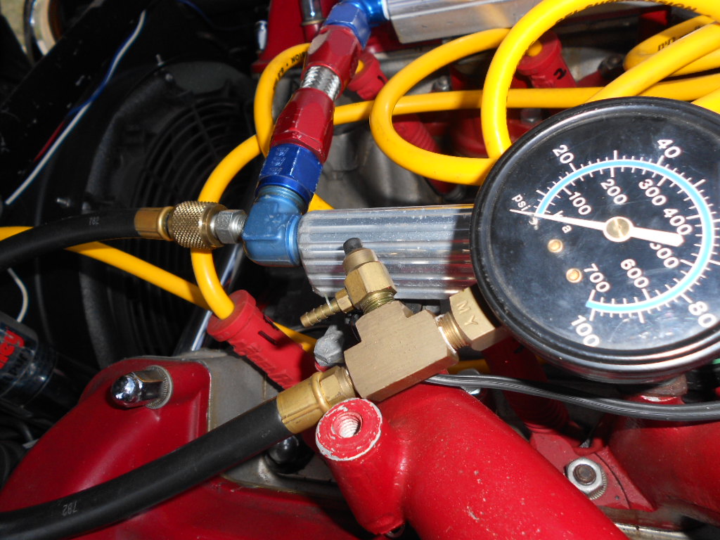

pix of my FP test , one engine off other with engine running.
its at 45psi
also pic of my adjustable FPR.
a quick test only takes me 4 or 5 minutes, good indicator of possible filter restriction!
