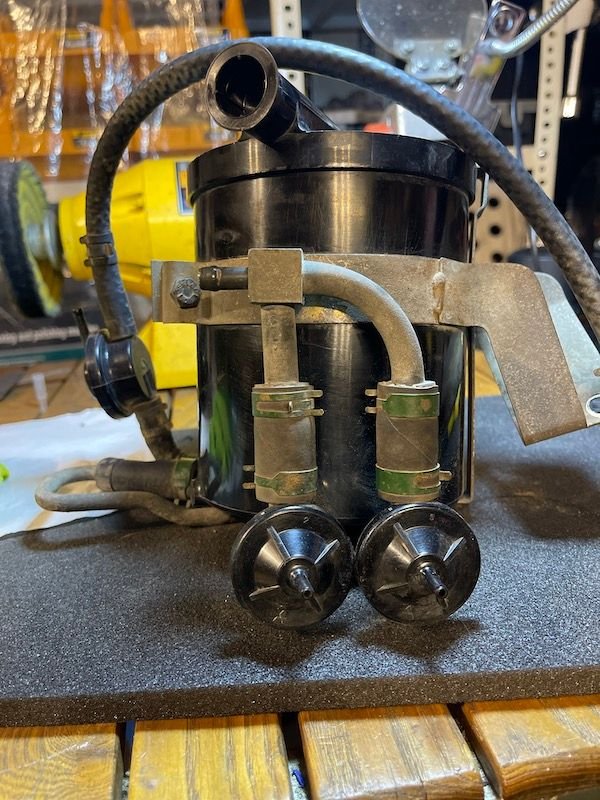

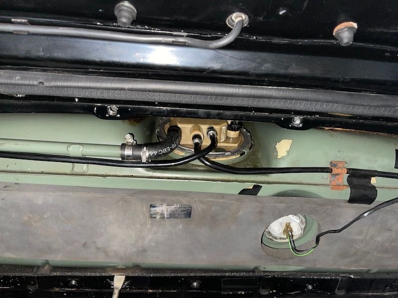

Yes, fuel smell in the trunk and I opened the cover to see the below.
The two thin tubes coming out from the middle are fixed in a way that I can easily shake them. Is this some sort of press fit connector? And how do I pull it out if I need to? Obviously they could send odors out being so loosely fixed, or not?
From what I read so far, I am guessing that one is to relieve out and the other to breathe in, right? So in order to check these lines, all I need is to blow through them and ensure easy air passage?

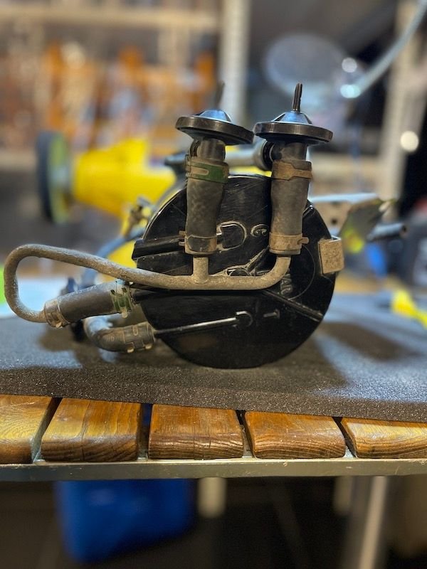

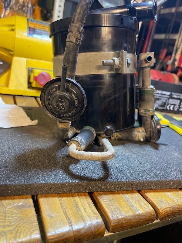

I also read that they end up on certain models (like mine) up in front at the charcoal canister but with most photos or diagrams there were only one small and one lare rochester valve, where as I have 3, photos below. Where do I go from here and how do I check each individual valve?
The canister seems to have a broken (or no) filter on top as when I tip it over, the charcoal pour out easily. I will open it to see whats happening but how do I check or revive the charcoal inside?
Is there a diagram showing how my set up should be like?
One last question, if the rubber seal on top of the tank has shrunk due to age and allowing smell to go from there, is it advisable to put around it some silicone to seal it well instead of removing for replacement?

What year is yours? On my 86 it always smelled of fuel in the trunk/boot. I got a new rochester valve and started to install but in the end I simply removed all that stuff, there is now just a vent to atmosphere (outside the trunk). Car doesnt smell anymore and neither does the garage.

The fuel tank often rusts and splits at the bottom due to faulty design (it sits on a screw or bolt). I had this on my 1982 HE which had zero rust anywhere, but a leaking/split fuel tank

This may be off the wall, but I had a similiar proble. It turned out the sending unit was leaking. Wiggle the sending unit and see if fluid escapes.

In the meantime, of course the charcoal canister and the rochester valves have been removed. I opened the boot and not a smell of gas at all !!
I guess problem solved as indicated nickr76 for which I thank you.
I will tidy the car up, drive it and fill it to the brim and see if it remains smell clean as currently I have about half a tank, and also see if driving it may have a smelling effect.
So, thank you gents for your suggestions and help but looks like this is it.
