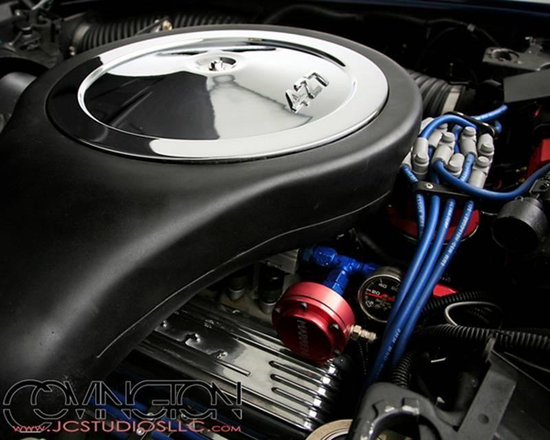

its not hard, I put an internal fuel pump on my EFI converted 1961 corvette.
You need a new tank with a top access plate opening, that opening may very well be standard.
The new tank i bought had pump access hole, and I bought a pump and plate from Summit racing, IIRC. You need an external adjustable fuel pressure regulator, the regulator usually goes on the return line.
It was similar to this:
https://www.summitracing.com/search/...l-pump-modules.
Has ports for fuel out and return fuel.
Doug
