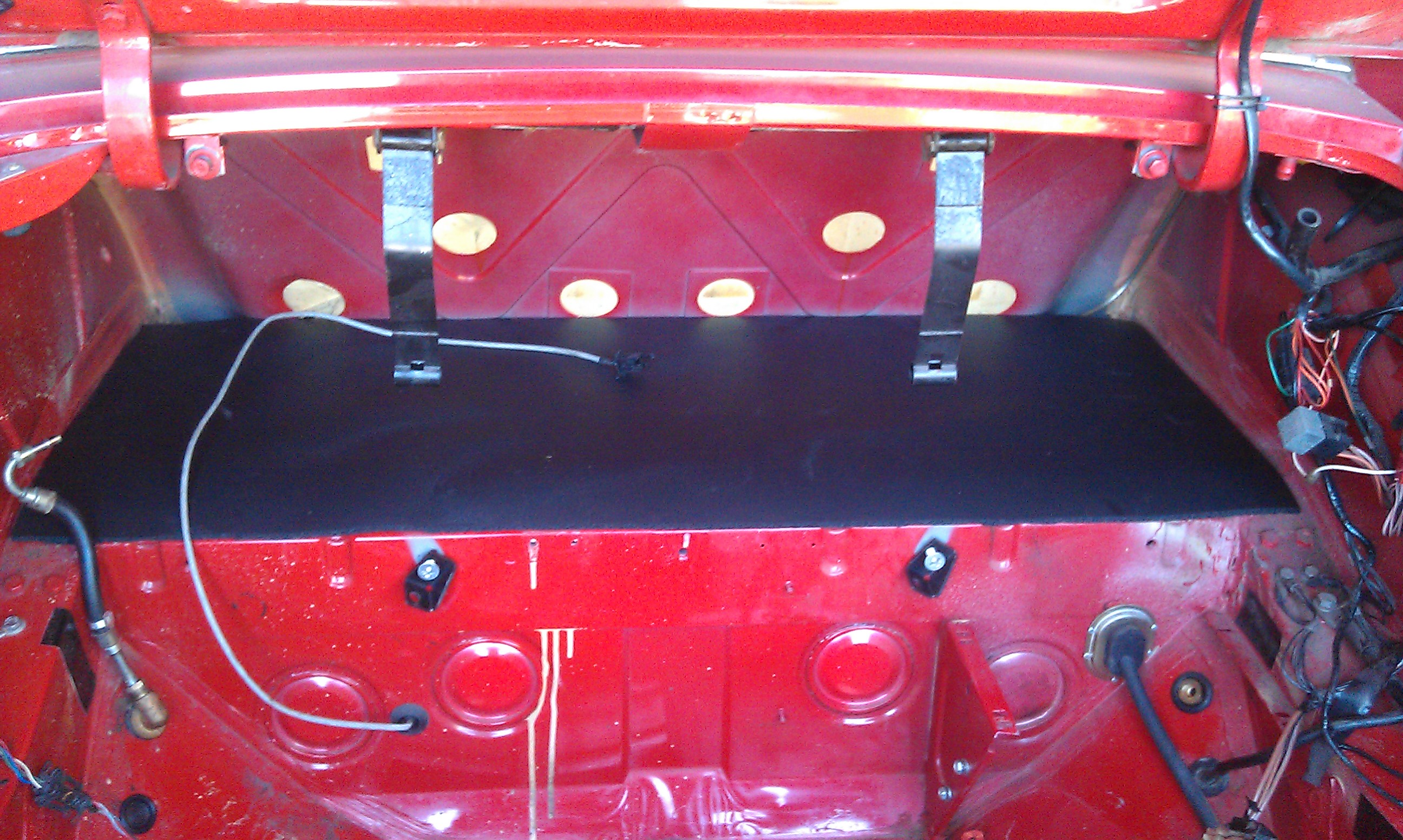

Originally Posted by 944xjs
nice, my buddy works at an industrial supply company so I can get closed cell foam real cheap. Just wondering how thick to get?
I think mine was 8-10mm thick
nice thanks... if I do it myself it's not getting welded. I have zero experience with that. It would be some sort of crappy over the counter kit with POR and whatnot.
1/4 inch (7mm) maximum, I would say, if too thick you have clearance problems above the tank.

Originally Posted by greg in france
1/4 inch (7mm) maximum, i would say, if too thick you have clearance problems above the tank.
Greg
Greg
Interesting. I have ordered and just recieved 1 x 2 meter 8mm closed cell neoprene. I will most likely not install it until after next week though, vacation coming up
Give it a go, Leo, but ensure the top of the tank is not rubbing the bodywork anywhere once it is in.
Greg

Dumb question, but this is a fuel line right above the left rear brake caliper isn't it? Or is it the flexy brake hose people talk about? Looks a bit shiny next to the hose wrap.. wondering if that might be where the "sparks" my buddy saw as he was driving behind me are coming from.
Old Mar 3, 2017 | 01:23 AM
  #33
warrjon's Avatar
Posts: 4,638
Likes: 2,583
From: Vic Australia
That's the hand brake cable
